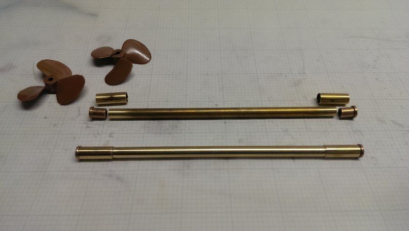

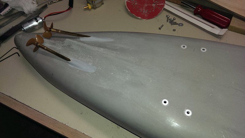

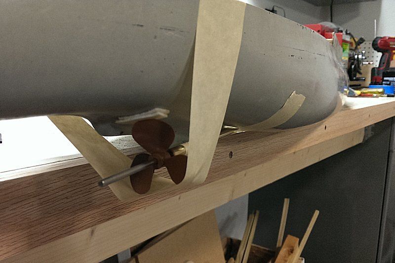

    Stuffing tubes fabricated

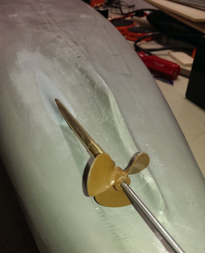

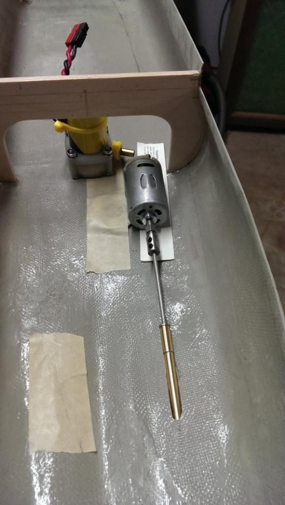

    Fitting to the hull. The vendor advertised these nylon props as 1.5" dia but are actually 1.75. These are probably the same as the Vac-U-Boat props. Debating whether to use them or not.
    Trying these cool compression fittings. Going for a direct drive if I can get the alignment perfect enough. If not, there's room for dog bones.
  2. Lou
    If you need to, cut the hull and make a "pocket" for the motor to get the correct angle.
  3. SteveT44
    No need. Even with the big props the driveline angle is close to zero.

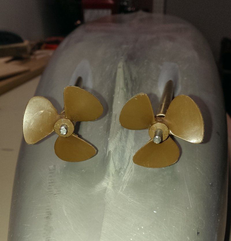

  4. SteveT44

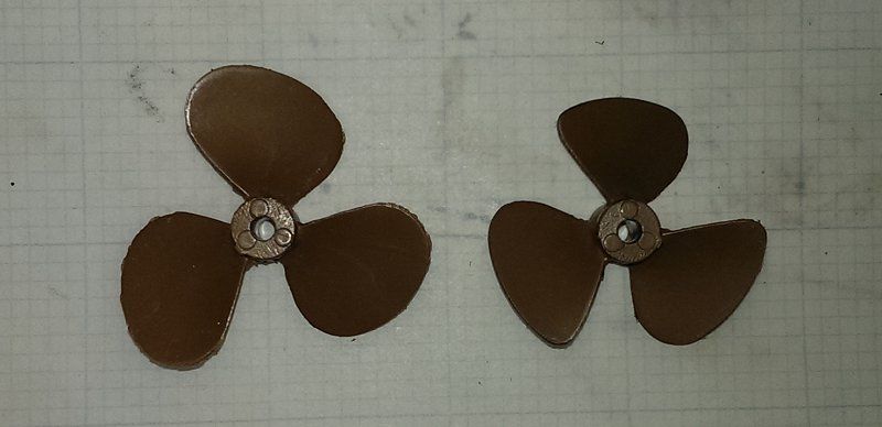

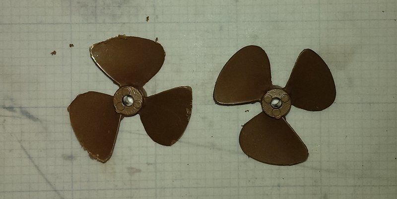

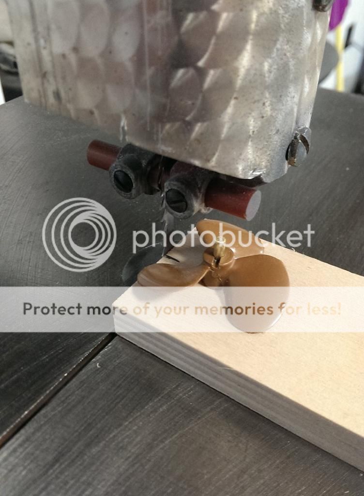

    The props were 1.75" in diameter. I wanted 1.5" so what to do?
    Trim them of course!
    Rough cut and finished.
    Before and after.

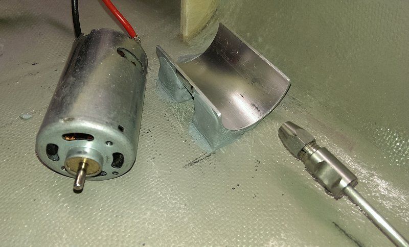

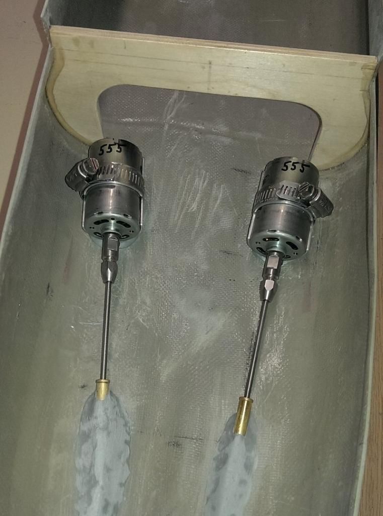

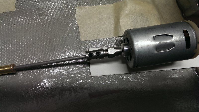

    First shaft gets bonded in.
    And who needs dog bones? Not this Barham!
    Set the shaft, then set the mount plate in a bed of epoxy paste and viola! Perfectly aligned motor. Now to the other side.

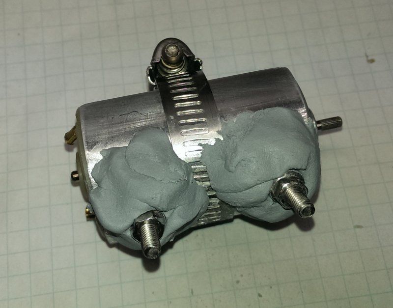

    LOL! Actually I'm not finished with the mounts. I'll be adding flat head screws run from the inside of the curved mount plate through the outside of the hull. Additionally there will be 1/2" of ply water channeling overlaid around the mounts that will add stiffening and support to the area. The epoxy beds are mainly to provide the alignment.
  14. SteveT44
    Carl you've got me thinking. I think I'll get rid of the hose clamp and add a top clamp to hold everything down against the hull snugly.
  15. thegeek
    hose clamp works well but screws are needed, the u clamp is a pain to change motors when you are in a hurry.

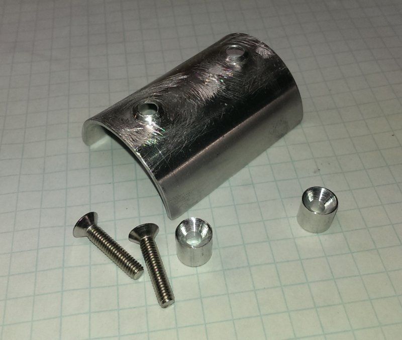

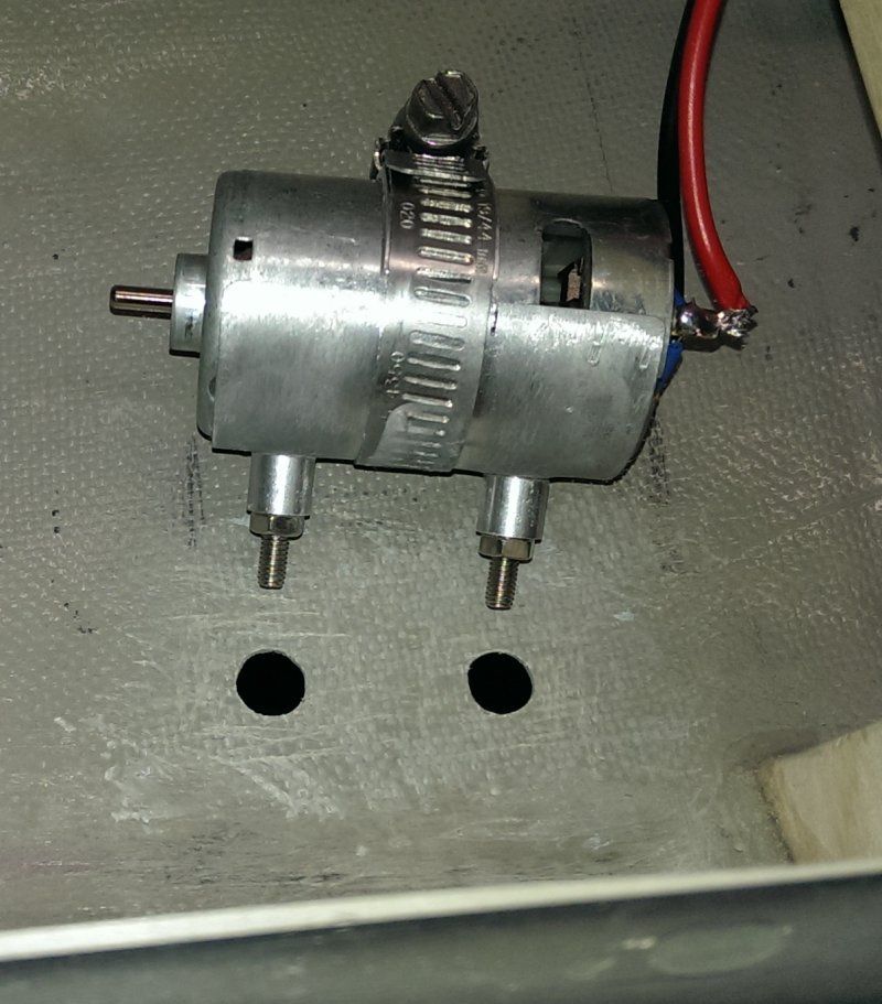

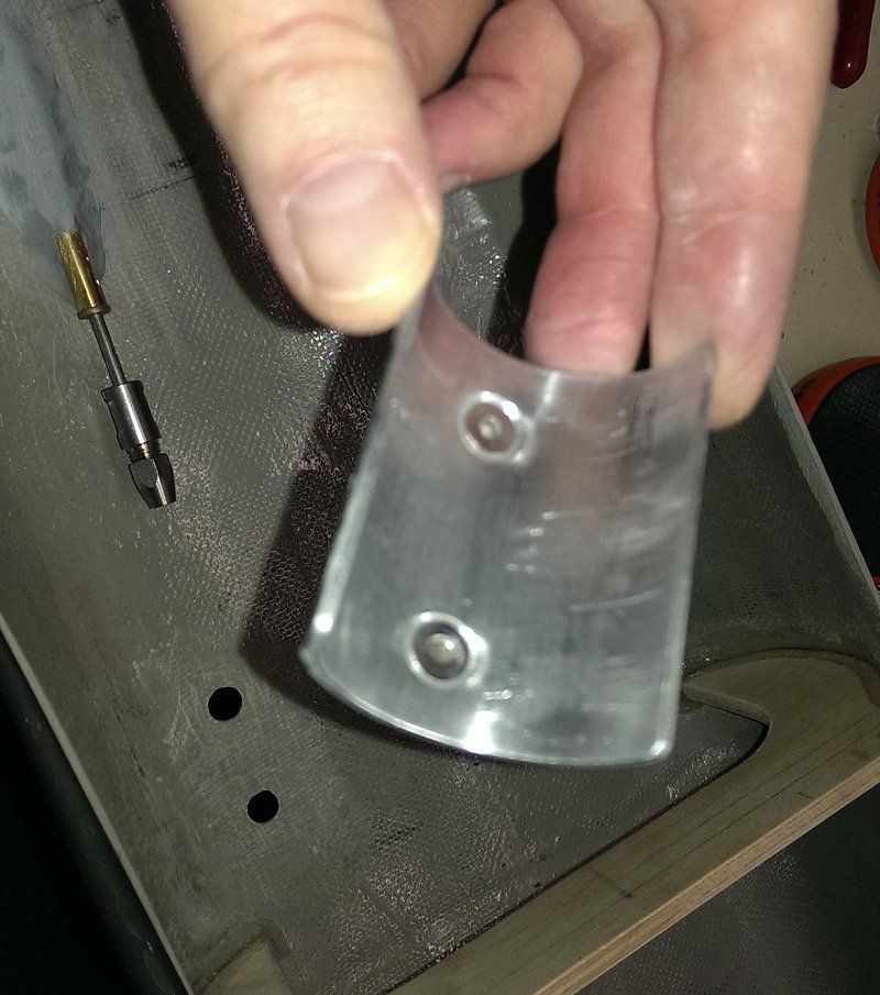

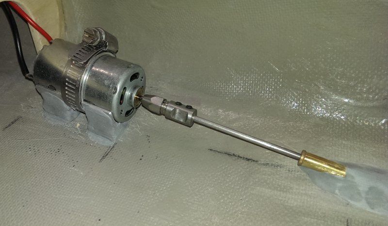

    Decided to upgrade my motor mounts a bit. It'd be a waste to not use the excellent heat conductive properties of the aluminum motor plates so I incorporated some "heat pipes" to pipe heat overboard. The pipes are made from aluminum cable ferrules that have been counter sunk. Matching dimples in the motor plate ensure good metal to metal contact.
    Holes are cut in the hull for the pipes to pass through.
    The 4mm flat head bolts are inset far enough to clear the motor housing.
    Buttered up with epoxy paste for placement into the hull.
    After the epoxy hardens over night the bolts are removed and the heat pipes are cut/filed/sanded to the hull profile. A single large or two smaller 1/6" thick aluminum plate/s will be bolted to the pipes for heat dissipation.
    Two new RS-555PH motors test mounted. When installing the mounts, I was continually adjusting the placement until the shafts turned as freely as possible.
    Props are high and tight!
