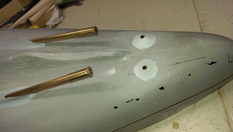

    OK, I've started working on my Barham again. The water channeling is all done and now it's on to the rudder system.
    Lines are drawn inline with the prop shafts and placement and spacing is checked using a 2.25 sq inch rudder template.
    Checking to make sure there's enough space for the top gears.
    So I found this cool nylon gear set at my local hobby shop but how to solidly attach them to the rudder shafts? Simple, using this jig to maintain alignment, heat an 1/8" prop dog with a torch and press it into the gear!
    This block is used to hold the posts in perfect alignment while bonding to the hull. The posts will be cut to length after the bonding process.
    Before bonding, the post height is adjusted to just clear the underside of the future deck...
    ... and then add a little epoxy putty. Note the thick-wall 1/8" ID tubing. Not the typical hobby store stuff. I had this lying around from another project.
    There's not much space in the aft end of a QE. I wanted a compact one piece mount for the servo so came up with what I'm calling the Sidewinder mount. It allows you to slide the servo in from the side and easily engage all gears and keeps wood under the servo screw holes.
    That's it for now. Need to finish up a few bits on the rudder system and then move onto the subdeck and casements.

    Forgot to show off the finished channeling earlier.
    Rudder mount all goo'd up with PL Premium.
    Rudder posts faired to the hull.
    Work starts on the aft subdeck and casement area.
    Careful cutting with a pull saw.
