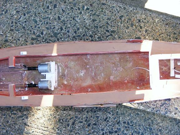

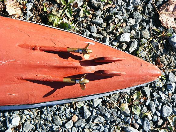

    HMS Dreadnaught initial rebuilding photos from day#1. Only tweaking done so far was removing the driveshafts to sand them, grease them, and re-install to make them spin better. Also moved starboard motor mount forward about 1/16" to allow play in shaft where it was rubbing and stalling.
    The next step will be stripping and re-sheeting the hull to get it ready for float, motor, and rudder control tests. It's only a few days to the Treaty club meet and I hope to have it at least "float worthy" to conduct speed and handling trials, which is why I'm sheeting next instead of carrying on with controls and gunnery.
    I took the photos with my Fuji Finepix S700 camera (7.1 Megapixel) in 4.0 megapizel format, then reduced them to 25% size before posting them. Posting full sized 7mp or 4mp images would have been way too big for the forums, IMHO. I have several other photos but couldn't think of any other angle people might like to see. Please let me know what other "traditional" shots might be welcome. :)

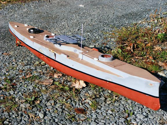

    HMS Dreadnaught, port side profile
    HMS Dreadnaught, starboard side profile

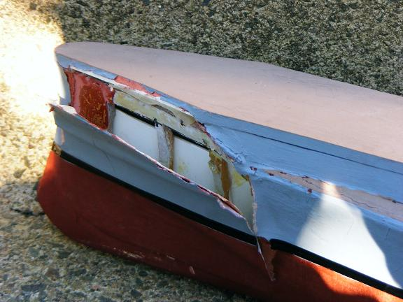

    HMS Dreadnaught showing bow, port side where the sheeting was peeled back for inspection.
    Looked really, really scary and horrible to a newbie at first glance. LOL

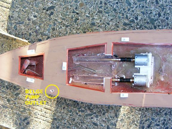

    HMS Dreadnaught, propellers and rudders
    HMS Dreadnaught, engine mounts and rudders
    HMS Dreadnaught, bow spaces and CO2 bottle stowage
    HMS Dreadnaught, centre fuselage space

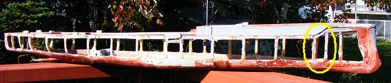

    May I state, for the record, that stripping off old sheeting is a complete, grade-A, major pain-in-the-butt!!!!!
    LOL, already up to 4 minor cuts and scrapes removing the major sheeting. Now I have to clean up the windows and smooth things down so I can re-sheet tonite or tomorrow (latest).
    Editted:

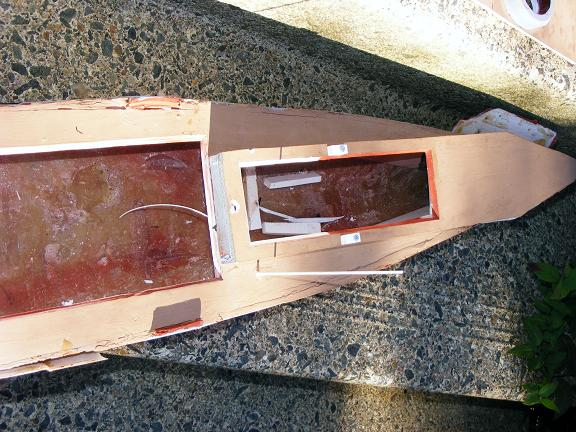

    HMS Dreadnaught all striped and partially cleaned up.
    Note the circle drawn around the 2nd and 3rd rib. It only
    measures 0.8" wide between them so I presume from reading
    the rules I will have to remove one of the ribs to make it
    strictly legal. IT is minimum 1" between ribs, right?
  7. bb26
    I don't think you can move a rib. What is the width of the rib?
  8. GregMcFadden
    Are you measuring from the rib's center to the next center? the full text of the 1" rule is
    Ribs shall not be spaced less than 1" apart measured from their centers
  9. TheMackster
    TheMackster Member
    Sep 11, 2008
    144
    Measured from their CENTERS!
    Doh!
    LOL, I love it when someone points out the obvious to me.
    Remeasured the ribs and they're fine, just over 1" center to center.
    Thanks!

    It looks like you could use the mains for sides. The front one would give you nice down angle, the back would be nasty surprise turret. I would use rubber cement to resheet, you don't have to be perfect to reattach and it is easier than ca. Also when you get to the rebuild, you may want to rething the rudder/prop placement as the turning will be affected by them not being lined up. (unless the ruleset you follow prohibits it)Nice ship and not one you see normally!
  16. bb26
    The dreadnaught actually turns quite well in the set up there. When it turns it turns on a dime. Getting access to the rudder area will be a pain with the small hatch.

    Yeah, already found than out. But now that I have it stripped access is easy. I'm also thinking about cutting a couple of the deck covers larger for better access, most notably the one over the rudder mount like you mentioned.

    I'd imagine with that set up, she holds speed fairly well in a turn as well, as some thrust will continue to propel the ship forward as opposed to 100% of the thrust going into turning the ship.
  19. bb26
    When she did sail she turned very well. Granted it was not at required speed but responded very well in a turn.
