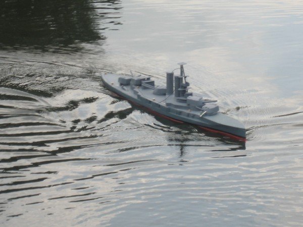

    Construction was started a couple months ago. Today, the ship got it's first water trial and performed brilliantly. So yes, I'll be taking a brand new ship to a national event. But those people that know the little Verite also know that I do well with making new ships reliable.
    The Richelieu will also go to the IRCWCC Nats, this time armed with dual pumps. The Axis might sink the Richelieu, but not before I empty the sidemounts into a tasty Yamato or Bismark! Heh.

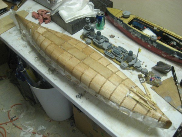

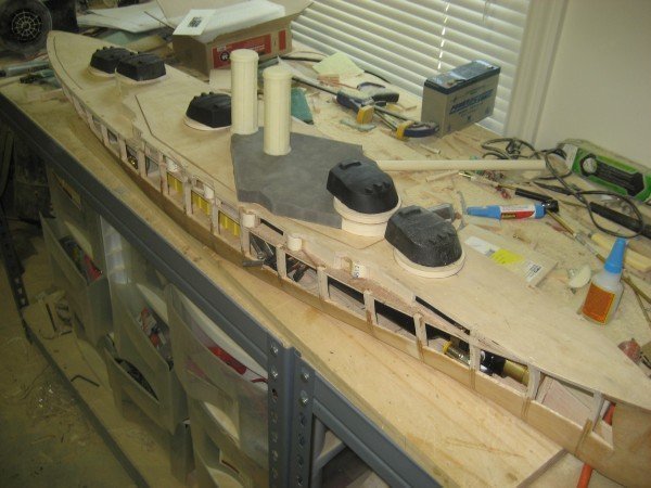

    So, without further blathering, some pictures of the Erin's build. There isn't many pictures, just some key shots.

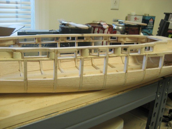

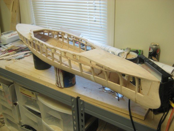

    Basic Hull Frame. Tried and true construction techniques.
  4. bb26
    Sweet. There is something to be said for the wooden hulls.

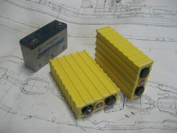

    The batterys are LiFEPo4 chemistry. I found a great deal on 3.3v 40ah cells from a company in California. The cells can handle 80 amps continious draw and upto 120 amps burst draw. Each cell weighs 3.3 pounds, so total battery weight is a mere 6.8 pounds (with wires) for a 6.6volt, 40 amp hour pack. Compared to the 6 volt 36Ah 13lb battery in the Richelieu, that is half the weight with 4 AH more and can take far more durrent draw. This battery pack will last an entire days worth of battling easily.
    Even with the price deal I got, each cell was still $48 each. Also, I had to buy a specialized battery charger for $35 (Hobby King). All up, the total price is a lot more than the SLAs, but if a person wants technology then the price rises.
    The cells sitting next to a 6v 12Ah SLA.
    I bought the cells before really measuring to see if they fit inside the Erin. They fit ... just barely.

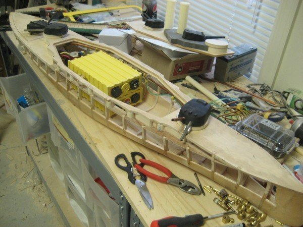

  7. mike5334
    Although the hull is roomy compared to other ships it's size, thigns are tight with the LiFEPo4 battery cells in it!

    The finish work isn't up to my normal standards. After all, I was pressed for time to get it finished in time for Nats. :)
    Mike

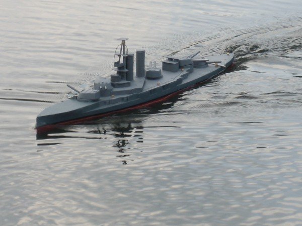

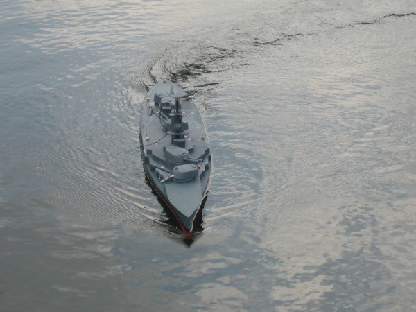

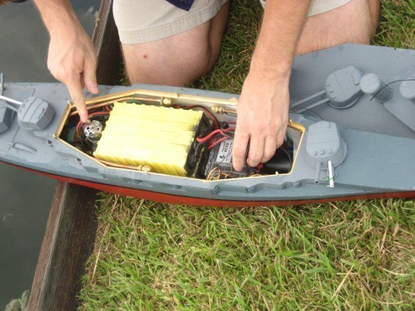

    The Erin finished up at 19 pounds even fully combat loaded after addition of trim ballast. I'm very happy with that. :)
    The drive system is a brushless motor mounted to a BC single motor/dual shaft gearbox. I have a brushless pump ready to drop into it except for having the wrong brushless ESC for the voltage. So for the moment, the tried and true Titan motored BC pump will handle damage control until I can pick up a new brushless ESC.
    The cannons ... well ... my goal upon joining the hobby was to make a set of cannons that would shoot as fast as I can hit the button while not skipping shots or loosing power (air pressure). The Erin's cannons are 95% there. They hit hard, shoot as fast as I can mash the button, and don't loose power no matter how fast they shoot. The only thing I don't like is the Foster style breeches I used. I forgot why I stopped using Foster breeches a couple years back ... then remembered the first time I tried to tweak them in the Erin. They are VERY sensitive to the tweak nut! Chances are, the breeches will get changed out after Nats.
    So, that is the great reveal so to speak. The Allies will get a maneuverable slugger ship to go along with all of those NC and Sodaks. Hopefully, the Erin will be everything I hope it will be.
