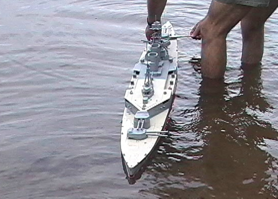

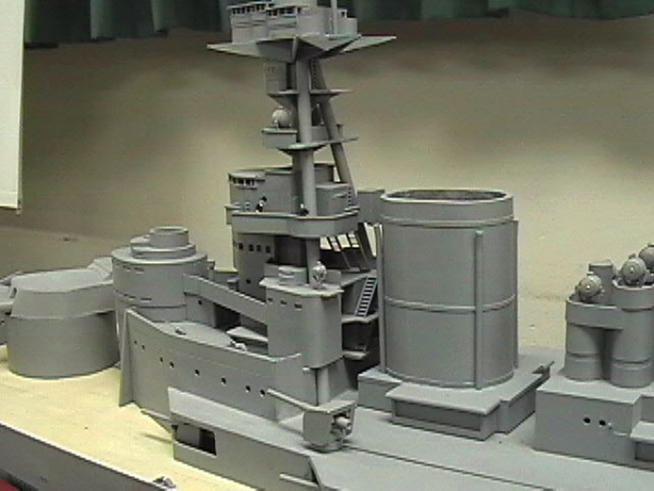

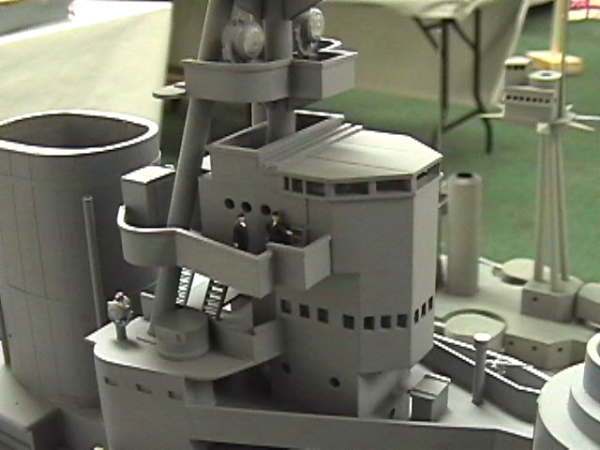

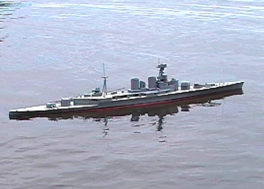

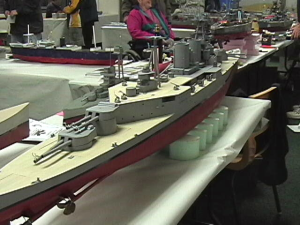

    I have a couple....
  11. BoomerBoy17
    All i can say is "WOW"
  12. Bob Pottle
    Thanks for posting the pics Rob. After the effort that went into making it an accurate model I regret selling it so cheaply - should have kept it for my office.
