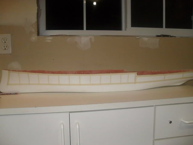

    Here a pic of the layout of my ribs.
    The first eleven ribs from the bow to the stepdeck are spaced two inches apart. I had split the three inch difference between the eleventh rib, and the 3/8 rib at the stepdeck with a rib at inch 1/2 from each. The two aft of the stepdeck are spaced five inches from each other, but the first rib aft of the stepdeck is spaced at six and 5/8 inches from the stepdeck, and the last is spaced 5 and 3/4 from the stern. Any input would be greatly appreciated. Thanks. Joshua

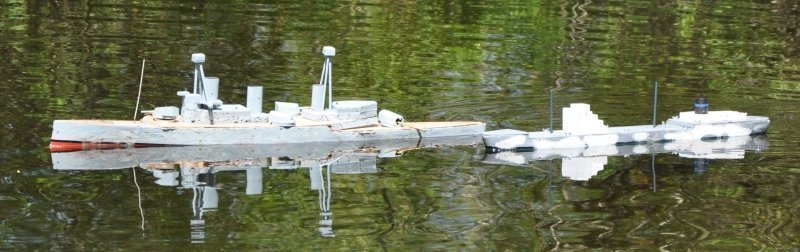

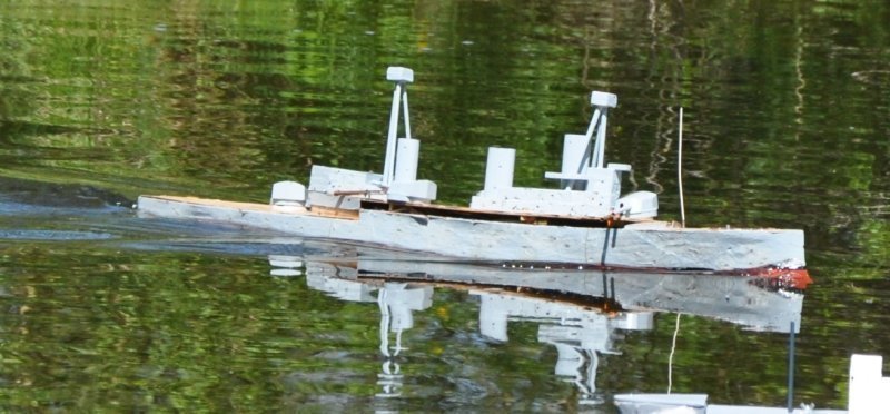

    For a visual reference of tasty area vs waterline...
    You can see that there is a whole lot more meat up front where a high shot can still inflict damage.
    Here you can see that at speed the trough opens up a bit along the midsection and there is even less meat in the stern.

    Is that the HMS Invincible?! I see what you are saying. I just got the other side of my ship marked, and both sides are VERY even to each other. Should I post some pics for you guys to see before I do any drilling and cutting? Or do I go ahead and start? Also what size drill bit should I use? 11/64? Or 5/32? Thanks!! Joshua
  12. Bob
    That is Invincible. If you did both sides as in your photo you look good to start drilling. I use a 1/4" bit, anything around that size is fine. The holes are mostly there to keep you from over cutting through a rib.
    Useing a drill press for this is easier than a hand drill, if you have one.
    In the photos note the gun set up, Stern sidemount to port, stern gun on the starboard offset turret and bow sidemount to starboard. This the normal and best way to set up this ship.

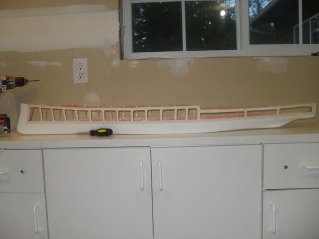

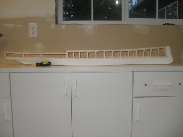

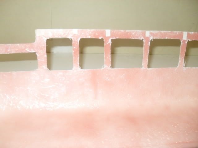

    Take a look:D.
    I did have a few mess ups.

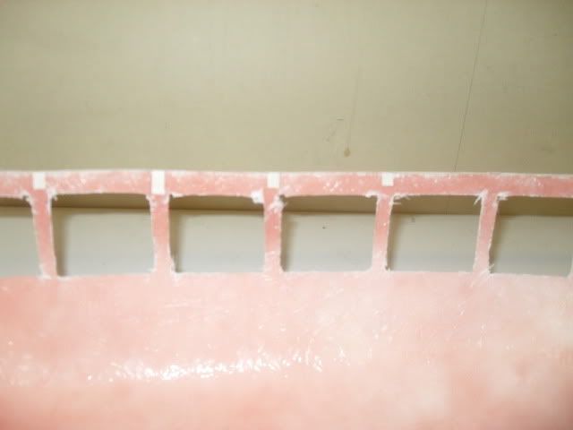

    That's before I sand them though. It was a lot easier and quicker to cut the hull then I thought. With the bit that I had, all I had to do was keep it under control, and let it do all the cutting.

    Looks good. I'll have to send these photos to Gascan at boot camp. I'm sure he'd be interested. Is there a particular reason you cut the windows before installing the sub-deck, or was that just the step you chose to do first?

    I didn't think about doing the sub deck first. Is it a bad thing that I didn't?? I was just following the instructions that came with the ship.
  20. mike5334
    It isn't a bad thing to cut the windows before the sub deck is installed. Just personal builder's preference. :)
