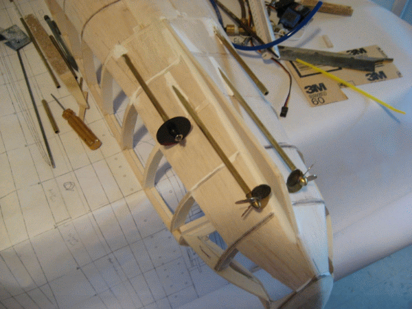

  4. mike5334
    Two right or left handed props? That might do it. If the ship has a left and right handed prop, then maybe both shafts are turning in the same direction, thus making one prop thrust backwards while the other thrust forward.
    The other possible effect is the rudder isn't turning one direction while on the water.
  5. marsman1993
    marsman1993 Member
    96
    How can you tell if a prop is a left or a right handed prop? That could be the problem because I just checked and both props spin towards each other. The prop on the left spins clockwise, and the prop on the right spins counter clockwise. Is that how they are suppose to spin? The problem is being caused either by the shafts, or the props, because the rudders are turning correctly and they don't move when under pressure.
  6. mike5334
    Sounds like both shafts are spinning in the correct directions. :)
    The props in the pictures are left and right hand props. The blade angles between each prop are opposite of the other prop.
  7. NickMyers
    Does she turn right if you're _not_ hard over on the rudder? Sometimes when you gear rudders you have to reduce the throw on the servo so that you don't turn the rudders too far - in my experience 60 degrees is really all you need, much more and water likes to go the wrong way.
  8. Bob
    You could be over loading the servo. With class 4 props the surface are should not be high enough to overload a servo. But your gear system might be binding. The gears could have a slight tilt so they work in one direction but bind up in the other. Or you might have too tight of a system.
    To test these problems take the arm off the servo, if everything moves freely and smooth your system is not too tight.
    Turn the ship on and move the rudders out of the water. Unplug the motors so you don't turn them on and get your hand in the props. Turn the props from side to side. They should get full throw. Now at full through put pressure on the servos as if the props were pushing water against them. You can also put your ship in the tub without the desks to see what is happening.
