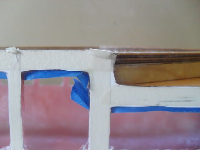

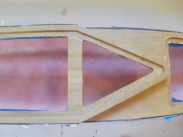

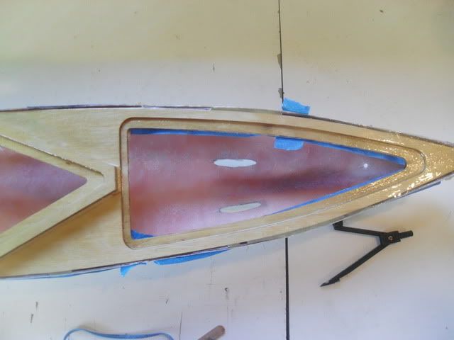

    I epoxied the subdeck in last night, and found that I didn't put nearly enough epoxy in and had a bunch of cracks left to fill. To do that, I taped up the inside and used a syringe to pump the epoxy in the cracks and used the overflow to help with waterproofing the rest of the subdeck. @ Ron Hunt, is this the area you were talking about?
    At the caprail above and bellow the step?

    Ron: That's awesome. But yes, as a fellow step-deck ship battler, it seems that area takes an inordinate amount of beating. I suspect it's because the Sidemounts are right there. Definately make it beefy, be a bad day to have a large chunk shot off as water will find its way down there quickly. Good progress so far!

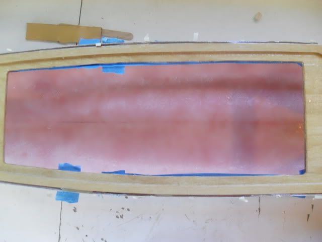

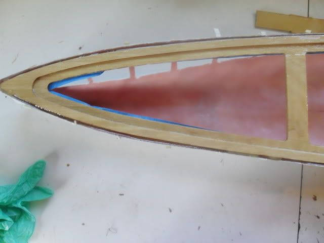

    One side of my main decks have been waterproofed and are now dry. But I noticed that they are pretty light in color. When I compare both the subdeck to the the main deck, they don't seem to match. The subdeck is darker than the deck. Although the subdeck is not quite dry yet. I used West System's epoxy to waterproof them. Is it normal to have shiny whitish decks? Also, am I suppose to sand them down a little to get rid of the bumps? Or do I just leave them as is?
  5. NickMyers
    I sand the bumps out more or less. As long as its not on a surface that needs to mate with another, its not a big deal. Just how much you care about the look of it.

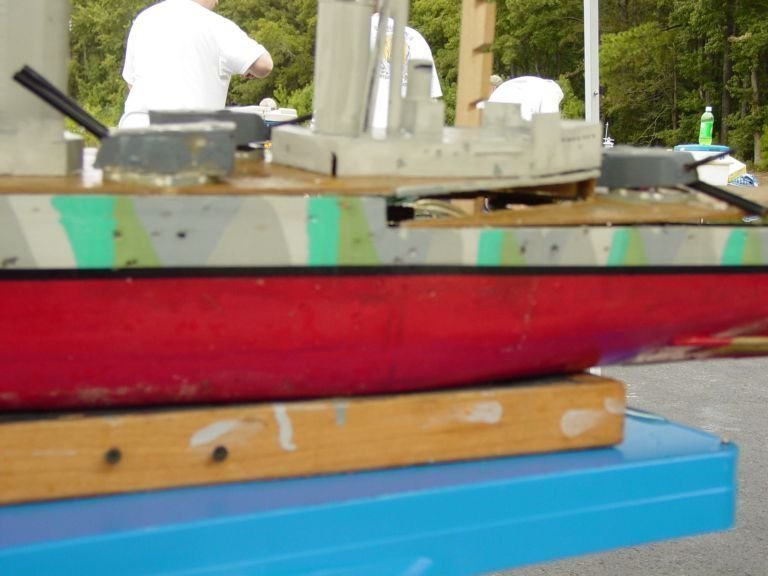

    The missing section is where I was talking about reinforcement. I typically had that piece of the deck shot away about once a year. Picture is from the Wilmington, NC battle in 2003.
    I have since replaced that area with a piece of foam floormat.

    It is not the wood that failed from bb impacts, it is the epoxy joint. I tried several times to brace the area and even rebuilt the decks a couple of times but it kept failing. Cutting board would force you to use something other than epoxy to glue it in place, like either a mechanical fastner (screw or rivet) or goop. Goop has pretty good impact resistance. On my latest build I have been using a combination of rivets and goop.

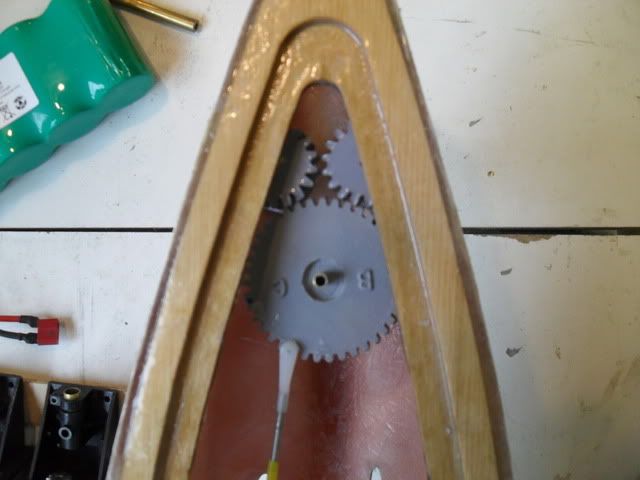

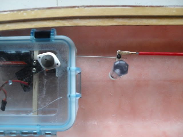

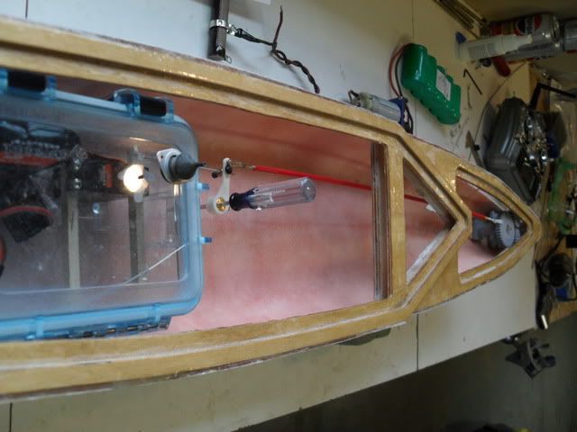

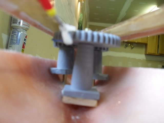

    As you can see, I'm using gears for the rudders. The problem I've run into is, how do I set the servo arm up to where it turns the servo gear all the way left and right without having a second servo arm? I can get it to move almost all the way one direction, but try to go the other way and it returns to it's original spot. I thought about just mounting the servo gear on the servo, but I don't have any wood to make a rudder box. Any suggestions?
  12. NickMyers
    1) ditch the flexible linkage
    2) move the servo out of the box and dont worry about making it a watertight box, just prep the servo to get wet. If memory serves right there are several threads about waterproofing servos here.

    I could rip the waterproof servo outa my rc car and call it good...YUP thats what I'll do!!!

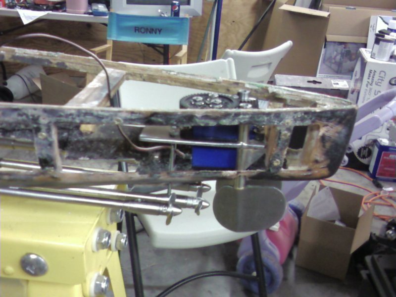

    This shows how I did mine.

  16. Kotori87
    Well Josh, I'm not quite sure I understand what's going on. Is your connector rod flexing? Is it not giving enough throw? Is it bottoming out against the water-resistant box?
    one thing to consider would be to have your rudder servo closer to your rudders. That would eliminate a lot of the connector-rod flex that may be causing your problem, and getting out of the WTB would prevent WTB-related issues like bottoming or throw limits. Another possibility would be to use two connector rods, for a push-pull link to your rudders. One connector pushes and the other pulls when going left, and the former pulls while the later pushes when going right.
