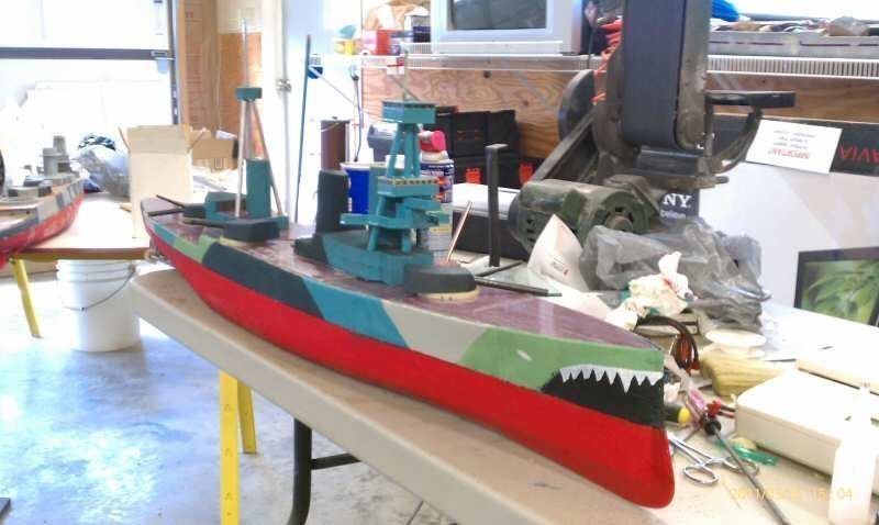

    Could someone post some pics of HMS Invincible's superstructure? I have no problem in placing the main superstructure blocks, smock stacks, Or turrets. But I can't seem to figure out where the smaller foam blocks and secondary turrets go.
  16. NickMyers
    Our local Invincible doesn't seem to have secondaries. I'm looking for a decent picture that shows her super though in hope that it may help you with your other blocks.
    Can you post a picture of what you have so far vs remaining and maybe we can cook up some answers?

    If you paint shark teeth on your Invincible nobody notices the superstructure. Just saying...:woot:
    I don't know how much detail came with your kit but this picture might help. There is a ton of variation in the line drawings for the I-class, since they were experimental ships they went through a lot of modification. I wouldn't worry about getting it that close.
