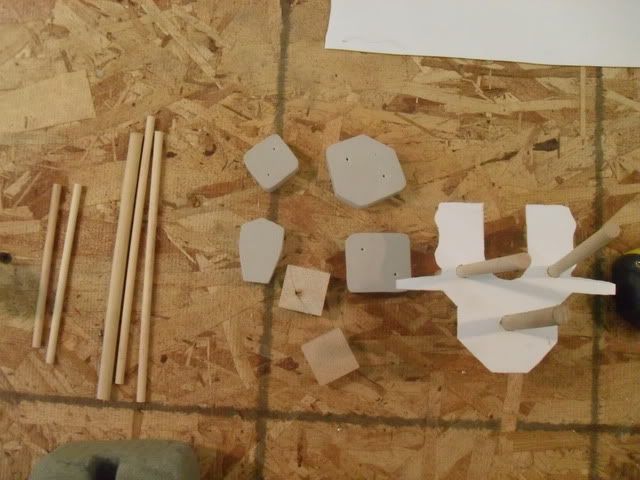

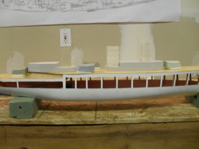

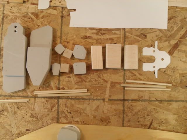

    SHARK TEETH?!?! Thats really cool:cool:. I tacked everything with a little CA glue. I put the fore tripod in the wrong stop the first time, so I have an extra hole that needs fixin. What I'm having problems with is figuring out where the smaller foam and balsa blocks go. Do the balsa blocks go on the top of the tripods? Or is that where the two smaller foam blocks go? Or do the square foam blocks go up there? Will I ever stop asking questions?? Find out next time, on the next episode of...:p

    Lookign at this, Im thinking your remaining pieces are for the forward SS levels 3 and 4, and the top pieces for the tripod masts. I would think the square foam blocks would be the tripod tops, but I could see the balsa pieces being there too, maybe they're redundant? I really don't see a place on the ship for 4 similar sized square blocks.
    Have you tried emailing Stephen and asking him about it (assuming you got the kit from him)?

    I have emailed Stephen and he sent me a few pics of other Invincible ships. They show pretty much where everything goes. All accept for one of the 1x1 inch balsa blocks. Which isn't a big deal. It's not going to battle ready for a little while. At this time I have all that is needed to turn my ship into a working model. Battery, hardware, and controller. I am just aiming to get it out on the water and go from there:).

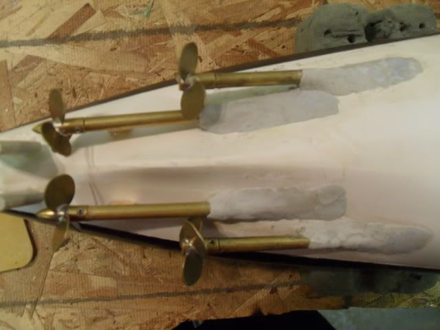

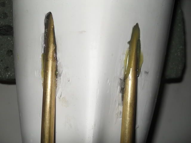

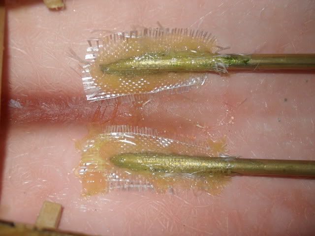

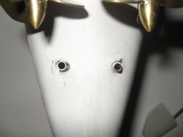

    How do I go about cleaning up the area where the stuffing tubes and rudder post come out off the hull? Do I epoxy some fiberglass cloth over it? And to waterproof the battery, could I coat it with some Plasti Dip instead of Scotch Coat? I'd much rather spend 10 dollers for the Plasti Dip as a pose to 25 for some Scotch Coat.

    The answer to question 1: putty and paint. I use wood filler on my ships, because I mostly build wooden ships. Apply wood filler, sand smooth, repeat until desired shape/finish is achieved. Other people use bondo or sandable epoxy. Lots of choices there, but the basic idea is the same.
    The answer to question 2: THERE IS NO SUBSTITUTE FOR SKOTCHKOTE. Warship skippers have been trying various surface-coat solutions to protect electronics for years, and the only one that has proven reliable is skotchkote. You get what you pay for, and if you buy the cheap stuff it'll cost more in the long run because you'll be replacing your electronics soon enough. Buy skotchkote, and your electronics will outlast than the energizer bunny. To give you an idea, I coated an old 8-channel Futaba receiver in skotchkote when the stuff was first discovered several years ago. That receiver has been sunk dozens of times and still works as good as the day it was made. Just let the water drain out, and it fires right back up. Same thing with the other receivers I coated in Skotchkote. All my other old receivers died from water damage and got replaced. And the replacements got painted with skotchkote.

    for the stuffing-tube / hull area, i use the a clay-like epoxy thing, comes in a tube, you slice off what you need and mash it up in your hand and then form it into place. its fileable, sandable and bonds well. Shoudl be able to find it in the glue / 5 minute epoxy area of your local hardware store. Works great for building up those areas.

    Unless you're in love with power switches, dont put one in at all. Plugging the battery in should be your "switch." Here's a couple reasons: switches can corrode, causing nasty surprises. Switches, no matter how you hide them, can be shot and damaged, or most hilarious of all, shot "off." While not likely, it has happened before. I also noticed your windows aren't cut deep enough. Even at max weight there's no way you have a full 1" below the waterline that is penetrable. Although it may be possible in other rule sets there is a different standard of penetrablity. I suggest West-Systems epoxy. It's totally waterproof, mixes easy (pumps pre-portion, it's awesome), and is relatively cheap and easy to find. It's used to repair full size boats and I figure something designed for water applications should do the trick for our boats too. :) Hope that's helpful!

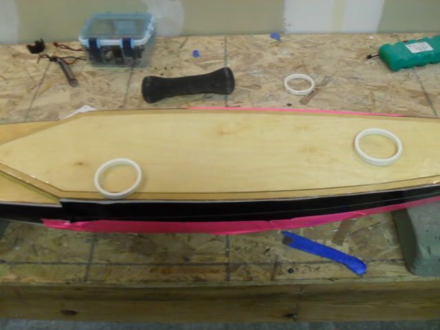

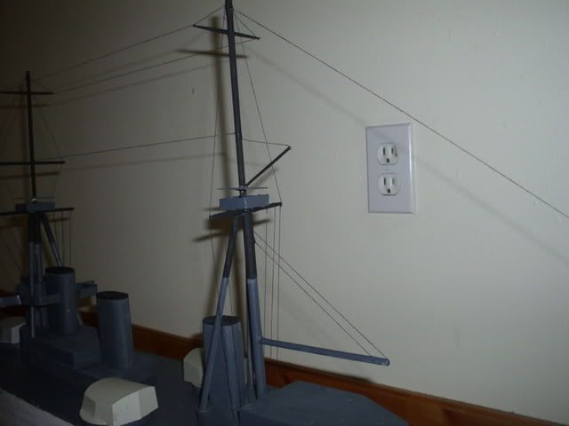

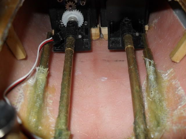

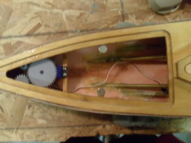

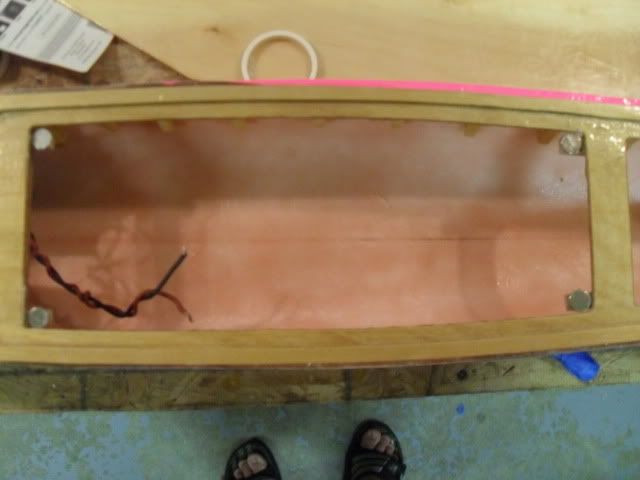

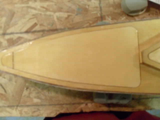

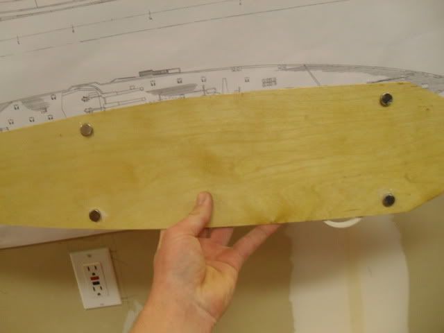

    [​IMG] [​IMG] [​IMG] [​IMG] [​IMG] [​IMG] [​IMG]/rcnavalcombat.com/Portals/0/ /> [​IMG] [​IMG] It's been quite some time since I was last on. But here is a boat load (pun intended:p) of pics of what I have done so far. For the main decks, I bought some of those little magnets things from Michaels and they seem to work VERY well. Almost too well. It's actually kinda hard to get the decks off. I also got the dummy shafts in, filled in the areas around them, and installed motors. I'm hoping to get it on the water this Sunday and see what she can do. I was aiming for Saturday, but we have some major shopping to do. As fun as shopping all day might sound, I much rather be working my ship:cool:.

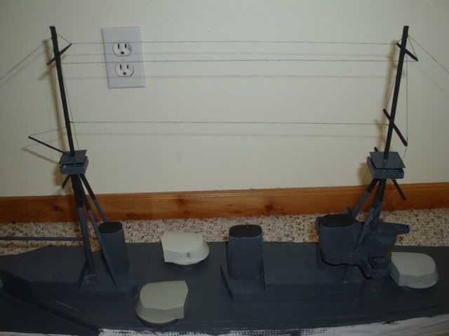

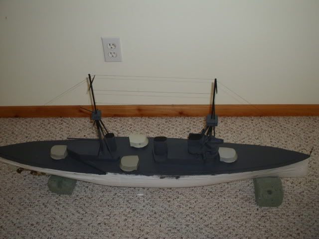

    [​IMG] [​IMG] [​IMG] What do you guys think? I still have some painting to do. But it's down for the most part:).
