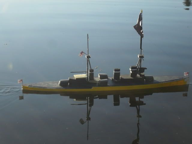

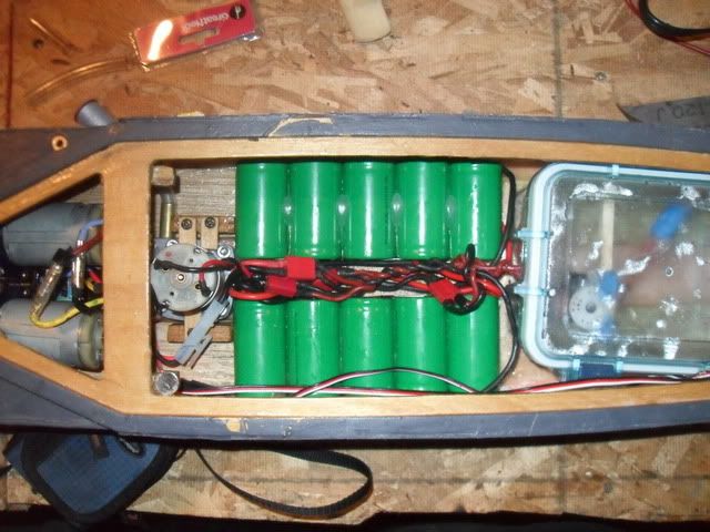

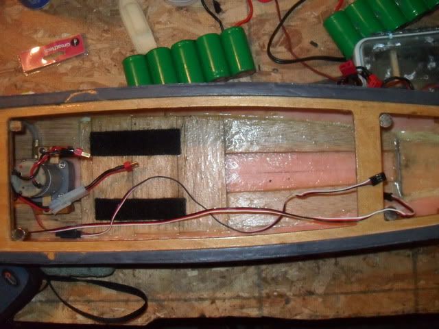

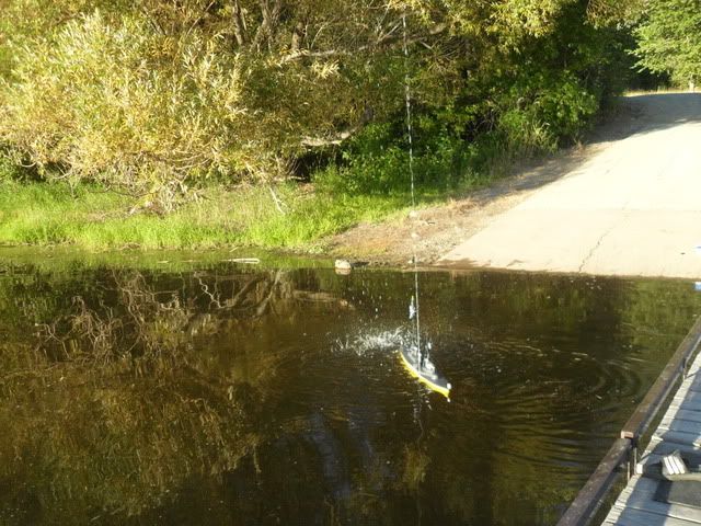

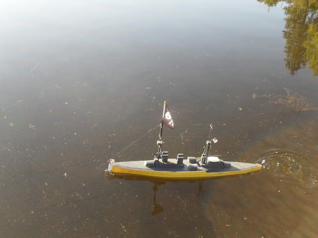

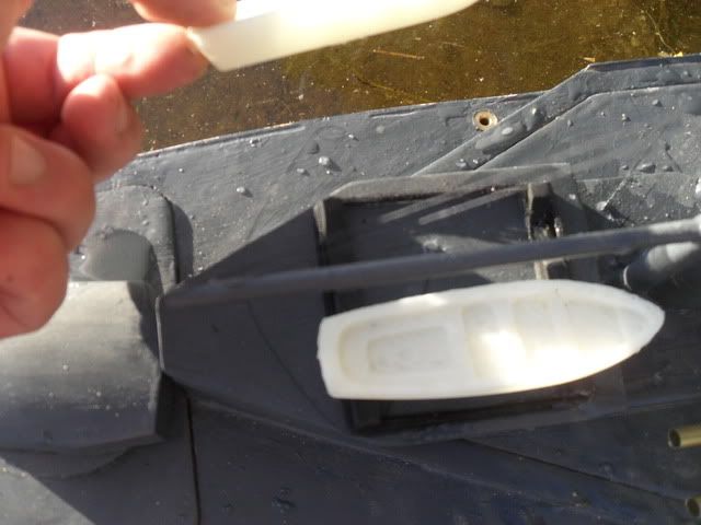

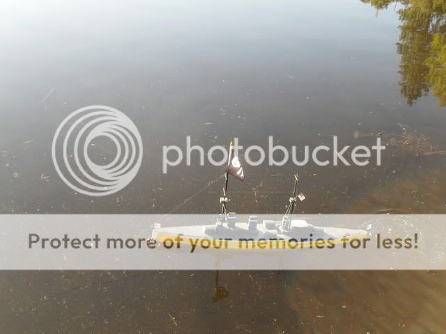

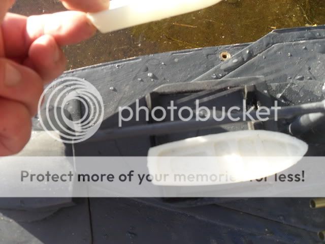

    [​IMG] [​IMG] [​IMG] [​IMG] [​IMG] [​IMG] I finally took my ship out a few hours ago for some testing, and it was working pretty well for the first...two minutes. After about two minutes the pinion gear on the portside motor came loose and it was about that time when I realized that I had forgotten my allen wrenches back at the house:blink:. I still had the other motor to limp on, so I went on to putting a few 1/4-1/4 holes in the siding to test out the pump I just got done wiring up, and it was working really well. Until my otter box leaked and fried the servo:blink:. But it took a while before the servo gave out. It was amazing how much water the ship would take on before it would sink. I'm going to have to change the magnet hold downs to screws because pretty much all the magnets popped off when they became wet. Would any kind of screw work? I was thinking about putting small screws up through the deck and have some nuts to bring the deck down nice and tight. Oh, and in the last two pics you can see the whole configuration as well as the water channeling. To hold the batteries down, I found velcro to be to easiest to use. With there being a gap in between the batteries, I'm able to tuck the wire mess down in between there. The water channeling is a 1/4 inch amid ship and 1/2 inch up at the bow. I have yet to put any channeling at the stern though.
  20. marsman1993
    marsman1993 Member
    96
    Oh, and does the pump outlet look to be in a good location?
