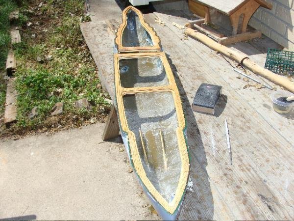

    I finally figured out how to get the pictures off our camera. Here is the subdeck, glued in and sealed with west system. I like the way the "planking" turned out, but it isn't as smooth as I wanted it. I'm waiting to cut out the main windows for last, to make it easier to balance all the hardware in there, I have already cut out the small ones that go on the casemates. Since I took the picture I have also installed the drive motors and gear boxes.

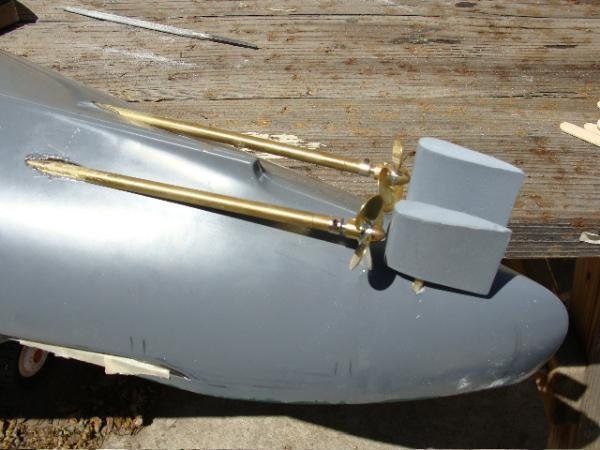

    Here are the screws and rudders, I was able to get them pretty close together (on the second try!)

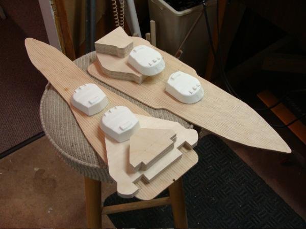

    This is about as far as I have gotten on the superstructure. My plan is to hollow these out to save weight, then maybe build the upper superstructure with ABS or 1/8" plywood.

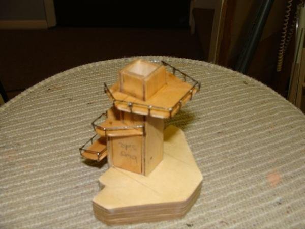

    Here is the railing I made for the conning tower. The picture is kind of blurry, but it is made of wire soldered together, and solidified with CA. It should look better once I glass over the sides.

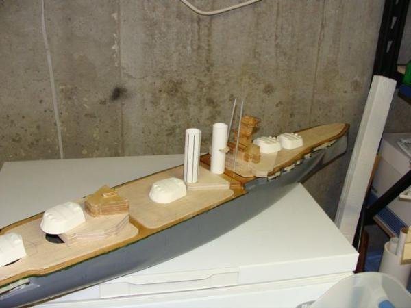

    Here is what she looks like so far.
