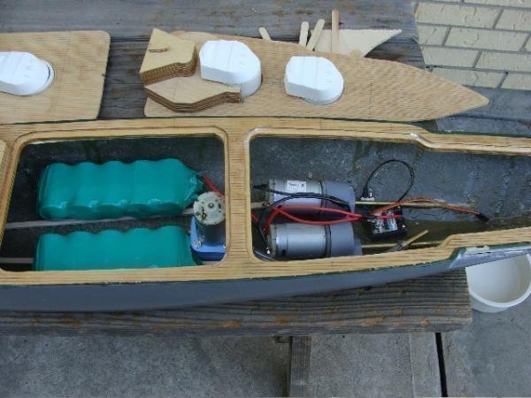

    Here are the internals at the stern, and you can see the battery packs in front of the pump. Nothing is really hooked up now, until I can figure out how the wiring should work.

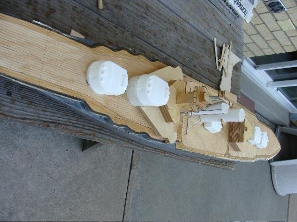

    Here is the deck so far, with the deck and superstructure in different stages of bein sealed. The barbettes are glued in, but the turetts are just sitting on top. (sorry its sideways, I couldn't figure out how to turn it.)

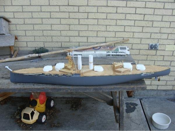

    Here is the cmpleted deck assembly so far.
    Hey Dave, are those D-cells or C-cells in your packs?
  5. rarena
    Dave, looking great!
    Esc and delta boards can be wired to the same battery, make sure the battery voltage is correct to the boards. If your batteries put out more than 5 v fully charged, drop the voltage with a diode/diodes in series to the battery for the boards. There is directions on the boards sheet (I think) that tells you how.
    One more thing, guns and gun magazines should be "roughed in" as this may change where your electrical components / wires will go. You don't want to fight with a magazine that gets caught on a stupid wire all the time. ( don't ask how many years I did that :) )
