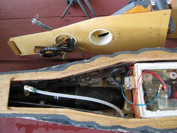

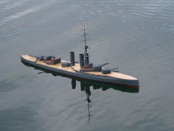

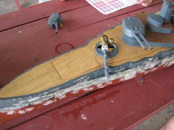

    My HMS Iron Duke made her debut at the 2010 MWC Nationals last week in Houston. Did fairly well for a new ship. Had a couple of teething issues Monday morning, but after that she settled in, chewed up Axis hull skins and took home the Best of Class 5 trophy. :D

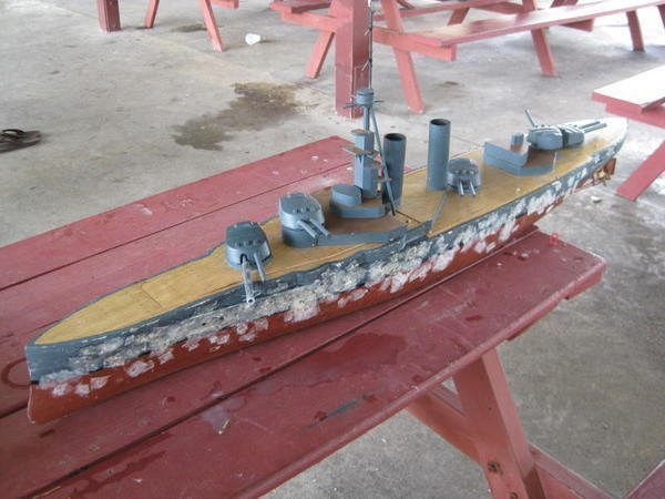

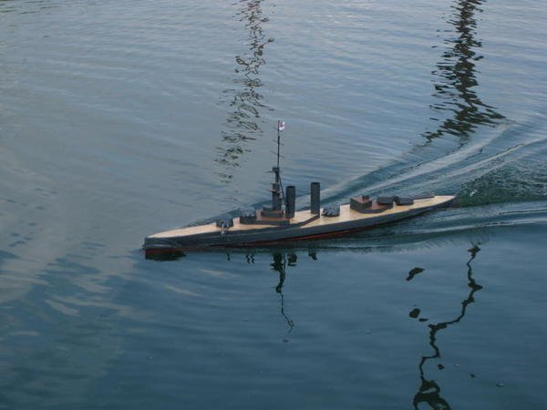

    And here are a few more from Friday after the final fleet battle. She looks a bit rugged after a week of combat, but she held her own quite well and stayed on top of the water the whole time.

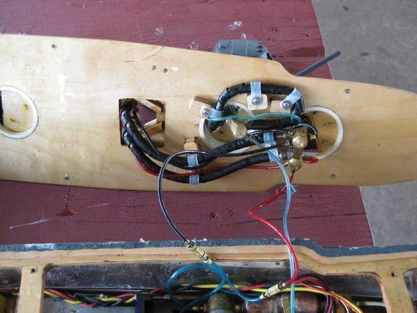

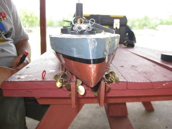

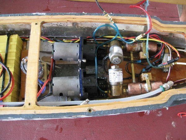

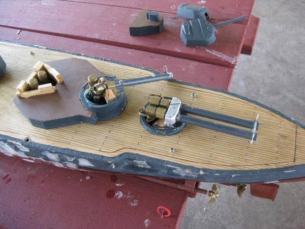

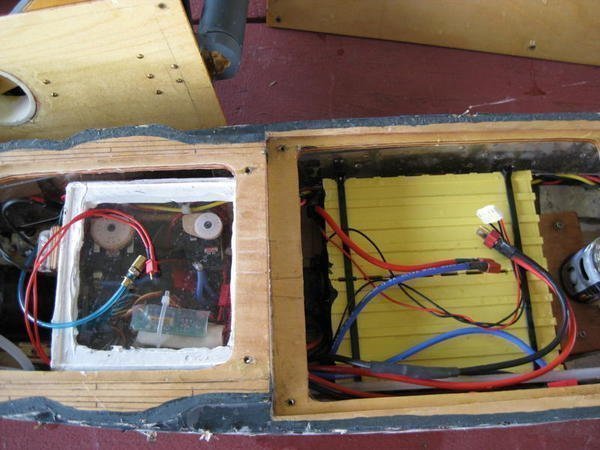

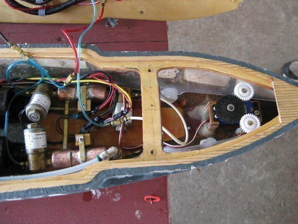

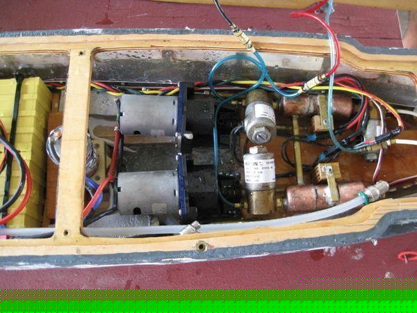

    Anyways, she's built pretty standard aside from the battery. Modified BC Iron Duke Hull, Strike Models Regulator (140psi fixed), 6oz CO2 bottle, 6v 3/32 orifice KIP solenoids, Parker pres-lok fittings and tubing for the mains, clippard hose & fittings for the solenoid-gun connections. Radio box has a standard MAG throttle & 15amp pump switch. Team Delta board for fire control and a Spektrum receiver. Receiver is powered off the main bus using a Castle Creations 10a BEC set to 5.5v. No problems with brownouts at all using it. LiFePO4 batteries (2 20 amp cells in series for 6.4v). Deans noodle wire. Stinger motor on a Chris Pearce pump. Dave Ranier pump outlet. Guns are also by Chris Pearce. Traxxas gear boxes to drive 1.5" 4 blade Prop-Shop props (lost the starboard screw monday morning thanks to a bad brazed joint...replacement to happen soon). 44t gear on the rudder servo from Servo City, standard traxxas gears on the rudders themselves. Traxxas waterproof servo to move em. She's a solid little boat.

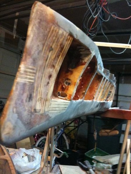

    Oh...the modifications to the BC Hull? I completely rebuilt the bow......

  9. HorribleHarry
    HorribleHarry Member
    Sep 5, 2008
    78
    Are the backs of your rudders flared?
  10. Iunnrais
    Iunnrais Active Member
    Jul 11, 2009
    262
    Texas
    yep. Not sure how much difference it makes in our scale, but I pulled that design from a commercial full scale series.
  11. Xanthar
    Xanthar Well-Known Member
    Sep 13, 2015
    676
    Upstate NY
    Is there any chance we could see what the bow looks like in profile? I'm thinking about doing something similar.
    PS. I love the way you mounted the aft cannons. I'll be copying that : )
