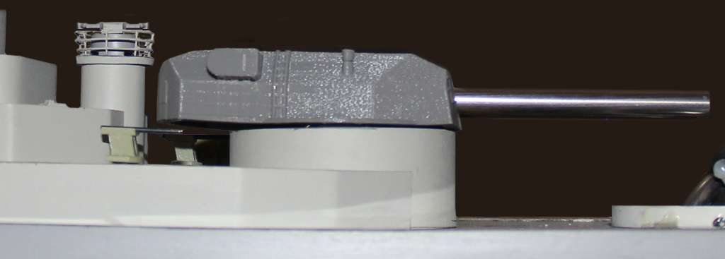

    The 3D printing of SS is really interesting! We're working with 3D printing now in WWCC (a Bismarck gun house for the mains). A few questions:
    1) Have you blasted away at it to see how bullet proof it is?
    2) Have you found a way to print without needing to laboriously remove the supporting material?
    3) Have you figured out yet how to print a smooth surface? So far, no joy here.
    Here's the current subject in our experiments, and as you can see, the surface is pretty rough. Any suggestions would be appreciated!
    Rob

    Rob, one of our locals has a printer than cant print smooth as a baby's butt, sans diaper rash. Catch is, its not an extrusion printer and it costs a considerable amount more and has a smaller print volume available, but it prints so niiiiiice.
