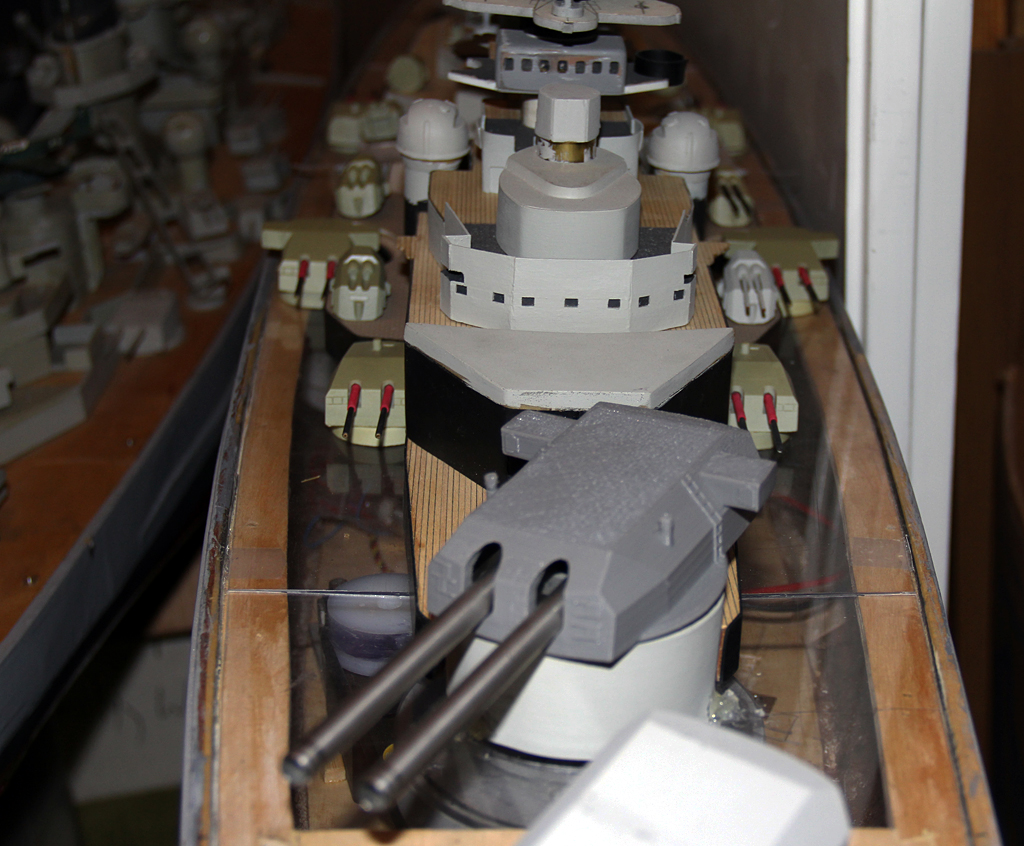

    I predict that as more and more RC warship combat enthusiasts adopt this technology, we will begin to build a virtual library of drawings that we can share. One challenge is going to be the sheer number of subjects. Of course, certain parts are fairly generic per country per era, such as some gun houses for mains, secondaries, ship's boats, searchlights, etc., and many guys in this hobby are not too particular when it comes to nit-picky scale fidelity, so that helps. For scale enthusiasts, though, this is pretty exciting, because if one drawing is produced accurately, and then it's shared, anyone who wants that same accuracy can simply print the part (or have it printed).
    Take a look at this project I've been working on for the past 10 years, off and on. Everything on this ship is accurate to the 1:1 prototype, except for the main gun barrels, and the distance between them which, unfortunately, I'm stuck with. While only the B turret gun house is 3D-printed, the secondaries, AA mounts, dome range finders and ship's boats are all dead-on scale, molded. If we all can agree on the scale proportions of SS and parts for at least a few of the most popular ships, such as the Bismarck, then a guy with access to the library can print a part and know it's going to fit:
    Another hopeful aspect is that this sort of "cross-cultural," mutually beneficial design work does not rely on niche: The Fast Gun builders have the same objective as the Big Gun builders, and scale doesn't matter, does it, as long as the width>length>height is proportionately correct. A 1:144 superstructure drawing can easily be scaled to 1:96 or 1:72. The chief limit on the hobby end of things seems to be the print area of affordable printers.

    We were having trouble with the gears on the motors... the stainless setscrews from McMaster are not threaded for their full length, resulting in them jamming in the setscrew bores on the gears, without engaging the motor shaft. Crap. Had no solution for 3 weeks, but managed to get the setscrews out of a pair of gears (2 still useless), and was going to order longersetscrews, when I saw on the shelf... a bottle with 3/8" 4-40 brass Allen screws! Sure enough, they work! And they look cool, and at the speeds my motors are going, they're not posing a balance issue! Fix applied, and tested sat :) Also got a little work done on the plumbing for the guns, and got the gun barrels reinstalled. They had been pulled and sent to Brian to get the hole for the safety pin drilled in them.
    Almost combat-ready!

    This past weekend, I got the stern guns properly wired up, installed plastic wire loom around the magazines, installed the internal armor, and verified that my batteries can supply enough voltage to fire the solenoids even with the drive and pump running. Aside from printing the rest of the SS, all that's left are drag props, wiring the forward sidemount, and final ballasting. At this point, she weighs 23# 10oz, so plenty of room for ballasting.

    I like this plexiglass deck.... gave me a great idea on how to finish off the display ship we are putting in the local hobby store. I am going to use clear plastic to skin over a few windows so they can see inside and still keep little fingers OUT! I can now also use a plexiglass deck! This way they can look down into the hull....
