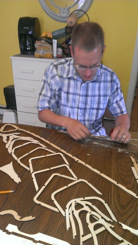

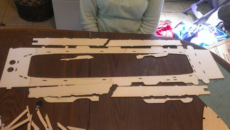

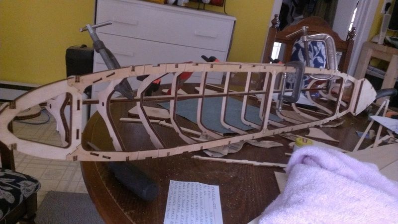

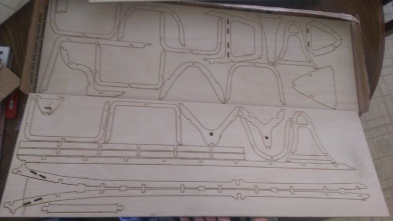

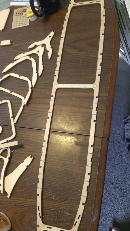

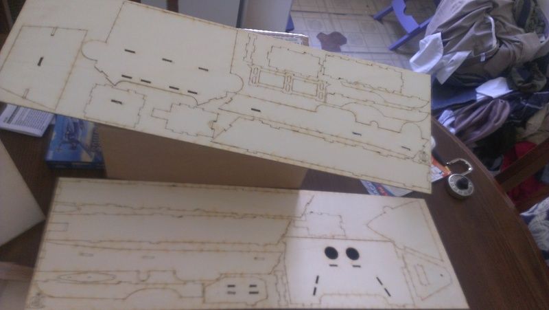

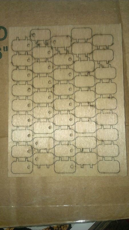

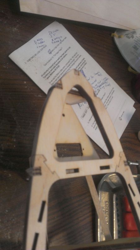

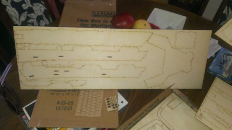

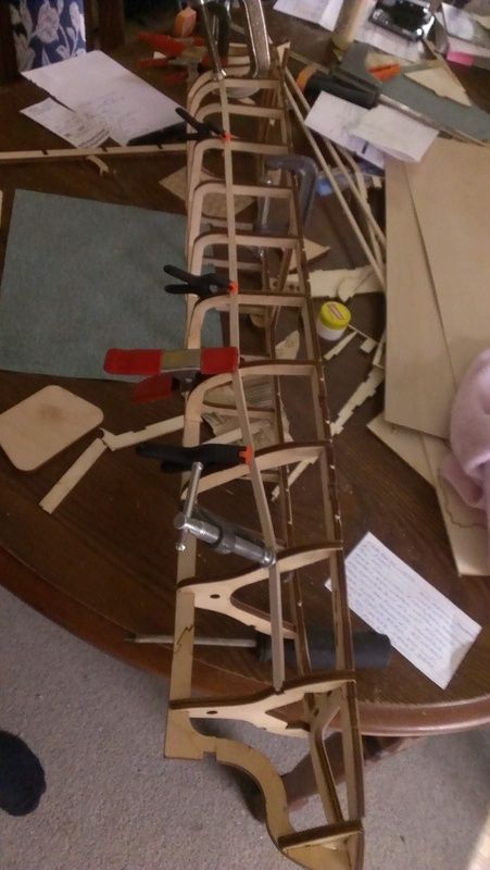

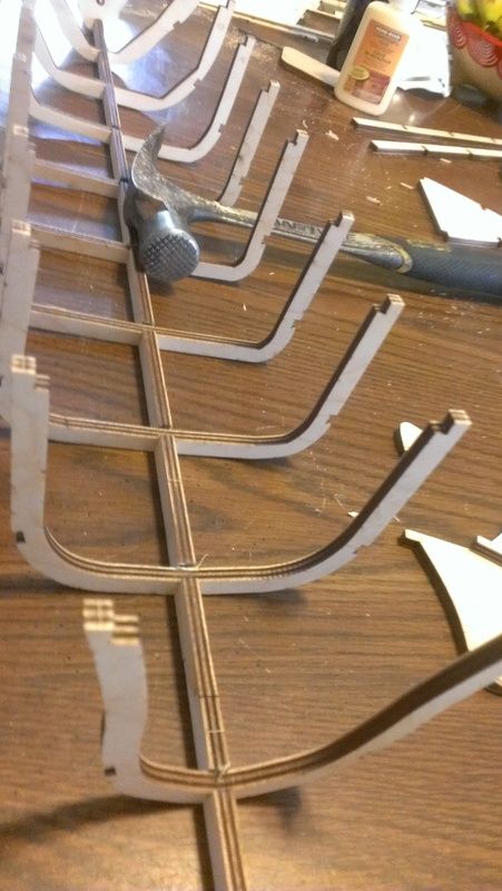

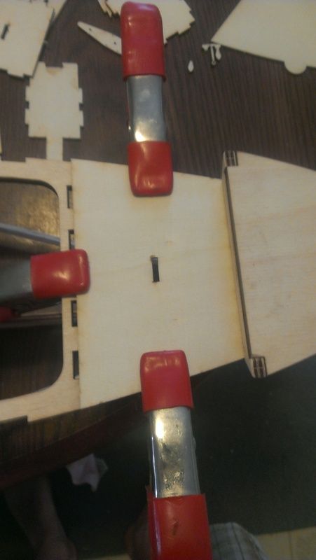

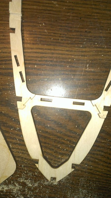

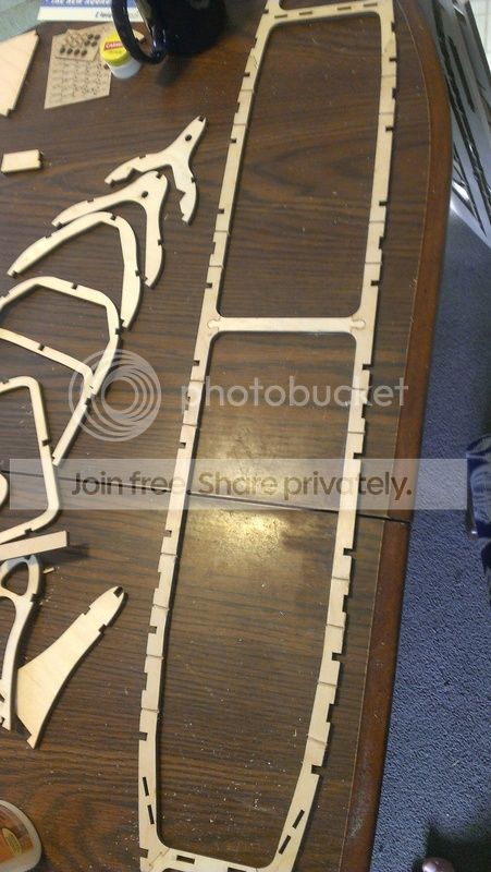

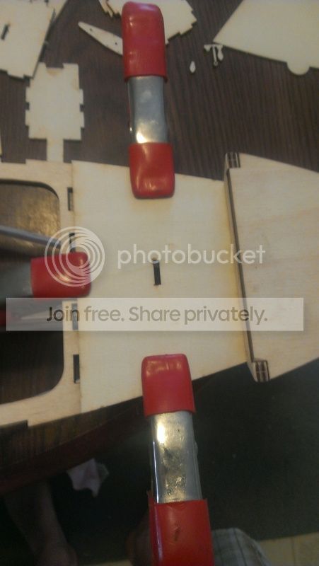

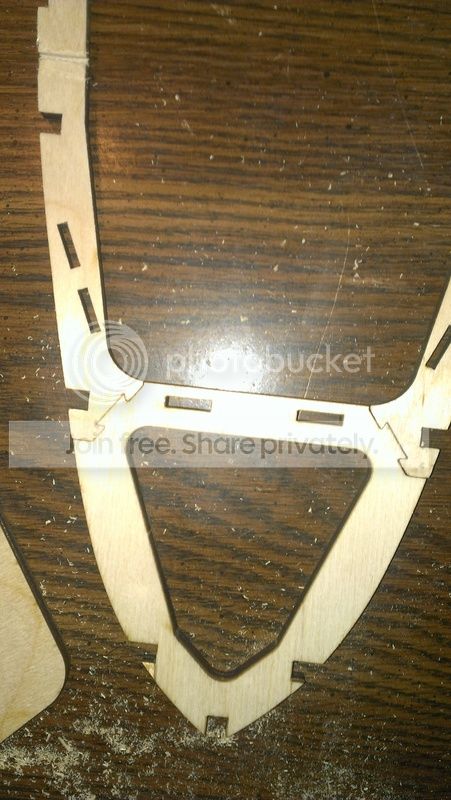

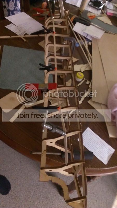

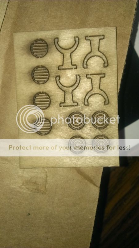

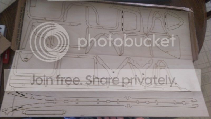

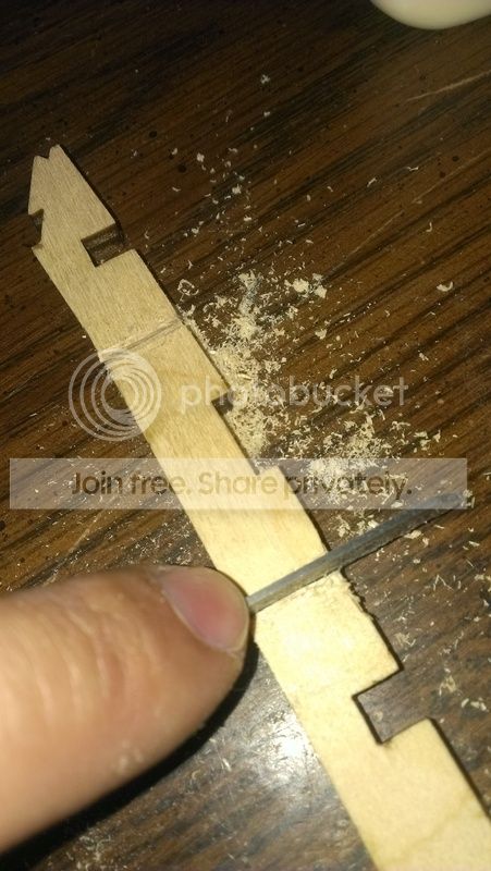

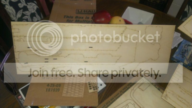

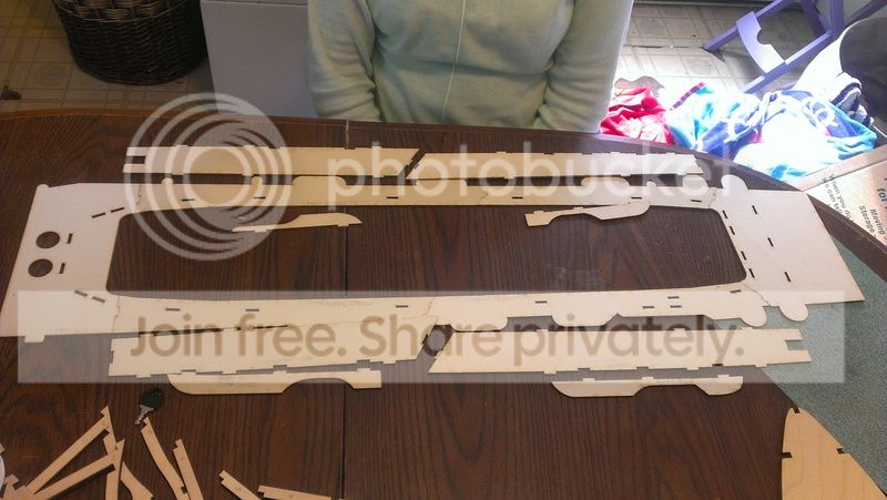

    Ok so here we go.
    Unboxing
    The 1/4" goodness
    DE PLANES DE PLANES!

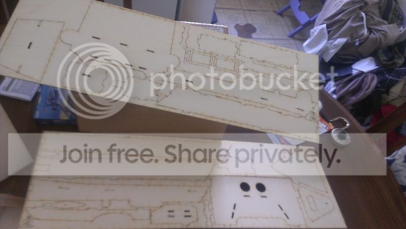

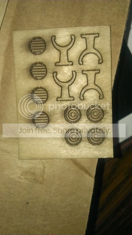

    Doors n' lights
    Cutting the subdeck to allow easier mild bending
    Assembling the subdeck
    All together

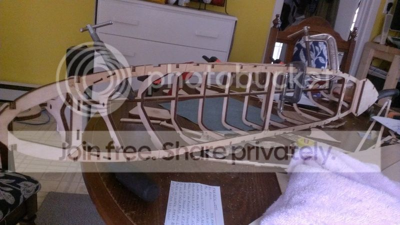

    Prepped for insertion (tee hee)
    Clamped and risers done, reinforcement done

    Ok so before I start with the planking, I had a question about tipping. With all the extras I plan on putting on the top of the ship (doors, planes, people, glassing, lights, guns, etc), should I be worried about it tipping? underneath will simply be a servo, battery, ESC, and receiver. I don't know much about aircraft carriers, so some helpful suggestions would be welcomed.
  4. SteveT44
    Your going to have to ballast her down to the scale waterline. That should provide plenty of stability for your add-ons. FYI, a ship does not tip, it "lists" ;)
  5. thegeek
    get some lead shower pan liner material or the like (sheet lead). Glue it to the bottom. She will be rock stable.
  6. canx2k
    canx2k Well-Known Member
    Apr 23, 2015
    281
    canada
    Thanks guys - I will weigh her down some then for stability.

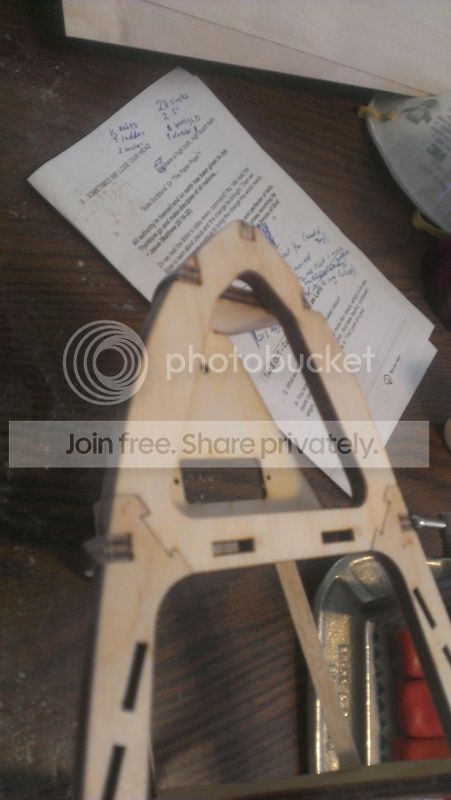

    Servo spot
    Bow sub deck
    Bow subdeck 2

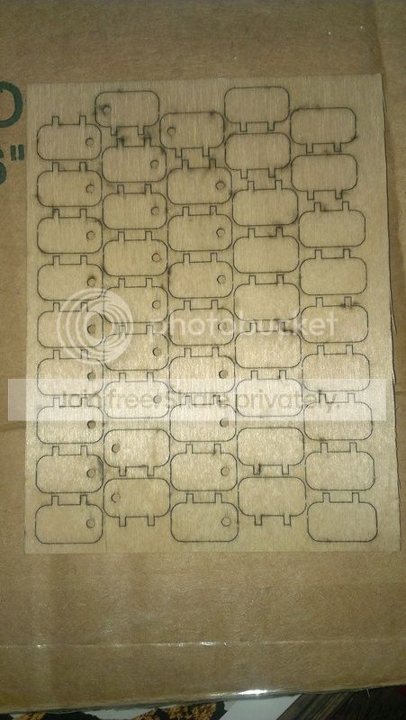

    With the amount of detail and extra expense there's no way in heck I'd let someone shoot at it. I'd make a second one for sure. :)
    btw planking sucks. Soaked the panels in water, superglue ajd/or carpenters glue, nothing worked to keep it on to my liking. It looked so pretty on rcengrs pdf I can't believe how bad I'm failing at it.
  11. Lou
    Use strips of wood, you will be painting it so "pretty" will not matter as much as "waterproof" :)

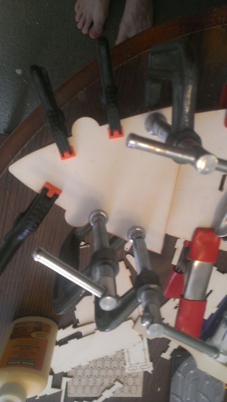

    canada
    Gluen and clampn
