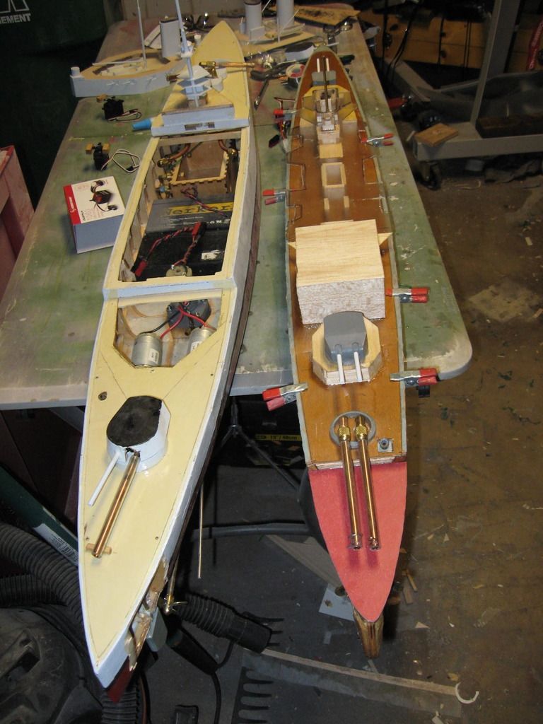

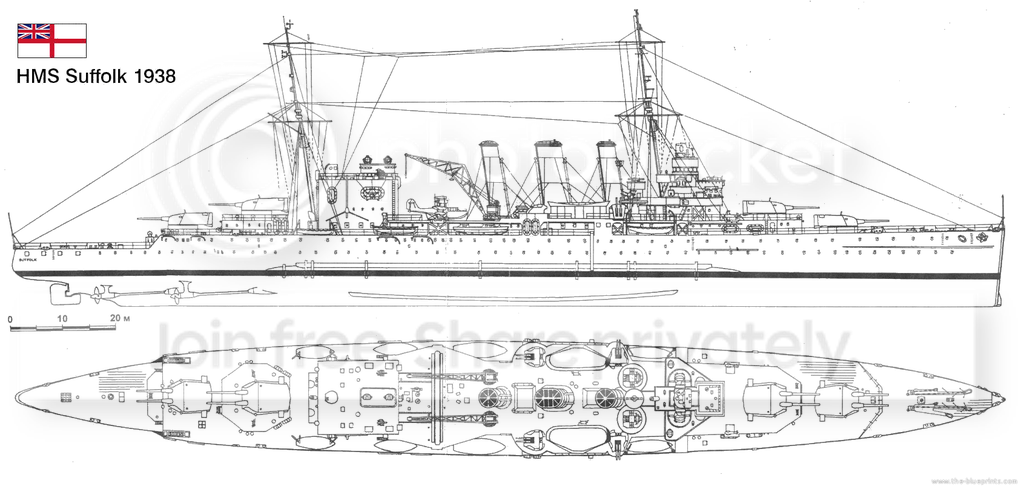

    Building up HMS Suffolk, a county-class cruiser. Shadowed Bismarck with radar after Denmark Straight and had a long career with the Home Fleet and Eastern Fleet until after the war when she was quickly disposed of.
    This will be one of the "loaner cruisers" for new folks and PMWC battlers wanting to try out fast gun and as such will be a simple ship with poppets rather than solenoids. Planning on using the venerable 6V7Ah SLA for power.

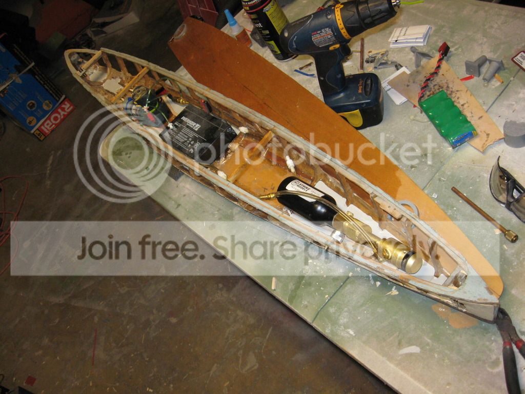

  3. Renodemona

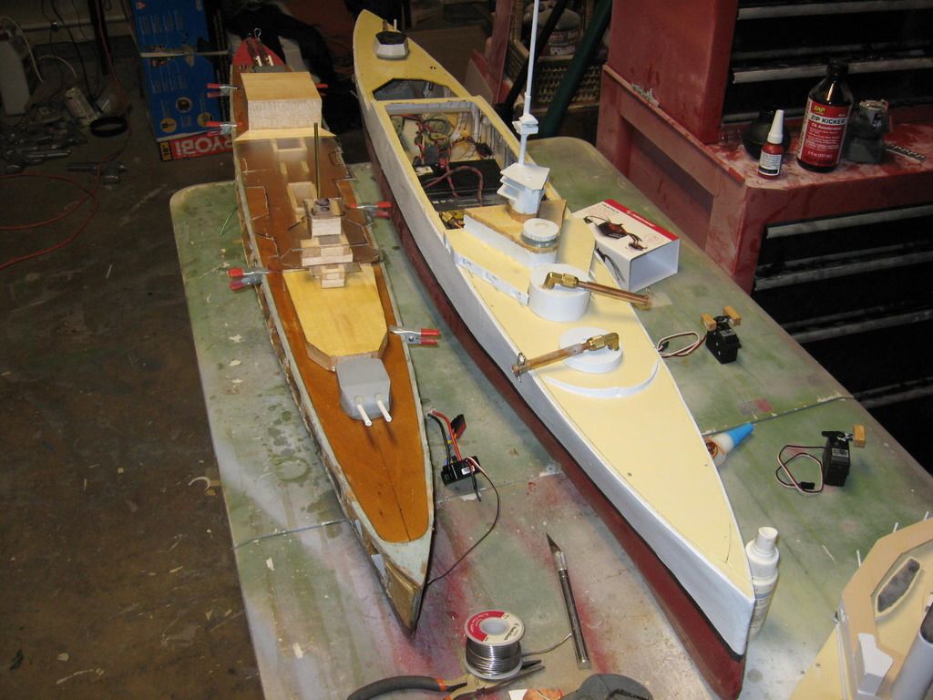

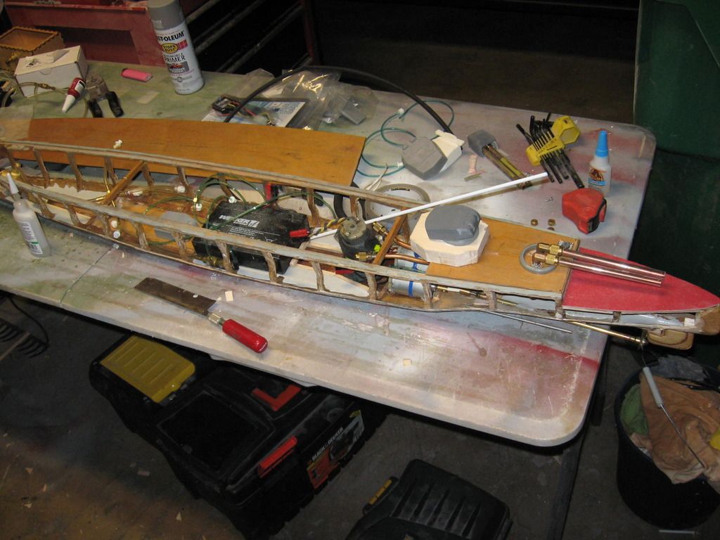

    Already got most of the internal layout complete. Big battery. Bottle. Regulator. Gas system. Just need a couple servos, an esc, and a microswitch. Not much to it, but it always seems I find a away to fill up all the space!

    Nice. How did you mount the motors?
    I was considering (and still am) scratch building HMS London.
  7. Renodemona
    Sticky tack and resin. Probably not the best but I'm not going for precise with this one, just getting it built quickly.

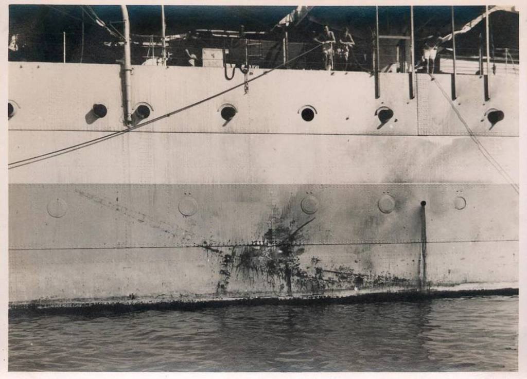

    Impression of a kamikaze on the side of the HMS Sussex.

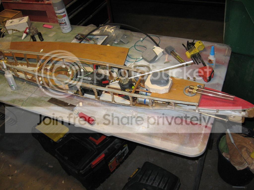

  9. Renodemona

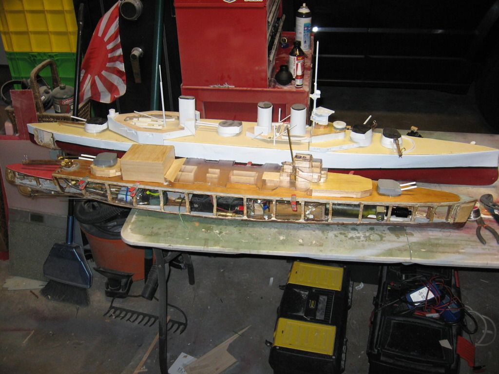

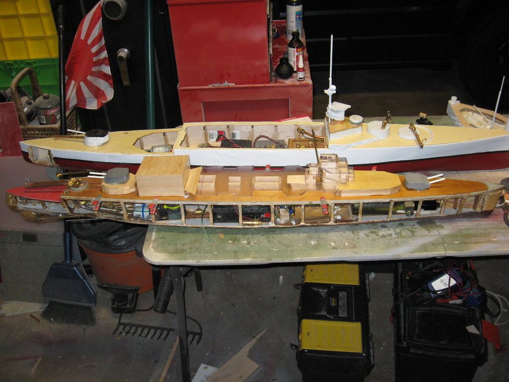

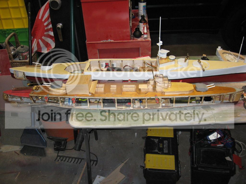

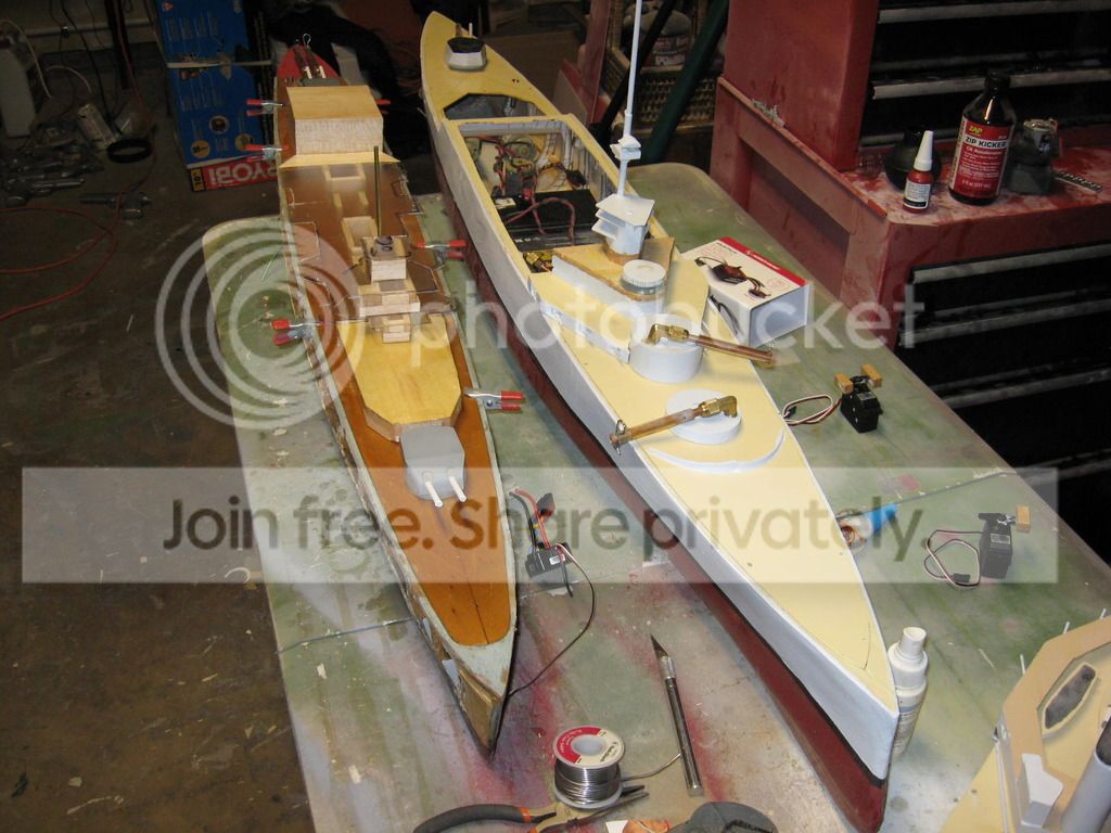

    Started the super for the Suffolk. With the light cruisers finished up, time to dive back into the big Brit again.
    jstod likes this.

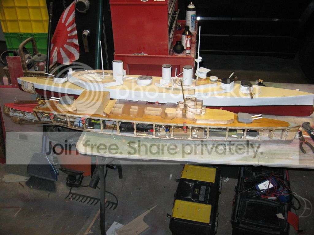

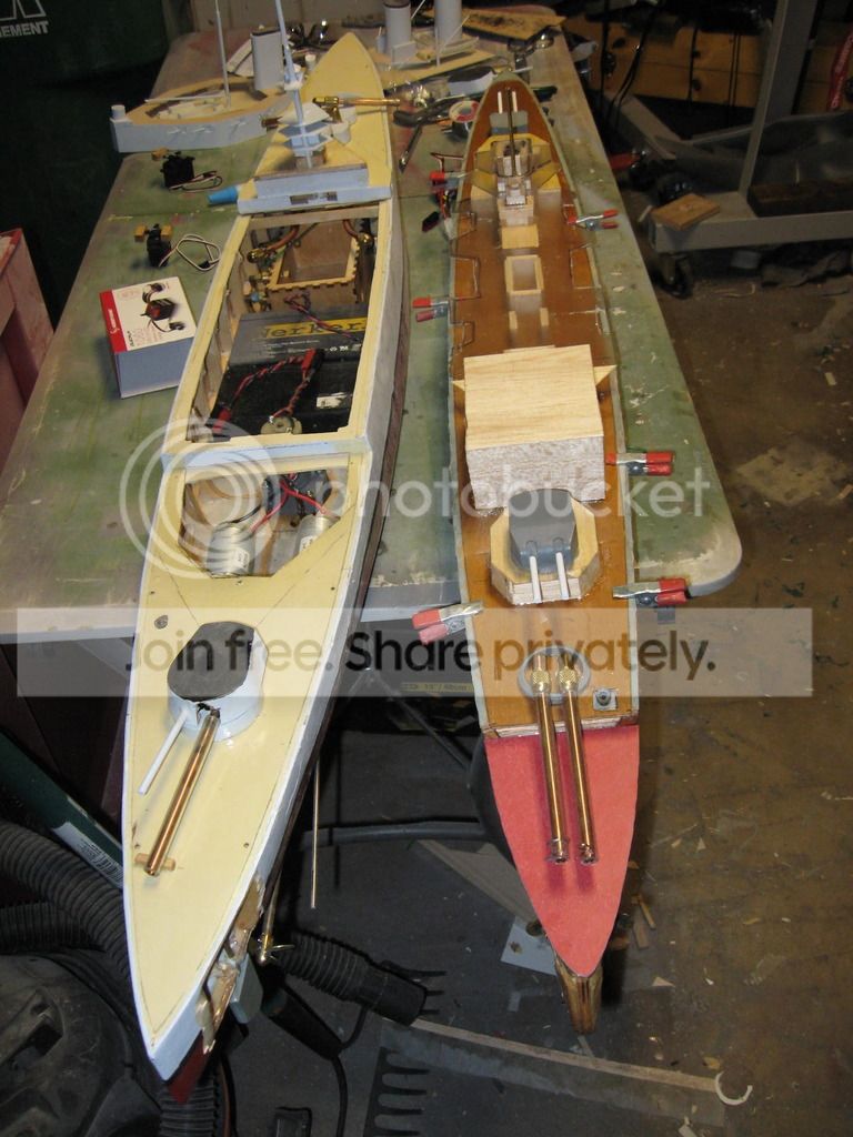

  10. Renodemona
    Some more work on the big British Cruiser. Kind of a funky design for the super. Very clearly still influenced by WW1 cruisers, but starting to move towards the tower structures more familiar on the Leander and Town classes. Also the Queen Mary building for another PMWC member.
