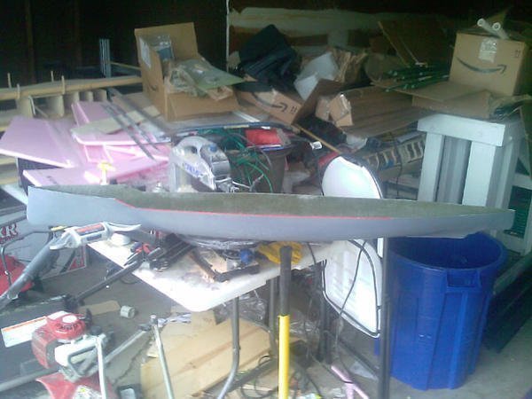

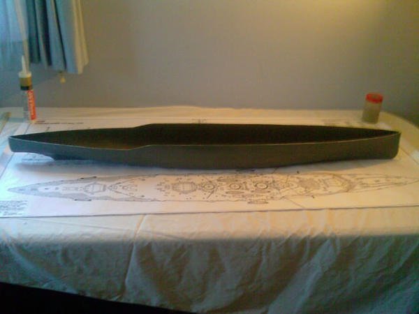

    2010-04-01: During the course of this project, a Battlers Connection Lion hull will be modified to create an HMS Tiger. The Lion hull sits atop a set of Taubman HMS Tiger plans.
    2010-04-03: A rainy day in Chicagoland... too wet to do any serious work in the garden. Hence, I decided to begin work on the Tiger. First, I marked the location of the casement deck using 1/8" masking tape. Then, I removed excess material from the hull using a Dremel tool. After looking at the photo, however, I probably should have spent the time cleaning the garage.

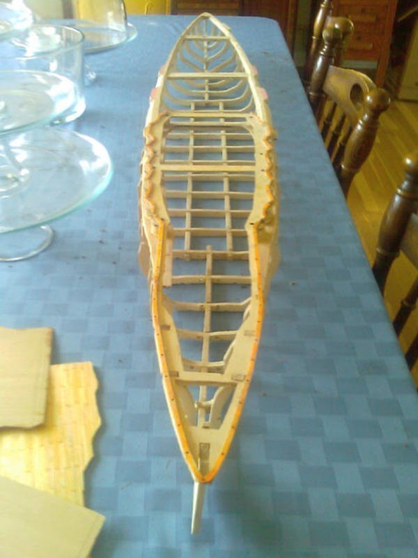

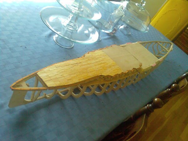

  20. jpmarino
    jpmarino Active Member
    Jan 7, 2008
    123
    Addison, IL
    Disclaimer - Not Tiger Related
    I'm not certain if you were talking to myself or Tugboat...

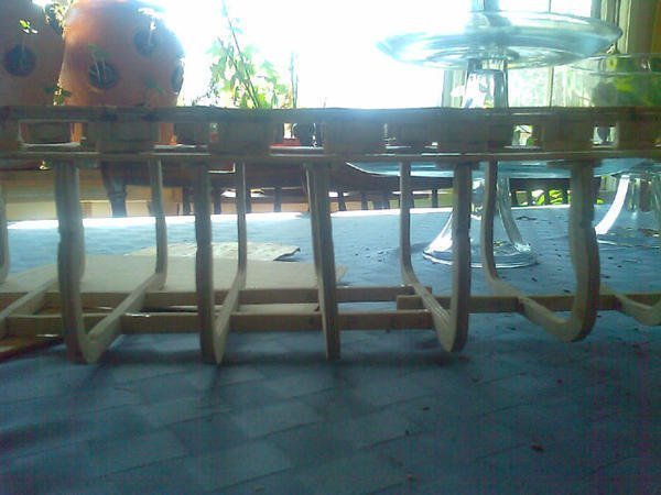

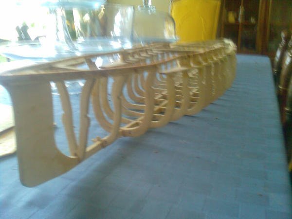

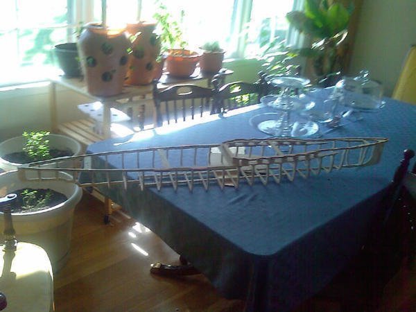

    I live in Addison, IL (about 35 miles west of downtown Chicago). I snapped a few photos of the Hyuga this morning so you can decide if she is worth putting any time/effort into fixing.
    It looks like the bow is a bit crooked but it could be due to the missing/loose ribs. Also, the holes visible on the outer deck are where I planned to install railings.

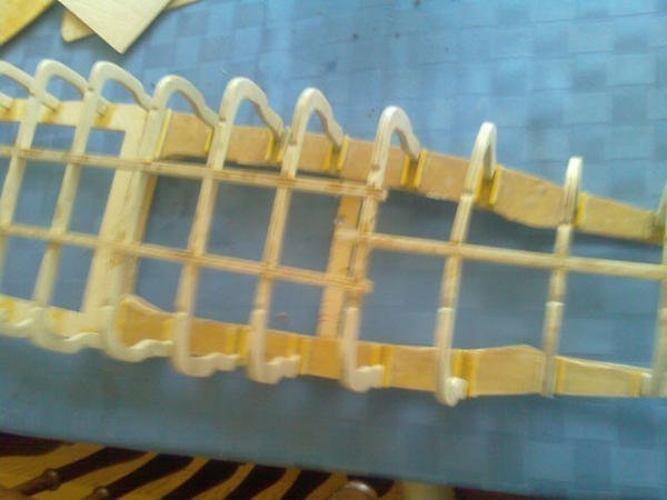

    [​IMG]\
    The missing rib. (I originally thought there were several but the others are only loose).

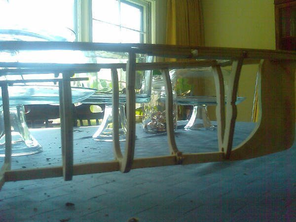

    A view from underneath the casement deck. Several of these ribs are loose. Also, part of the small strips securing the ribs may have to be cut away to be MWC legal.
    A crooked rib (probably the worst/most obvious).
