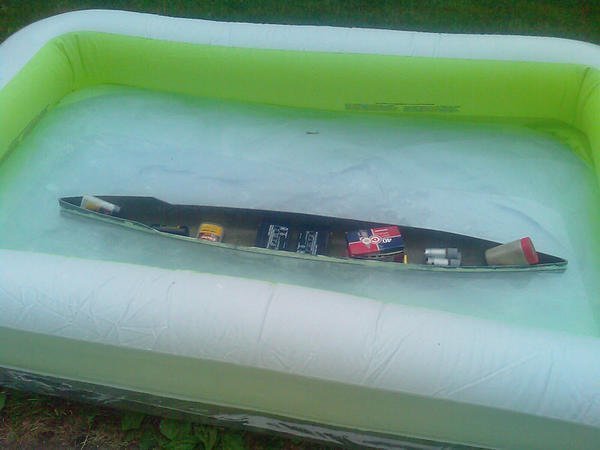

    2010-06-13:
    I'm not exactly breaking any speed-building records, am I? Anyhow, I had some free time this past weekend and decided to mark the waterline on the Tiger. First, I weighed her down to 25.25 lbs (approximately the MWCI scale weight) using various forms of ballast. Then, I floated her in an inflatable swimming pool and applied old white latex paint to hull, attempting to keep the water as calm as possible until the paint dried to touch. My theory was the paint wouldn't dry beneath the water. All in all, it seems to have worked just fine.
  13. mike5334
    Nicely done. :)
    One thing to keep in mind is that you are not required to run at the scale weight. Ship builders have the option to run lighter ... in fact, I don't think the MWC specifies a minimum weight at all.
    What that means is a ship builder can adjust the weight until the ship is floating as low or high as the builder likes as long as the ship is under it's max weight.
    I believe it is possible to get too low in the water which may introduce water into the hull through a poor deck seal or over a low barbette. A very low in the water ship may turn worse. The Iron Dukes seem to be a good example of ships that run better at a lesser weight and sitting a little higher on the water.
  14. jpmarino
    jpmarino Active Member
    Jan 7, 2008
    123
    Addison, IL
    Interesting point. I do think the waterline is fine where it's at, though (I'll aim for a final weight of about 25.25 lbs). I have a feeling this ship will be treated as a big cruiser for a number of years so I'd like to keep my stern cannons as close to the water as possible. Also, the picture could be a bit deceiving because the ship is missing the entire casement deck (which, the way I'm moving along, should be installed by the year 2058 :laugh:).
