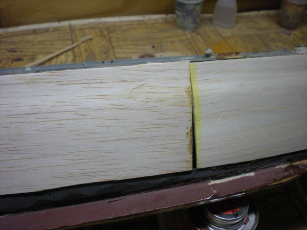

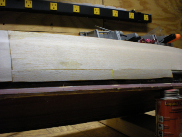

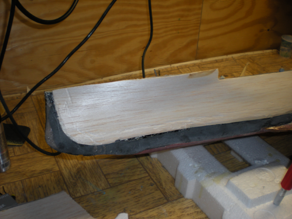

  11. jadfer
    I stressed on it for a while but when I sat down and did it ... it was one of the easier things I had done. One note I found is that my baden was previusly sheeted with CA and it leaves a lot of very hard bumps that take a lot of work to remove (at least to me). Removing the contact cement seemed eaiser but didnt leave the bumps on the hull and I was told in some cases other guys just left the residue on the ship and re-sheeted.
    I had a local captain show me how to the first side and the hardest part for me was to let go of rigid thinking in terms of trying to line up the top edge of the sheet to the top edge of the hull. I was shown it was okay to take a sheet and lay it at an upward angle to conform to the hull. Then I just take the exacto and trim off the excess.
    The first side I did what I had read and took a 3 inch piece and then cut several smaller pieces but with a ship that has no casemates I didnt really need to do that.
    On the second side I used a 4 inch piece and wow it took no time at all with only 1 or 2 seams and I think 2 pieces. I found that instead of trying to line up the edge of the sheet at the top that I tried to line it up with the bottom of the hull as it was easier to trim it at the top.
    This is a picture of the gap on the side with only two pieces. I just filled it with balsa filler and sanded.

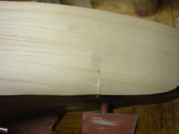

    I found that holding the ship was tough, I cracked the sheet in the stern from holding it but I floated it with filler before I put on the silkspan.
    Good luck.

  13. rarena
    Hey!!!!!!!!!!!!! that came out nice. The second time goes even better. I always trim the top also so you are spot on with that one. Don't sweat the crack too much. I usually silkspan over my cracks anyway. Did you use silkspan both sides to help it? If not, next time [8D]
