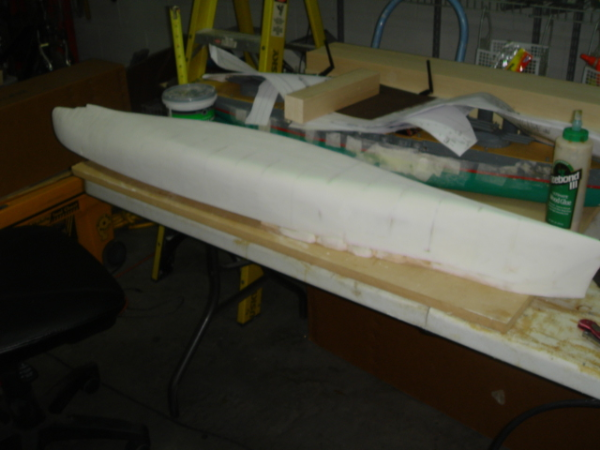

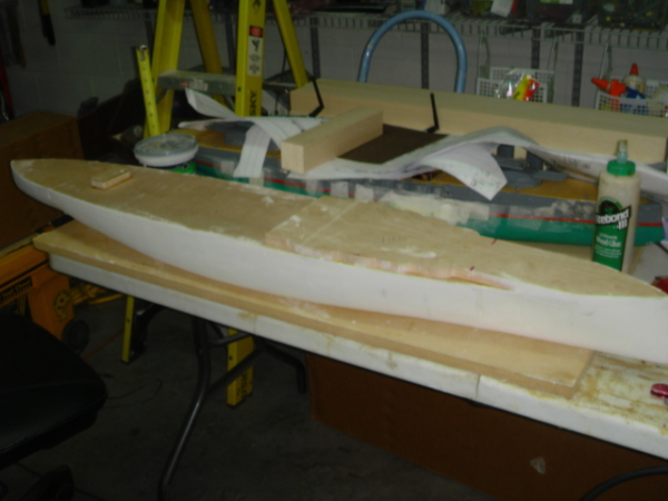

    Well I'm working on a plug for a ship. I made my small Jap tanker early last year using a foam plug, as a one off hull. It did very well at Nats, so if this works out ok, I think I will make a mold for that one again as well. This is my first effort making a plug, and a mold.
    It has plywood ribs, but as you sand I notice the material in between actually sands away more than the plywood. I dont want its panty line to show so to speak.
    What do you do to stop this affect, or do you just continue to build up the material in between with spackling compound. Mine is not too bad since I used balsa wood as the filler material instead of foam. I have it at about 98% to shape, the bow area needs some more work. I also need to cut out the rear casemate area, which I plan on doing tomorrow with a dremel.
    Here are a couple of views of it so far.
    Plus any other suggestions that you may have. I put one coat of the spackling just to fill all the cracks between the balsa blocks I glued together. I sanded a little, but I plan on allot of sanding tomorrow. Like I said I still need to get the bow area to its proper shape, which I plan on doing tomorrow also.

    The foam always shrinks back a bit between the ribs when sanded. What I do is apply drywall compound or Poly-Filla and carefully sand it down until the ribs a just visible through it. That will give a smooth surface withoput any 'panty lines'. Takes some practise though!
    What is the hull? Iron Duke?? If you get a good finish on the plug you might as well make a proper mold.

    Sounds good Bob, thats what I had planned to do, but was not sure if you guys that make them all the time, had a different way, or material. I'm using the drywall(Spackling Compound)so it seems I'm on the right track.
    Thanks again

    Looks like the Iron Duke to me.
    Sand the flat areas with a drywall screen. Get a holder (or whatever they are called). This will eliminate any dips and grooves caused by fingers.
    Use a sanding sponge for the curves.
  18. djranier
    Nope, mine will be the Benbow. I have a sanding block I started using, and a sponge. Thanks for the input guys.
