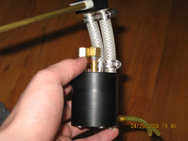

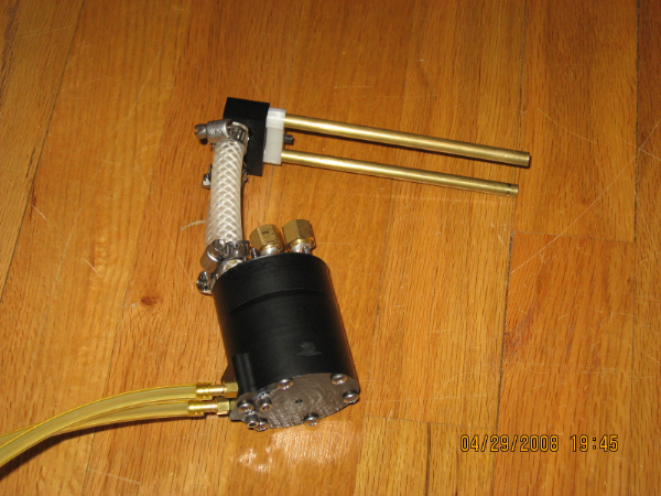

    Here are some pictures of the twins. I am working on another 3 sets for justin to play with. So far, they feed BB's and 3/16" bearings with just a swap of o-rings. the canisters are 2" diameter and ~2.25 inches tall, before all the stuff starts poking out the top.

    DooouuuDD! They look better than I remembered! I'm so excited! They are baaadd ASssS!
    Two requests:
    Leave the screws on the top long (or at least allow some way for me to) That way I can mount the cannons high, if I want (I probably will)
    Tap the bottom center hole so people can easily mount the cannon to the bottom of the ship.
    What does extending/reducing the flexi-hose do to the "cross talk" / timing? Nothing, right?
  4. GregMcFadden
    The longer the hose, the longer the time between shots since it takes more gas to fill up that area. The bottom center hole is a smooth 1/8" diameter, so I will probably let folks tap it themselves if they want(as you can drill it out without disassembly for the right size tap) so that if you want to pivot on it, you can. If I had a lathe, I would turn down a threaded rod to have a pivot and a catch so that it would just snap into a receptacle in the bottom of the hull, but as it is, I will leave the mounting to folks.
    the bolts are going to be left long on the top.

    To clarify my 3rd question, I will use tracer bullets:
    If I lengthen the hose, I will have to re-tweak the o-ring right? (I understand that adjusting the hose is a once or twice sort of thing, I'm just trying to understand the way the system will behave)
    If so:
    Will "depressing" the barrels (squeezing the tubes dynamically during battle) change the geometry of the system enough to make it hit 'softer' or worse go full 'auto'?

    elevation has no effect unless you kink the tube (which is really hard to do). The tube length is simply a time between shots issue (and not much of one from what I have played with) since it just effectively increases the internal volume of the cannon.
