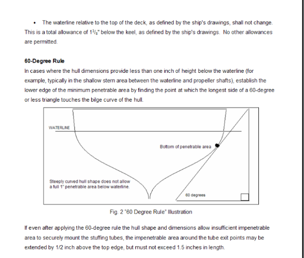

  5. Cannonman
    Apr 9, 2008
    879
    Hermitage, Tn
    Here is some pictoral help from the Western Warship Combat Club. They use the 60 Degree rule, but you get the idea:
