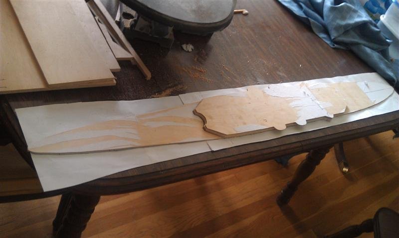

    Concerning the build, I'm using the Miyukikai 1/200 Suzuya plans. I've scanned them and used Photoshop to convert to 1/144 scale.
    On 6/22/2013, I cut the decks from a sheet of 1/8" plywood and the center step area (not sure of the nautical term) from 3/8" plywood. If I remember correctly, both are aircraft grade birch, but it's been quite some time (on the order of years) since I ordered it.
    That's all for now.

    Looks good! Are you going to notch those pieces for the ribs, or do butt joints?

    Hello Tugboat:
    The pieces currently cut and shown above are the decks. I cut those first because I had the least 1/8" plywood (only a single 12" x 48" sheet). Hopefully I'll get a chance to cut the subdecks this weekend out of 1/4" plywood. I'll probably notch the subdeck but, in the past, I did experiment with my router to create a groove style joint. Perhaps I'll try some combination of the two.

    I like to use a router table with a 1/4" cutting bit in the router, and it makes short work of even large hulls needing notches. Alternatively, in the absence of a router table, Brian K and I clamped a router upside-down on a worktable to use it that way. It's easier to gauge your progress with the work on top, I think.

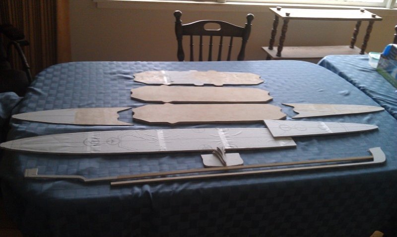

    Hello all:
    I got an early start this morning and did a bit more work on the Suzuya, including cutting the subdeck, keels and a few ribs (outer cuts only on the subdeck and ribs). With the following picture, I'll try to show how I envision the ship coming together.
    From top to bottom:
    - 1/8" deck for the step section
    - 1/4" subdeck for the step section
    - 1/8" rear deck, 3/8" step section, 1/8" fore deck
    - 1/4" subdeck cut in two sections... overlap kept because I'm planning to route away the top 1/8" of the aft section and the bottom 1/8" of the fore section to create a somewhat stable joint between the two.
    - Ribs 1-3 and 15
    - Aft and fore keels, with a lot of overlap kept between them; I'll sort that out later.
    That's all for now.
    Take care,
    John

    If you were to build the Mogami. How would you approach the aircraft catapult support,that hangs over the side, like a ice - cream cone that nearly touch the waterline. If it is not behind a rib would you cut out behind the cone. Then make the cone out of 1/32 balsa? Best of luck with the build Skip
