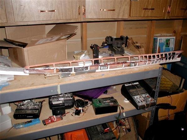

    MWC-IL Build Session (2011-06-05)
    Test fitting the rudder on Yahagi. Ethan really should tell me when he is about to snap a picture so I can suck in my gut :laugh::

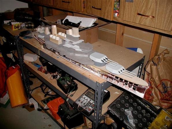

    Instead of building my own superstructure, I decided to take a shortcut and steal Aaron's from his USS Iowa. I call it the IJN Yahiowa!

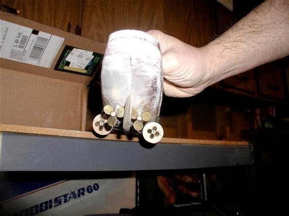

    A rear view of the rudder, main (inner) and dummy (outer) shafts. The drag disks may be a bit too big but, for now, she has the maximum sized disks allowed under MWC rules:

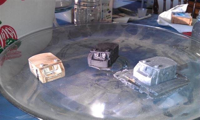

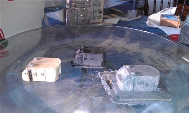

    Hello all:
    It's been a while but, after a bit of a break, I took some time this past week to work on Yahagi. First, I finished the prototype turret housing for Yahagi's main armament. I proceeded to create a mold using the Smooth-On OOMOO line of products. Finally, I cast a few turret housings using the Smooth-On FeatherLite and SmoothCast lines of moldable plastics. One of these days, I'll have to get some cannons setup to test the BB resistance of both materials. I've included a few pictures below. For reference, the gray turret is made of SmoothCast, the black is made of FeatherLite (added a bit too much pigment) and the wood-colored is the prototype.
