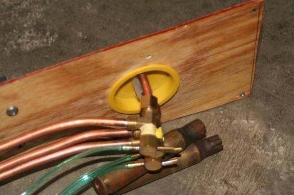

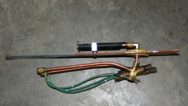

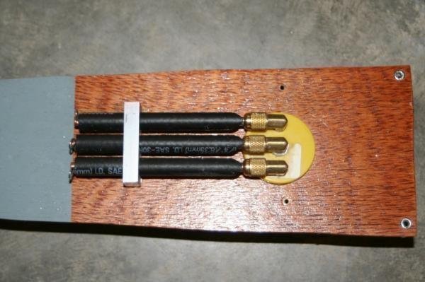

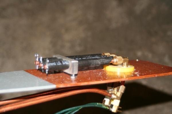

    Thanks for the tips guys!!! I just finished it and here are a few pictures. I did change a few things, one I turned the tubes that lead from the 90 to the "T" 180 degrees. The yellow cap is for plugging a 2" PVC line for a new construction pressure test. The Al bar, is one I milled down and drilled three holes that house brass sleeves and hold the copper tube tight but not to tight. The black rubber hose is gas line from the local hardware store.
    Jeremy
  5. djranier
    Bend the end of the magazines up closer to the deck. That way the BB's roll down hill into the T of the gun. The mags bend quite easily. The way you have them now, they may have a feed issue.
