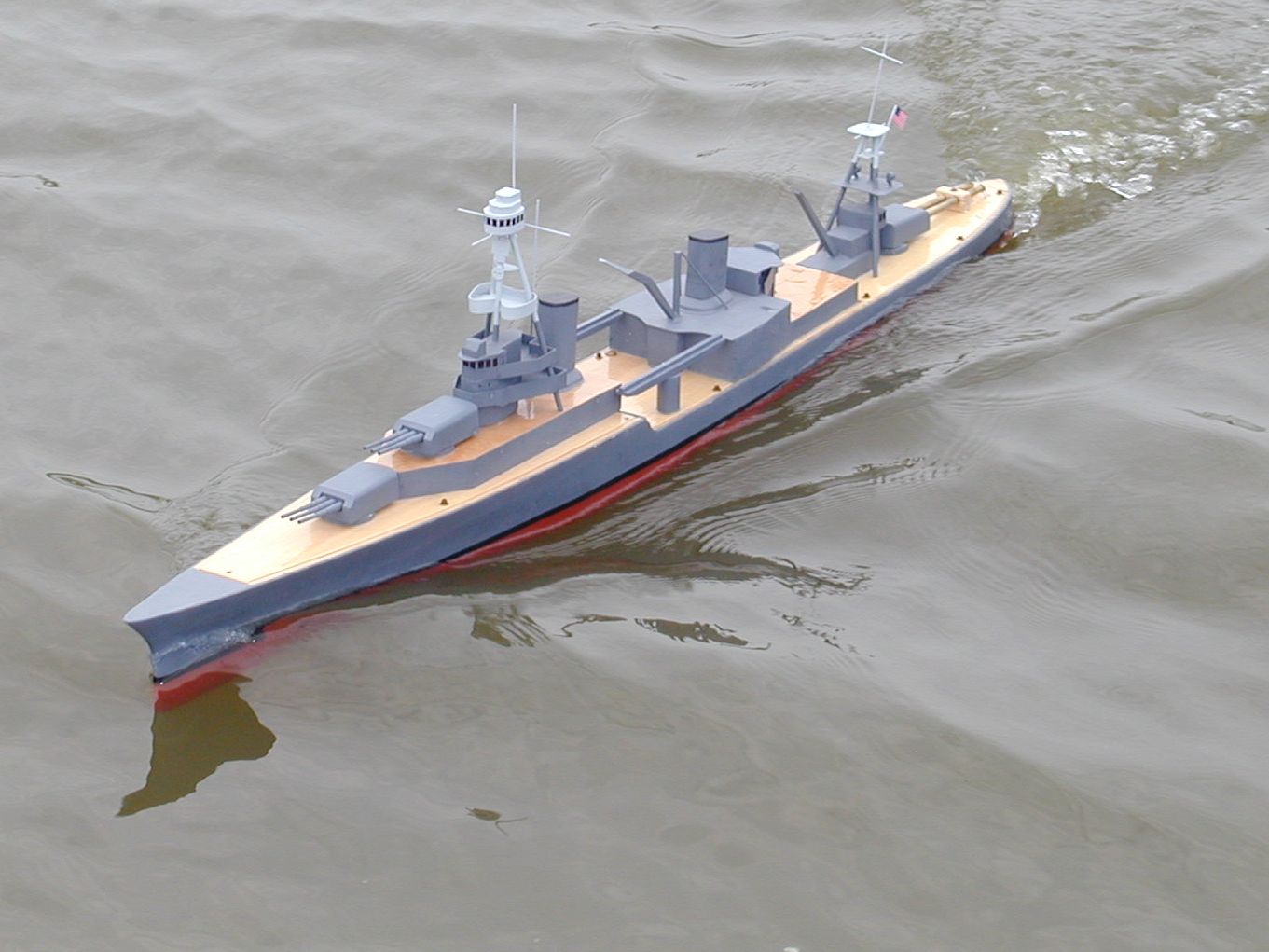

    Ok I see. Thanks Steve! From the picture of the Northampton below (courtesy of Strike models), the stern guns look high enough and and are close to the edge of stern, so I would likely try to angle the guns down as much as I can. Since the Brooklyn has a raised "D" turret, I imagine I might get a steeper angle. Going to look at some plans and talk to Kas or Mark.

    One point about downward stern guns. Make them adjustable so you can play with different ranges. On my Mogador, I actually raised my cannon for a bit longer range. I found I was able to land more shots that way. Admittedly they weren't belows but every hit counts for the team! Besides, getting in to close with a cruiser can be a quick ride to the bottom.

    Oh yes good point. I might start out with the guns parallel to the water at first, and then start angling them down as I get used to maneuvering and aiming.

    I have owned a Brooklyn
    You could get great down angle from the D turret
    TWO things,
    one mentioned above, a down angle shot means you have to hit a one inch target (for a below) with your moving ship on another moving ship!!
    That ship has to be EXACTLY the right distance from your cruiser. (no Brooklyn that I have seen has that set-up)
    Experienced captains have a 20% below waterline hit rate.
    Also cruisers do not like to get close to other ships
    Stern guns can have an effective range of 2/3 feet. MUCH EASIER TO SCORE HITS.
    Second: Center-of-gravity
    cruisers are narrow and tippy.
    2 guns in D turret will be an issue.
    Check-out the video on the IRCWCC site - you will see a Suffren with guns in the aft turret (common arrangement)
    it is on it's side half the time.
    good questions
    kas
    I have battled an Invincible for 12 years.
    Ask around, I think you will hear it was a tough ship to battle.
