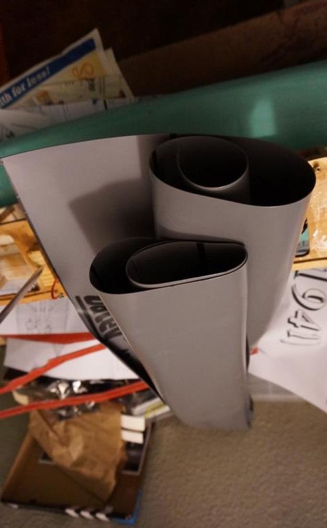

  6. absolutek
    I use shower pan liner. It's like a grey rubber sheet.
  7. NickMyers
    Same here. Wonderful stuff.

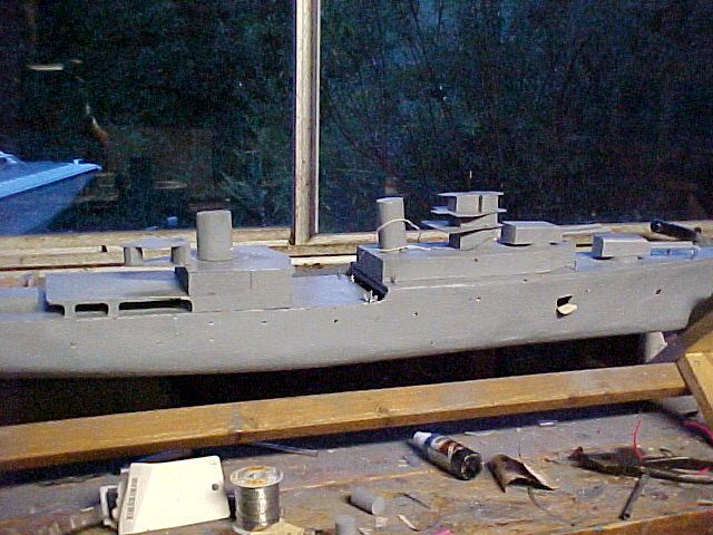

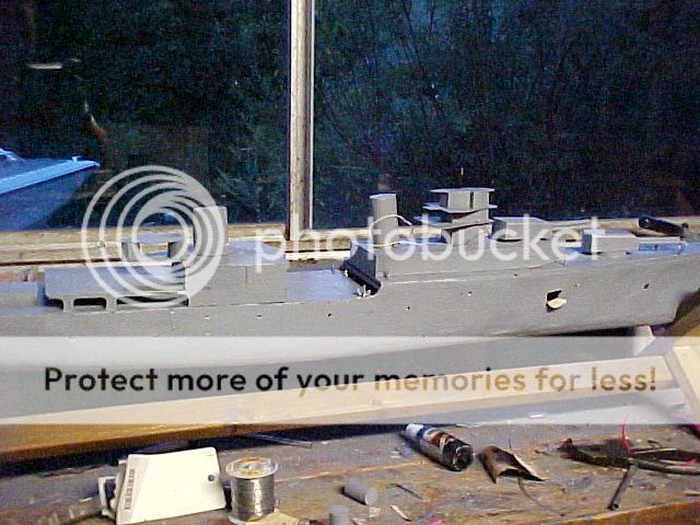

    Exit holes are BAD. Guns generally point down, so an entry hole could be above the water line, but an exit hole will most likely be below. Here is a picture of failed plastic canvas. There are more than one source for the plastic canvas. Some is good. Some is very brittle. STAY AWAY.

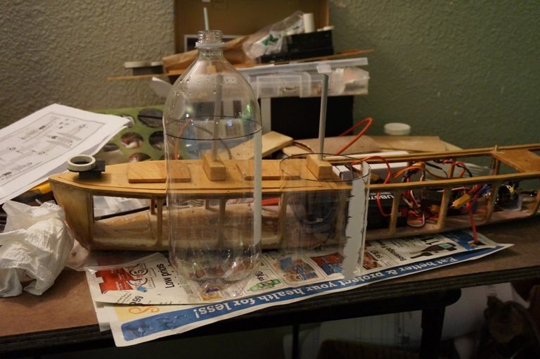

    I've used 2 liter bottles, .03 lexan, .06 lexan (personal favorite) and shower pan liner.
    • Coke bottle works real well and the price is hard to beat. Main issue with it is that it has to be screwed to the ribs to keep it flat and in place.
