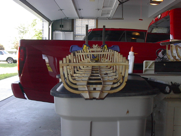

    The 9 oz tanks are 2" in diameter aren't they? If they are, that's what I designed around, twin 2" dia. tanks. (I think there are a couple of different capacity tanks that are 2" in dia.) I even added cradles on the ribs on either side of the water channel to hold them in place. Was going to try to use one of Justin's ideas and use magnets to retain them, I'll just drill some small dia. rare earth ones into the ribs. If you look closely, you can see them in the pic:
    I set some tanks in them, and as small as the cradles look, they really do a great job of holding the tank there, at least on the bench. [:0]
    There is even room between the tanks for additional gear, or batteries or whatever.
