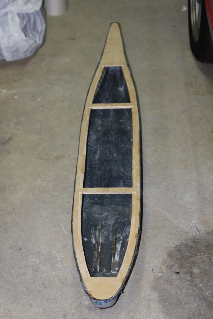

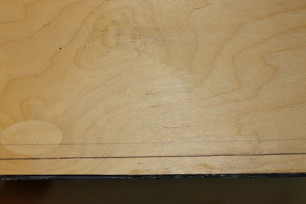

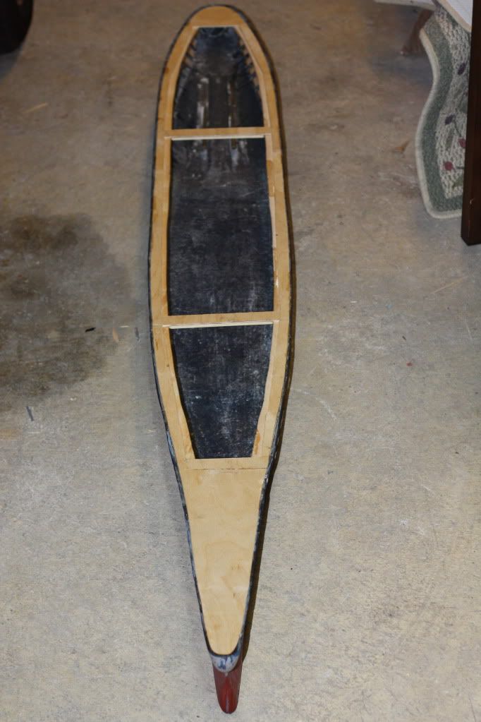

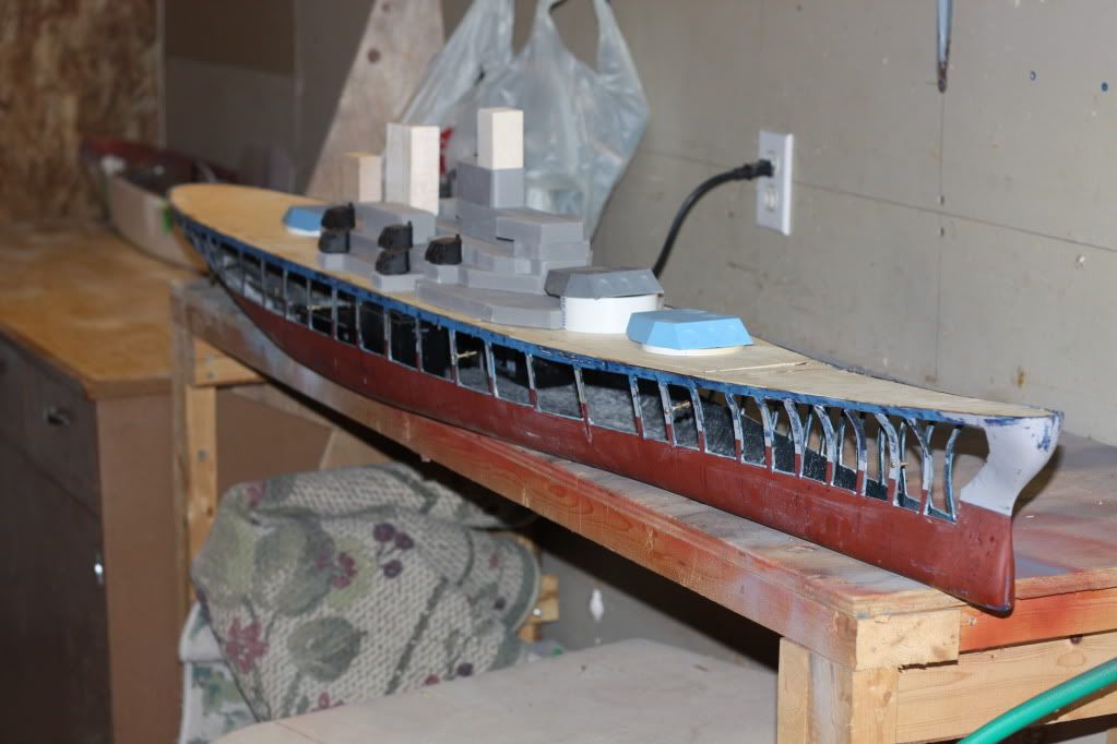

    Hey All,
    Here are a few quick photos showing the hatches and deck as they are now. If the weather is decent tomorrow I will try and resin everything inplace. Comments and questions appreciated as always.
    First, two shots of the hatches
    Shot of how tight the hatches are (midships, port)
    Superstructure put in place for fun.
  11. bb26
    Looking good so far.

  13. rarena
    I might cut a bit more channel in there before you resin it for the deck seal. It seems a bit small at points. It looks very nice. It's good you are all building allied as I think they might need a bit of help.
  14. TheBigStick
    TheBigStick New Member
    May 20, 2010
    18
    Sorry Iceman, what do you mean "cut a bit more channel"?
    Tom
  15. rarena
    Back at the stern where it curves in, your inner channel (where the popped out deck sits on) goes to 1/8 th or so. Seeing as this is the area that will be low or under water during battling or backing, I would want a little bit more sealing there. It does the same in the front but not as drastic.
  16. TheBigStick
    May 20, 2010
    18
    Oh the sub-deck. I may add some additional strips of wood to bring then in a little farther but I want get everything resined in and then see how all the hatches fit. I am also going to experiment with a gasket making trick that a friend of mine taught me. More on that later.
