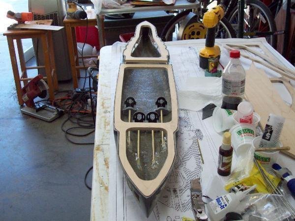

    Well I got started on it Sat, and worked on it Wed and Thursday evening, So far I have been making pretty good progress on it.

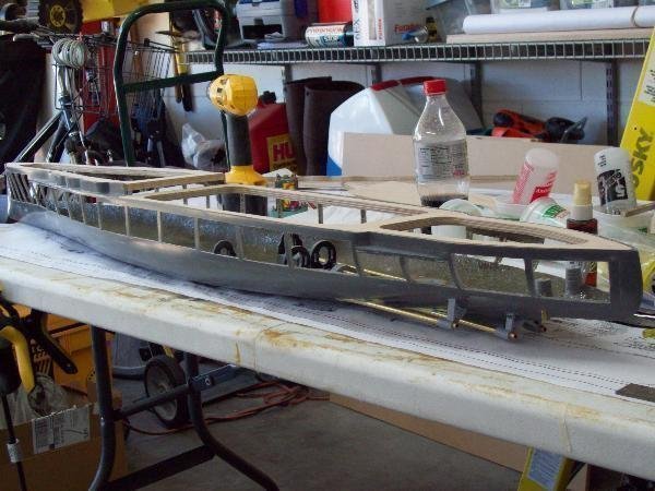

    Side stern view with windows cut out. I got the rapid release dremol bit thats gold color, solid metal for wood, and boy does it make quick work of the fiberglass, did all the windows in just a little over 1 hour.
    This is a pic of the stern, with the gearboxes, stuffing tubes installed. .

    Cool, too bad the picture isnt too great, make sure to post good ones of the casemates to help newbies.

    Nice pictures. She's going to be an outstanding ship.
  5. SnipeHunter
    Nice pictures, you dont waste any time working do you.
    Is that the boat you're going to bring to NATS this year??
    Just wondering how long are your prop shafts? They look really long, not that it really matters, Im just curious.

    This is the one that is going to NATS, if I get it finished. I plan on going over to Rick's again tomorrow to do some more on her, then wife will be out of town on Sunday also, so I shound get a bit more done then also.
    I made the subdeck 3/8 inch, and plan on routering out the 1/8 lip all around the inside edges for the deck. That way the sides will be a solid peice of wood and may hold together a bit better.
    The stuffing tubes are 12 inch long, I need to go back a bit, since I plan on dual sterns, with a rotate in the elevated stern turret, and do not want anything in the way.

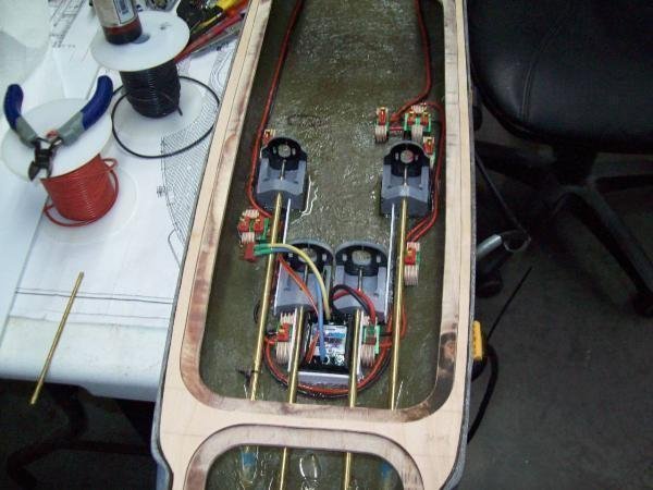

    I helped Rick with the first part of his internal wiring, and it came out great, I have the same planned for this one. Using the deans connectors that are mounted on the circuit board, and then mounting them under the cross beams, makes for a super clean install. Found them on the tower hobby site.
    She sits very low in the water, I had her in the tub yesterday, and it looks like 24 pounds will be what I shoot for.

    The Dremel EZ is great, I was using the EZ cutting wheels on it, but today at Lowes, I saw one that was all metal, and gold in color, says it to cut wood with, but it also cuts fiberglass like you would not beleive. Also I feel safer using it because it wont blow apart like the regular type. Just make sude you have your safety glasses on no matter what when using one to the cutting wheels.

    Thanks but I guess I wasn't too clear. I meant tips for cutting the subdeck itself to fit the shape of the hull. I had erroneously assumed I'd be cutting windows in the hull first and THEN installing the subdeck. However, in an uncharacteristic move I actually read the included BC instructions before screwing things up and saw that y'all recommend installing subdeck first, then cutting windows.
    I knew I'd have to fit the subdeck to the hull before installing but was a little surrpised to see how much cutting I'll have to do to fit to the lines of the casemates.

    I'd use a dremel with a drum sander to get the subdeck to fit right.

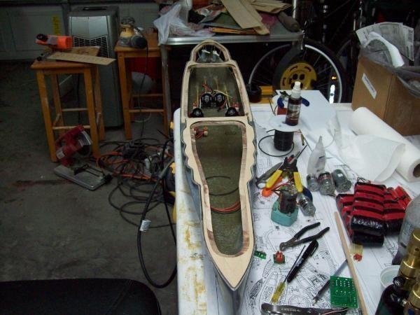

    Spent a good 6 hours working on it today. You can see the routered deck edge, came out much better than I thought it would. From now on this is how I will do all my subdecks.
    Looks like Christmas with the colors. Started wiring, got a good amount of the power system wired up, still need to do the pump system, and I need to decide where the receiver is going to go, so I can finish the wiring tomorrow. As you can see I'm trying the deans connectors that are mounted on a mini circuit board. I made mounts out of ply and gluded them down. Will seal with west systems, and then will cover with the concrete sealer. I will let everyone know how it works out. It will give me a really clean looking system thats for sure.

  16. djranier
    Well another 4 hours tonight, boy time is flying, got the wiring all done up forward, and all the mounts sealed up with West resin. Tomorrow, the rudder servo mount, and the forward for and aft, armour wall. Its also where I will mount the receiver, TD pump, and motor control, and firing boards.
    Won't pour concrete sealer in until that is done, and I have the mounts in for the solenoids, and expansion tanks. I also plan on using twin 3.5 oz bottles in her. With the motor mounts so far forward, only a 3.5 oz bottle will fit, one on each side. Plus the added benefit of increased CO2 flow from the 2 regulators, so that they will not freeze up so fast. The batteries fit right between the bottles. I plan on using 30 amps worth, should last for 2 sorties with no problems.
