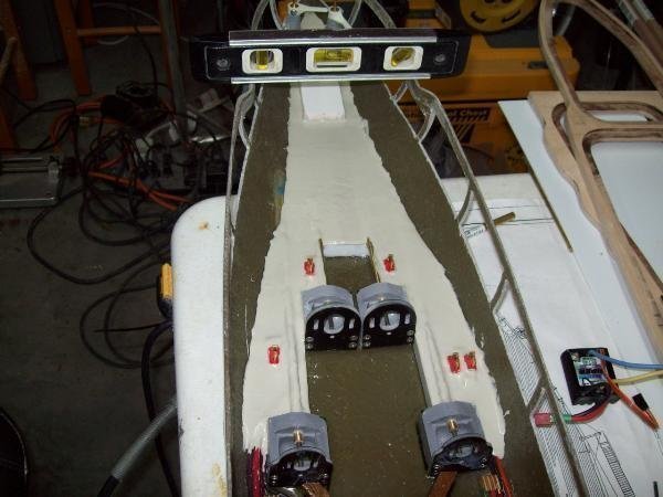

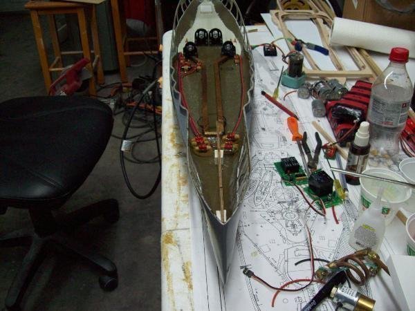

    Well I got some more done last night, and this evening. You can see the Deans connectors sticking up just as I wanted them too. I poured in the Dap sealer, as I stated earlier, it was not throughly mixed in the tube, and does not self level as well as the other 2 brands.
    Here is a closer view of the stern after the pour, thats 10 oz worth, looks like I will only need 4 tubes total, which is not bad, just 2 1/2 pounds, and I was allowing for 4 pounds.
