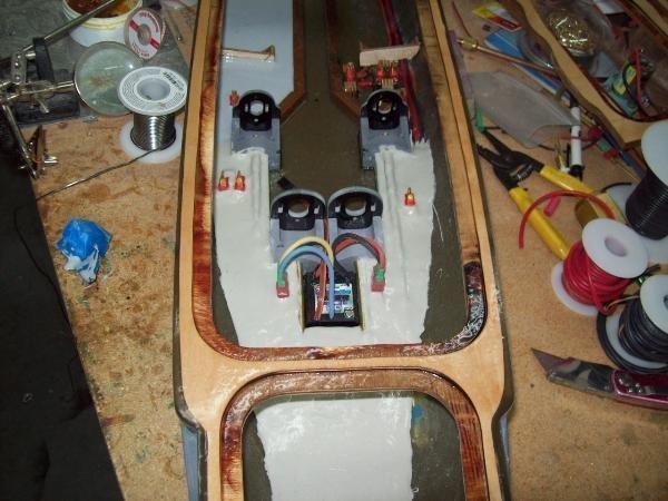

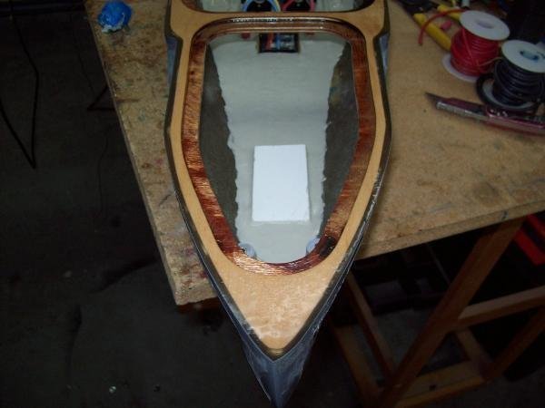

    Well I got a bit done today. Sanded down the deck edge level all around, and sealed with West systems. Looks pretty nice I think, and then poured the Port side PL concrete sealer.
    Don C is having surgery Tuesday to have his knee replaced, so I took his ID yeaterday, and plan on working on it for him. He wants it wired the same as mine.
    So today I got it all wired, and the stern poured with the concrete sealer. He will be layed up for the next 2 to 3 weeks before he can work on it again, so by then I should have all the concrete sealer done, and have his subdeck installed also. Then I will make both of our deck inlays. So it will be in good shape for him when he gets ready to start building again.
    Here is my forward subdeck installed, I will give it a light sanding and another light coat in a few days.
    Stern deck, I just like how it came out. Too bad I was not better at applying the resin, whats the secret to have it come out super smooth like glass, mine is OK, but not great.
    More of the Subdeck install, and what I was trying to do with the wiring. You can see the ESC installed between the shafts, with the power wiring hooked up, about as clean as you can make it. Its sitting in its own sump, which can drain to the pump.
    John Bruder likes this.
