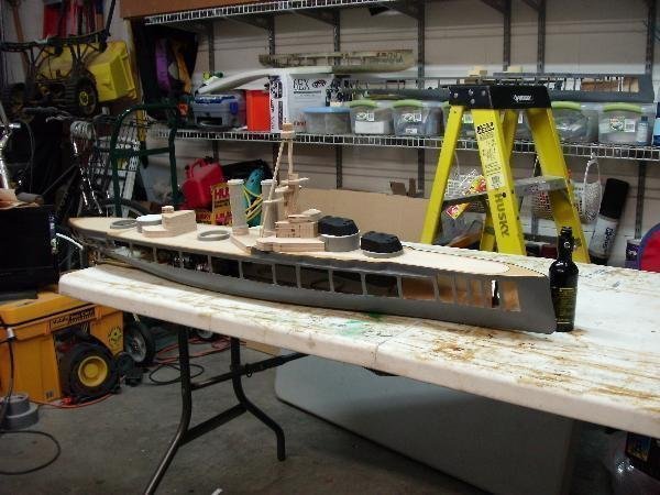

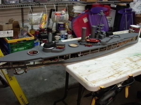

  4. djranier
    Worked on the Iron Duke's super this weekend, the prior two weeks was spent getting the PE ready for the Bruhaha battle, so not much was done on the ID.
    I need to give it a coating of the west resin, and then the super will be done, and ready to attach to the deck after its also coated. It has a pair of the Grey Wolf squadrun ID foam stacks to save weight.
    You can also see a new 3.5 oz bottle that BC is selling with the new Aluminum valve, its 4 oz lighter than the old brass style. So I will save 1/2 a pound using 2 of them.
    By next week I should be working on the CO2 system, and Solenoid wiring. It looks like she will be ready for the Hagerstown battle in May.

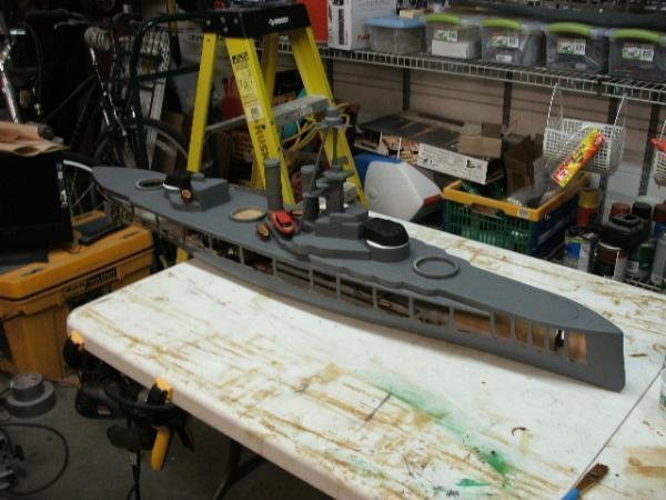

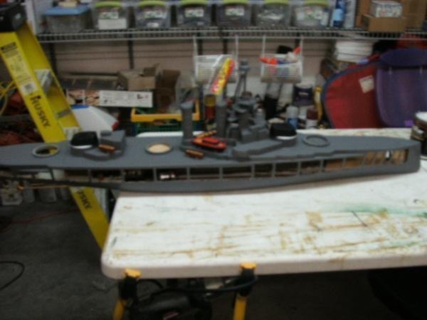

  12. djranier
    I got a little more completed on her. Finished the super, weights less than 1.5 pounds.
    First picture is a little blurry, sorry. Got her painted grey, just need to do the gun systems now.

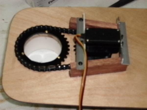

  15. djranier
    Don is getting better, now he says his left knee hurts worse than the right, which is the one that got replaced. But he says he's going to wait till after Nats to get the left one done.
    I helped Don with his super and deck panels yesterday at Rick's, and today I worked on my stern rotate turret. Got it working very nice. Just need to clean up the aluminum corners a bit, and put in the 2 rear servo mount bracket (2 4-40's with brass anchor) hardware, and then I will start on the forward rotate tomorrow.
    The bottom of the servo is only 1 1/2 inches down from the bottom of the deck, so it does not interfere with the motors below it.
    where did you source those gears from, David? Ship is looking fantastic!

  18. djranier
    Clark
    The gears and chain came from Servo city. They now have a gear with a spline attached for a Hitec, or Futaba servo, what you see on my Hitec retract servo in the picture. The other gear I cut the center out of it to attach to the bottom of the center of the barbette with 3 screws.
    A 24 spline on the servo, 34 on the barbette, with a 180 deg Hitec retract servo, and chain. All from Servo city. It runs very smooth and quiet.

  20. CURT
    That's a great rotate system there. I like how it's setup. Very clean and simple.
