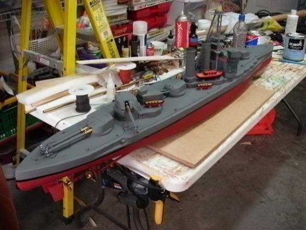

    Well I finally got some time to work on the boat, it may not make it to Hagerstown unless I get it all done in the next 10 days.

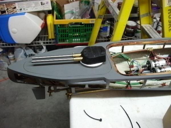

    Built and installed the stern guns, they are rocking.

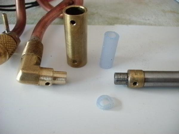

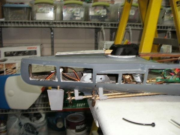

    I built some Geek guns, tired of tweaking guns. From the turret to the end of the barrel is 5 inches, MWC allows for 6 total, so I'm in good shape. Making the side mounts about 1/2 a inch shorter. I still need to install the pump outlet also.

    Can you show how the Geek Breech guns were constructed? I'm interested in the breech mechanism. I see the o-ring breeches all the time, but I've never seen an in-focus photo of a geek-breech gun.

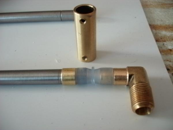

    I did mine a little different than what is shown. I machined down a 90 fitting that BC uses for their guns, and I'm using steel rifled BB barrels for my barrels. I was suprised at how much straighter and consistant they are over the regular barrels.

    I was making the side mounts today, and took a couple of pictures of the Geek guns.
    Apart.
    Almost fully assembeled.
    John Bruder likes this.
  8. Kotori87
    Great! Now I get it. Thanks!
  9. djranier
    Worked on the ID fro the last coupple of days, I think she will be completed tomorrow if all goes well. Here is a video I made last week of my rear cannon.
    http://www.youtube.com/watch?v=NMtnzK2UdNs
    Enjoy. [​IMG]
  10. djranier

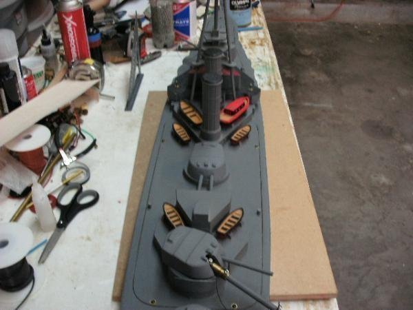

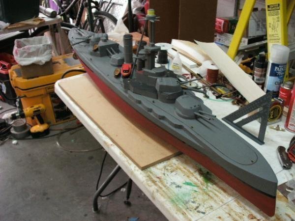

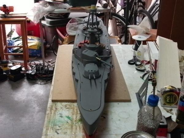

    She is ready for Nats finally, for a British ship, she is really not too bad looking. I had my daughter paint the boats to add a little color. Now to check out the Sri and make sure she is ready to go also.
    I had to add more deck hold downs after the Savannah battle, I sank a few times, but not due to damage, the for and aft deck was letting in so much water she was sinking. Added gasket material, and tripled deck hold downs.
    Side mounts are at 20 deg down angle, Don thinks that is best, but I think they need to come up a bit, but only another battle will tell.
