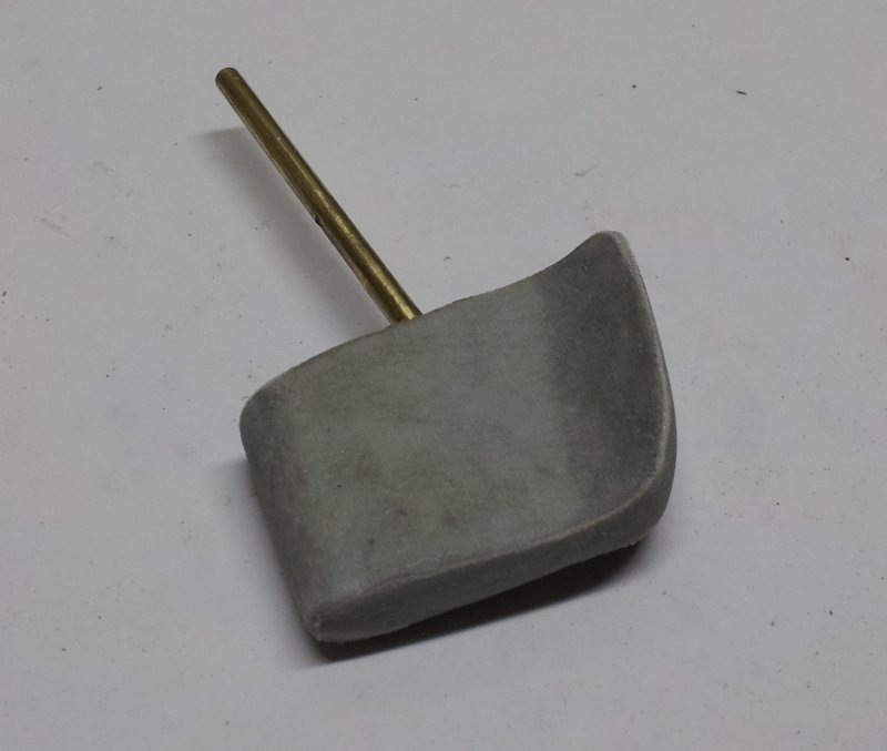

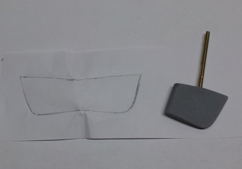

    Thought I'd jazz up the rudder on my Mogador. The stock BC rudder is a fine looking piece of steering equipment but I thought it could use a little flare! Here's a conversion to a Schilling rudder, aka a fishtail rudder.
    The stock rudder outline is traced to a template.

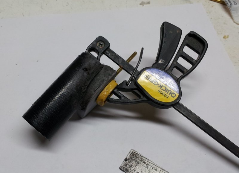

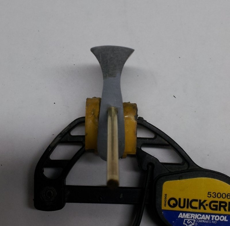

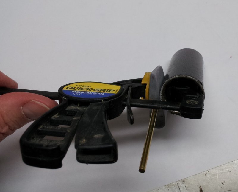

    A socket wrapped in Gorilla tape is used as a form.
    JB Weld epoxy putty is kneaded up and pressed into the cavity formed by the socket.
    Once the putty sets up a bit, the socket is carefully removed. If you haven't guessed by now, the JB Weld doesn't stick to Gorilla tape.

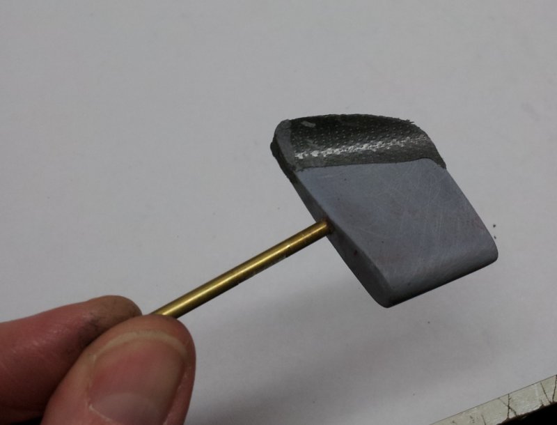

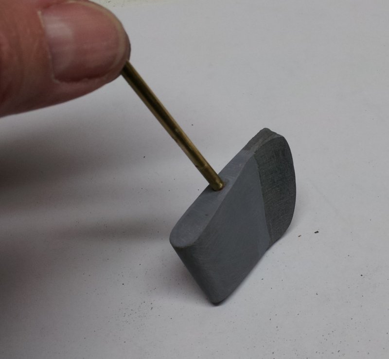

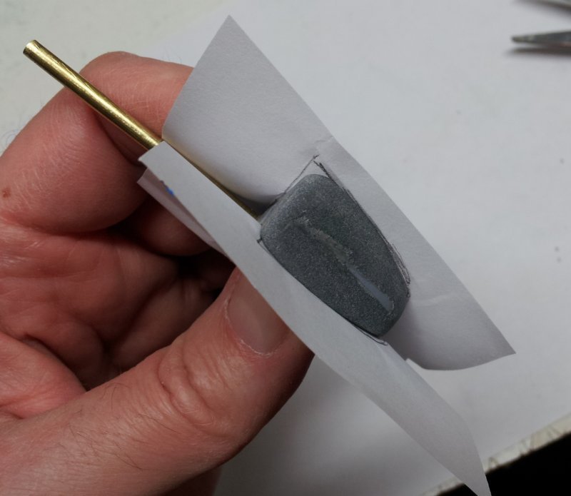

    Before the putty sets all the way, it is sanded to shape.
    Repeat for the other side.
    The profile template is used to verify that the rudder size was not increased.

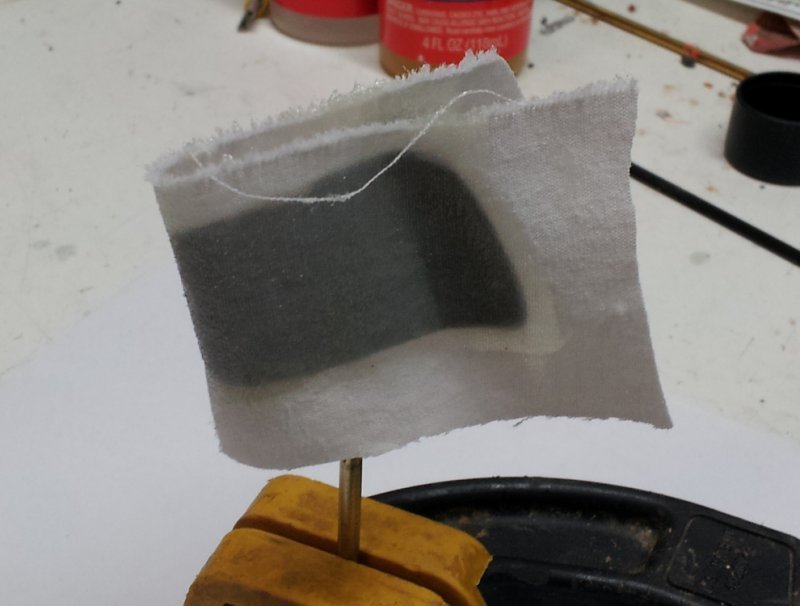

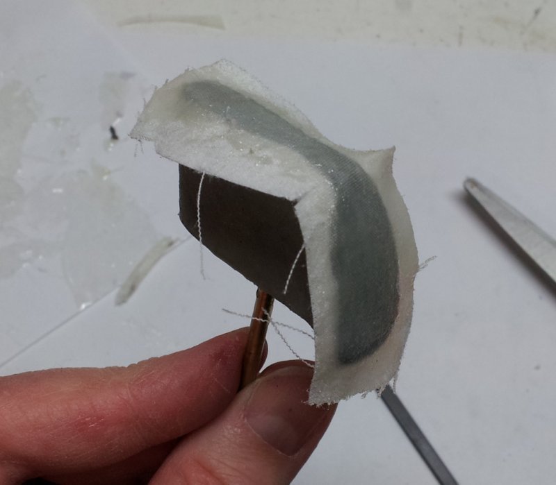

    Not trusting the putty's bond to the resin rudder, I laminated a layer of linen over the rudder with a fast set epoxy.
    Trimmed and sanded.

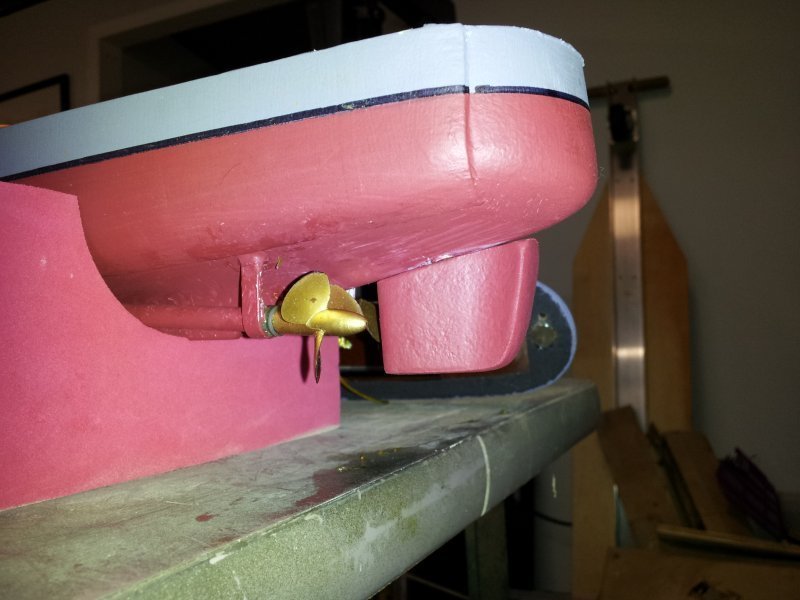

    Painted and back on the boat.

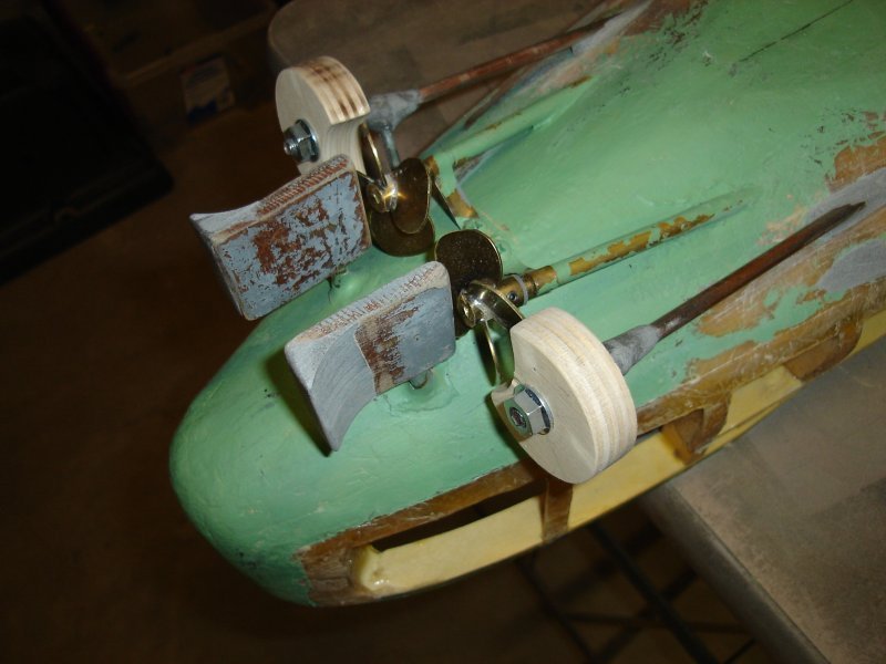

  17. SteveT44
    Split Shilling double rudder setup.

    98

  19. Tugboat
    The unpleasant news is that drag discs have to be circular discs, and there has to be something prop-shaped on those shafts. The prop-shaped object can be a piece of wood cut to resemble a prop (doesn't even have to have pitch), or one of the plastic 'drag props' that have been sold over the past few years.
    Not down on ya, Steve, just wanted you to hear it before you showed up at Nats with those drag moons :)
    For the record, it looks awesome! Not legal, but totally awesome. :)
  20. SteveT44
    This is an IRC boat. I think things are bit more loosy goosy regarding drag props. Any comments from the IRC folks?
