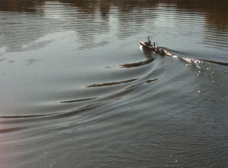

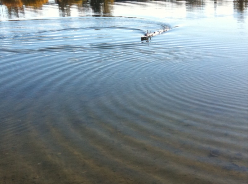

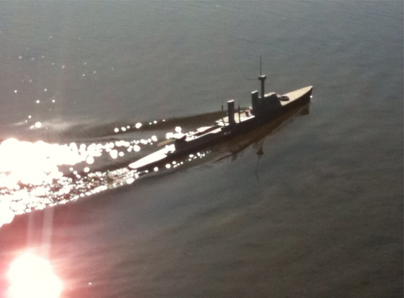

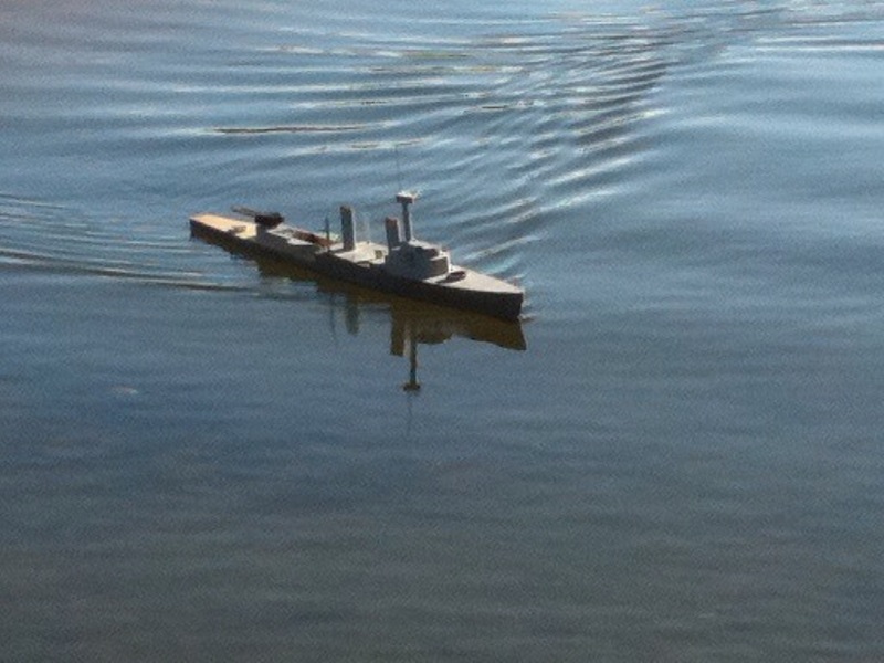

    And for pictures...

  6. GregMcFadden
    2,567
    Yes. that is the advantage having a guy you know with a laser cutter... all the superstructure was laser cut. bit of a dog on turning, I will probably make a new airfoil shaped rudder for her one of these days. few details left, still needs the air system installed and a few bits on the deck installed.
