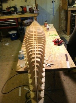

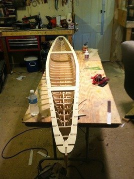

    This is my build for my 1/96 scale Jean Bart (bulged) I had thought about submitting for a new screan name "Darth-Frog", but figured somone would out me so here it goes, hopefully I wont crash the site, this is my first time uploading photos on my own

    102" Long oa, with a Beam of 14.5"
    Hokey Smokes, Bullwinkle!
    What kind of plywood are you using for the subdeck in the wide part?
  7. glaizilla
    glaizilla Active Member
    Sep 24, 2010
    375
    Baltic Birch, I think its 5 ply

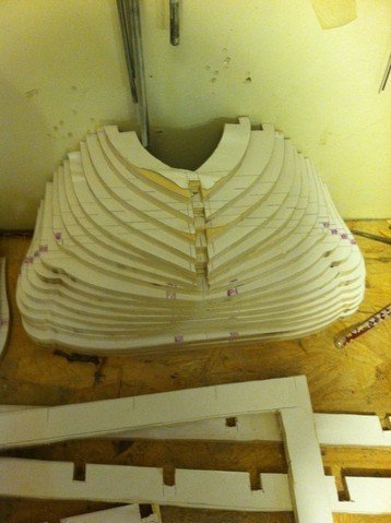

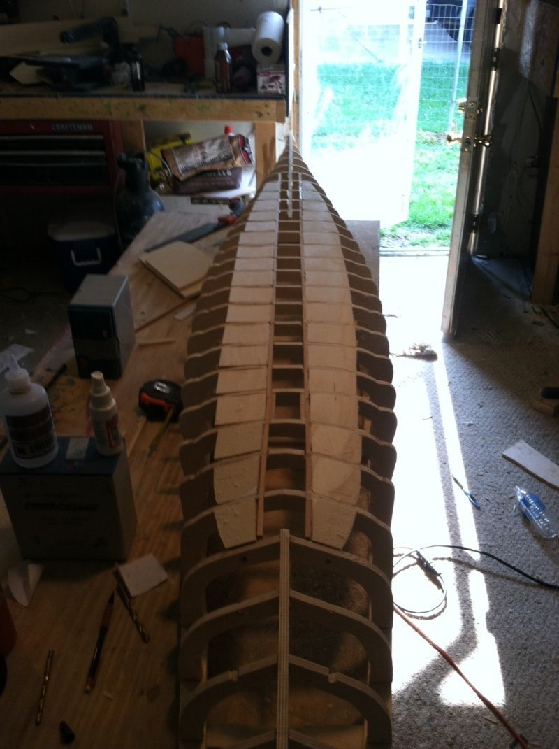

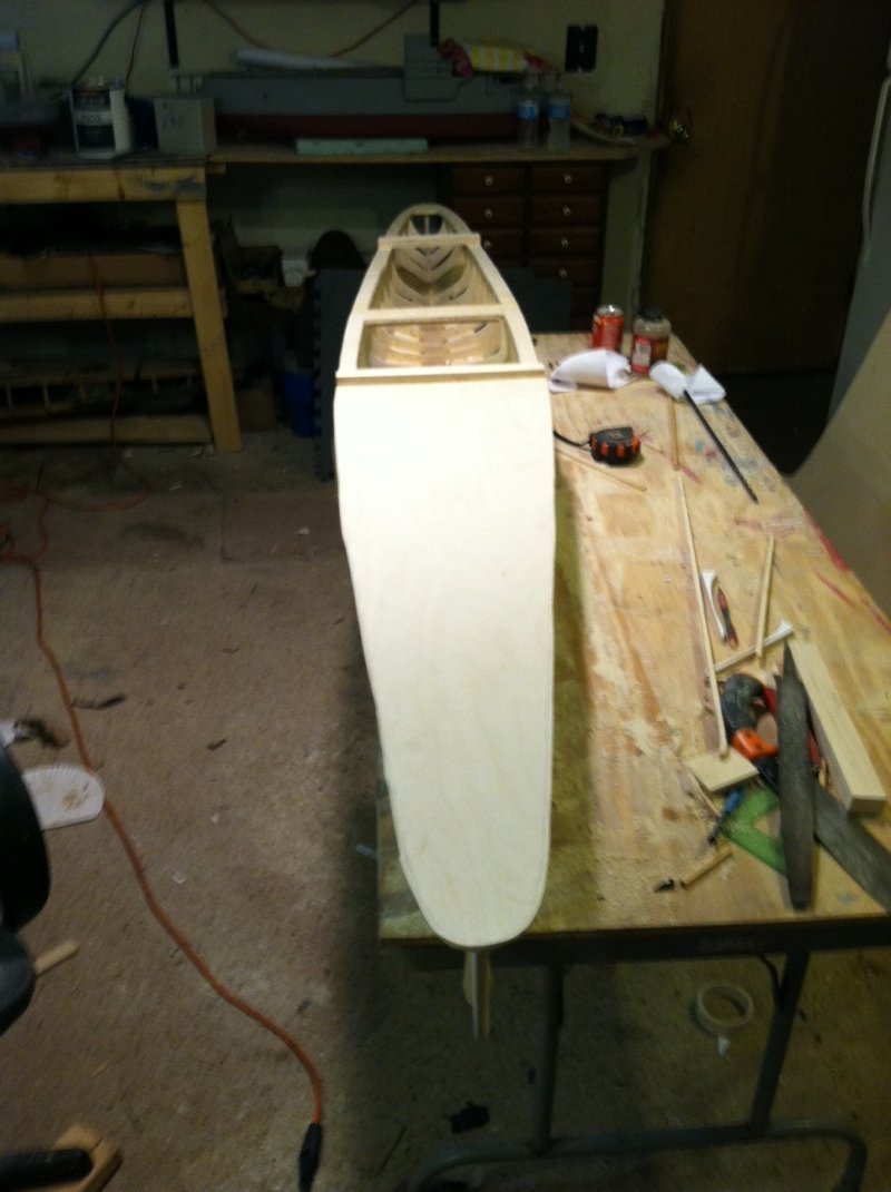

    I spent this morning filling the bottom of the hulls impenetrable area with hardwood blocks, the sides and the contours of the bulge will be filled and sanded. I plan on wraping the bottom of the hull once the blocks are sanded to the proper contours. I ruff cut the deck for the bow, more sanding!

    I would like to fill most of the voids with expansive foam after the key components are in place, in the hopes of keeping it from completely sinking. but with such a large ship, I am not sure that it will work out that way. We are currently looking at a recovery raft with a small winch to lift large ships from the bottom of the pond,
