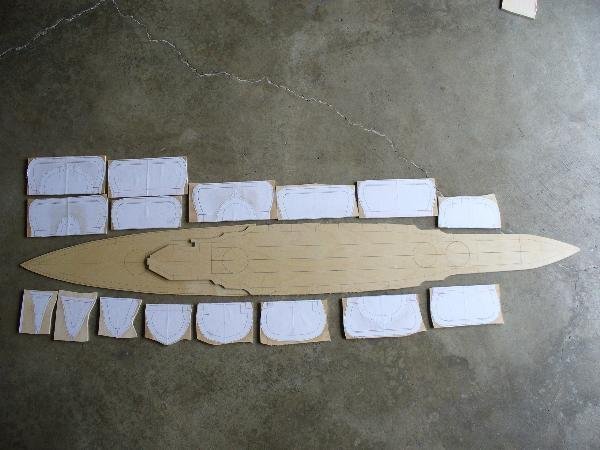

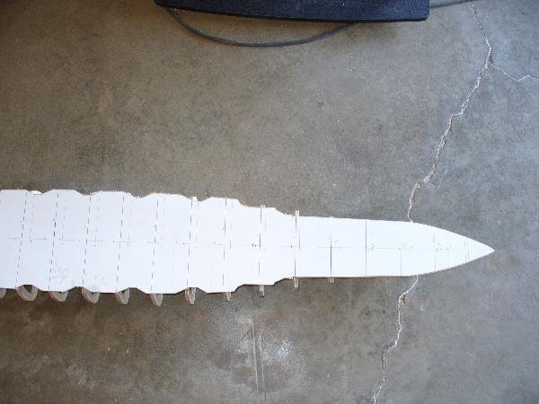

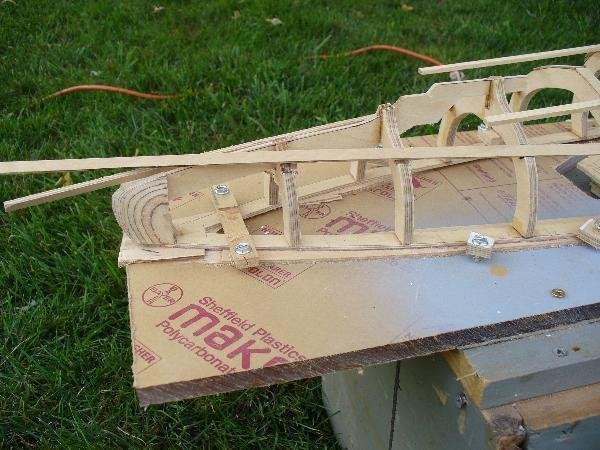

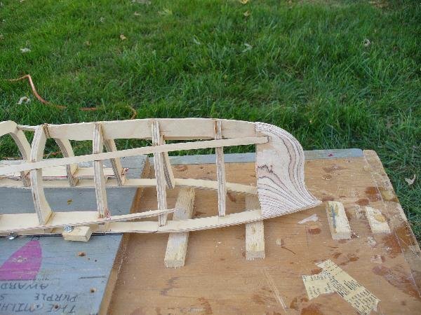

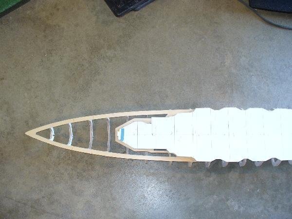

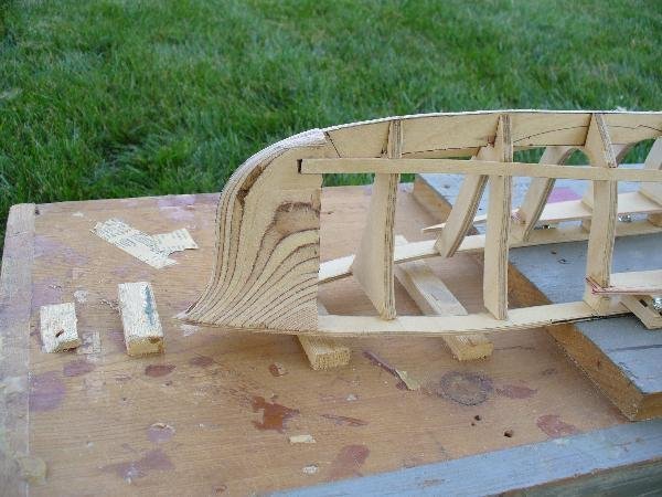

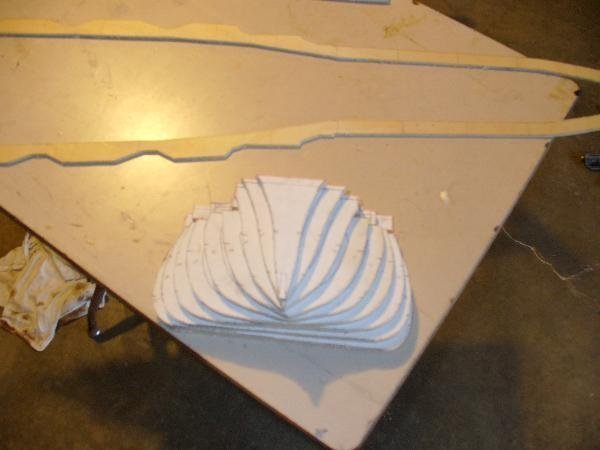

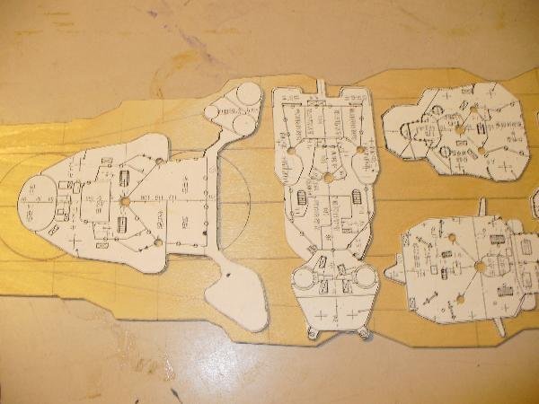

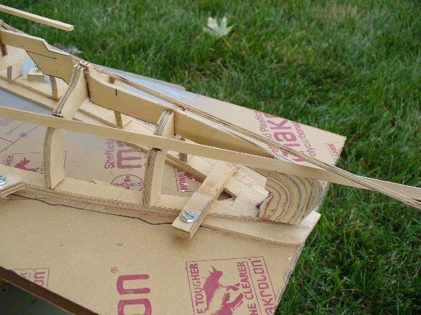

    What do you know? Yet another project underway. This is IJN Kirishima. I wanted to do something with wood. The way we built ships when I first started in the hobby.
    Kirishima is 4.5 units, 24 seconds over the 100'. Should be a very nice ship when completed.
    The bow and stern is made of birch aircraft plywood. They will be sanded to their completed shape after the ship is removed from the building board and the cap rail is added.
    More to come.

    Wooden boats are awesome aren't they? I especially like carving the bow and stern out of fine plywood. You can literally see the hull lines as they come in. I will follow this thread with interest.

    The nice thing about building out of wood is that the ribs are already beefed up because that are made of wood and the bow and stern solid area when made from the aircraft plywood are very durable. You don't get the area damaged from BB's because of them hitting gel coat.
