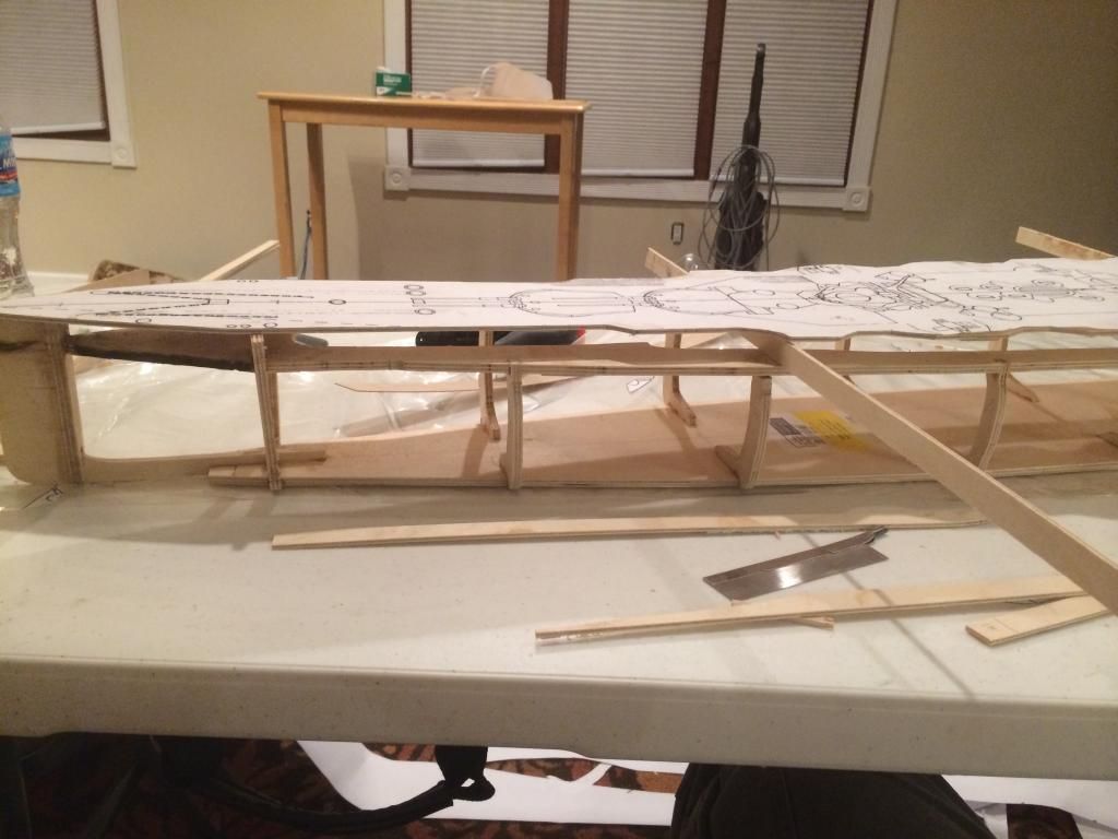

    i enjoy laying down hulls but abhor placing down the stuffing tubes and rudders for some reason, fedex is slow, and wooden boat hulls are just pretty even half finished.
    I have gotten the keel cut out and started to plan the weatherdeck, casements, and superstructure and have questions about how i should go about doing so.
    the keel is 1/4 plywood and is butjoined with reinforcement over the join (1/32 spruce) if i had thought abit further ahead i would have gotten 6 sheets of 1/8 and just made my own laminate 1/4 for significantly more rigidity but it seems to be holding up to my current handling and the keel can always be glassed.
    ribs are slotted into the keel with a split in the center for waterchannel.
    weatherdeck will be 1/4 and extend to just inside of where the casemates are visible to give plenty of room to attach the stringers required to build the deck up the 1 inch or so. and here is where i begin to ask questions of those who have built ships and have fully armed them already.
    i am considering making the upper casement deck out of 1/8 and the superstructure out of either foam or plastic. i am considering cutting the entire upper casemate deck around a single rim and running some 1/4x1/2 balsa strips underneath it so i do not have to router out the rim. this seems to be working fairly well on my shimakaze but the weights are significantly different. i plan on having the rim at least 1/2" and finding some place i can install some lockdown mechanism discretly up near the superstructure (simple bolt through a crossbrace and a nut at the top should suffice)

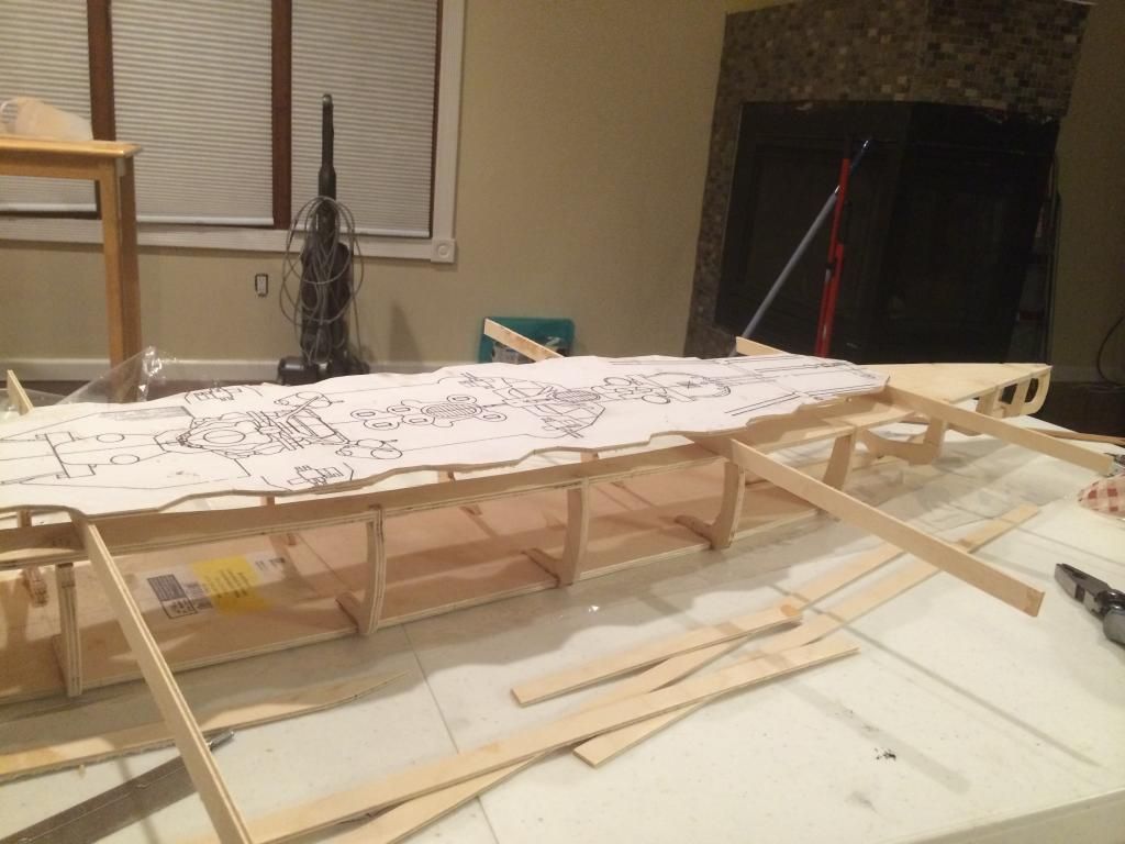

    casement deck is 1/8 and the rim has not been cut yet. still trying to figure out how i can cut it with the tooling i have. my scroll saw does not like the length of the deck sadly.
    if i am reading the rules correctly i need to make certain that the inset areas are penetrable does that include the areas where the guns sit or not. rules are somewhat poorly written for new members.
    does the entire lower deck need to be 1/8 or is taper acceptable.
    Can the blade on your scrollsaw be turned 90 degrees to the side? Many saws have this capability, and it lets you do any length piece that you can hold on to :) That's how I do subdecks with my scrollsaw.

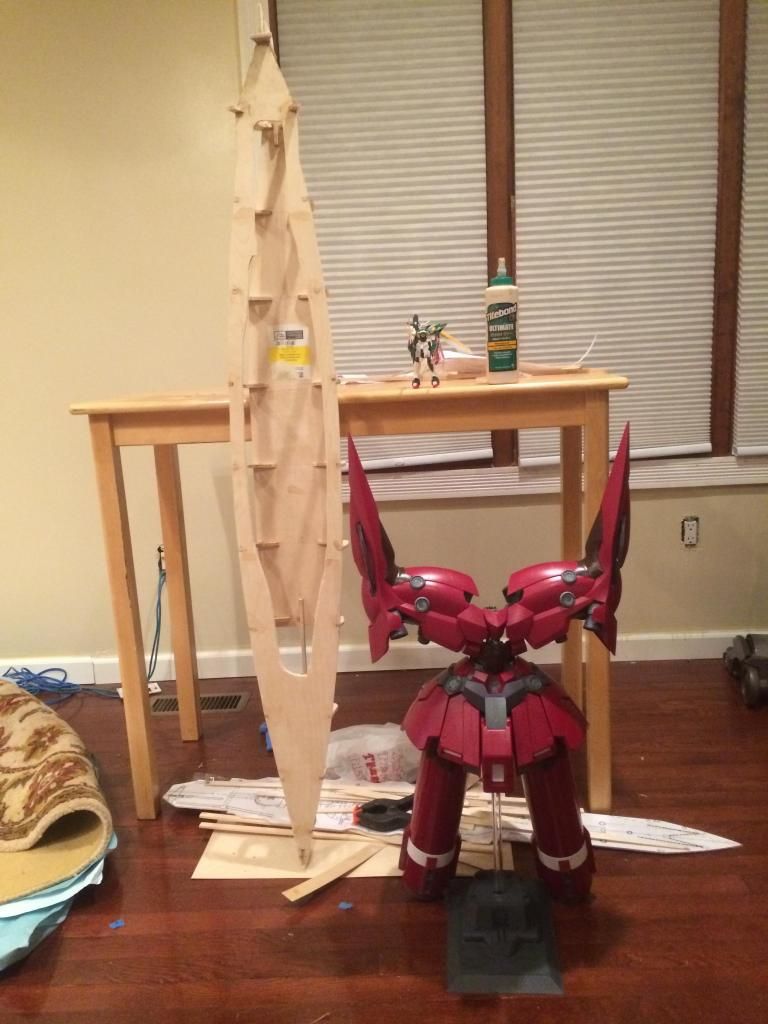

    on a not entirely related note i finally finished a 1/44 scale model of a different persuasion.. well at least got further on it. it still needs arms but the paint i want for it i can't get until january or so due to freezing. by far the largest plastic model i have built and here are picture of it next to the 1/144 kongo hull
    little guy on the table is also 1/144 and from the same series but not related. not finished the one that actually goes inside the red armor.

    and my scroll saw will not turn sideways. cheap porter cable freestanding unit. but i have a nice jigsaw and some fairly thin blades that worked fine on the 1/8th im using. going to have to put some stiffeners on the underside of the deck and slot the crossbraces but not a huge issu.

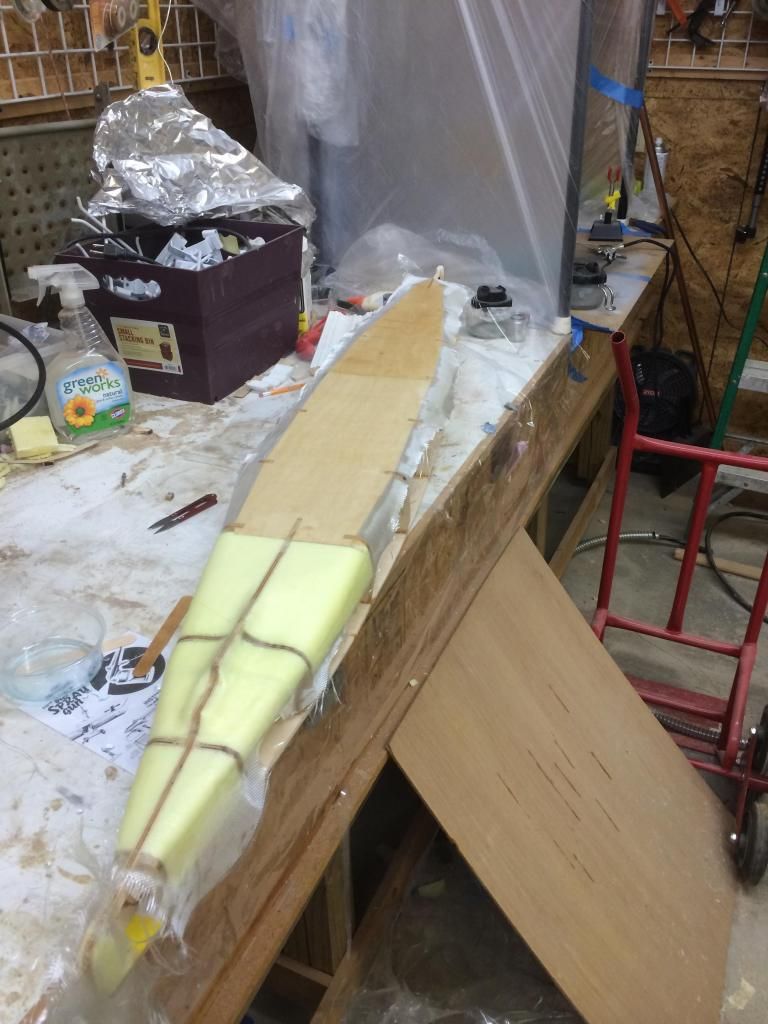

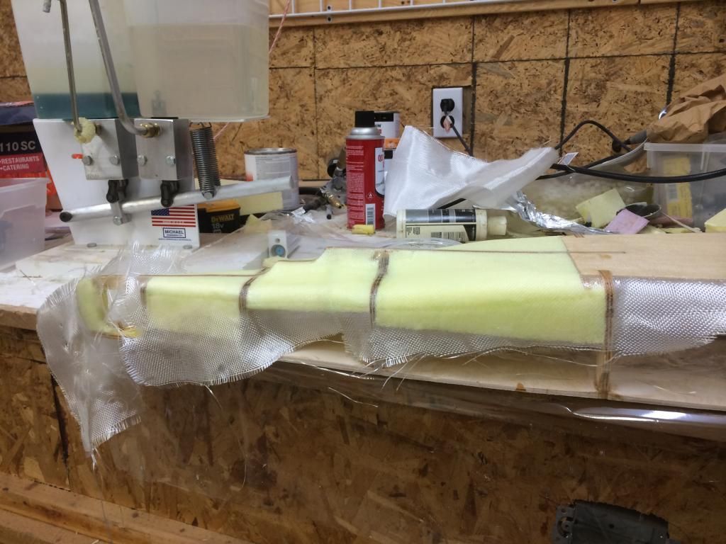

    put standard spray foam in to form a water channel and it is gonna be a pain in the ass to cut right but meh.
  17. thegeek
    Watch out for some spray foams, they aren't closed cell and will turn into a sponge.
  18. ish311
    ish311 Active Member
    Aug 18, 2014
    527
    North Central Florida
    seems like i got the sponge kind. can be fixed and or coated in epoxy
  19. thegeek
    If coated the slightest void will pipe the water in, you will have to rip it out (you may be able to solvent it with Gasoline or some other liquid solvent)
    Got the foam out. not hard for once. (don't recommend using gasoline to clean only diesel and kerosene) may or may not have the water channeling done by saturday. regardless i should have more of the SS done then.
