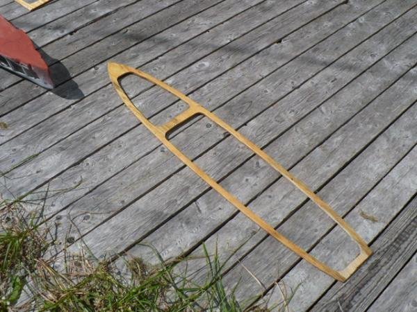

  19. CURT
    I finished resing the Konigs wood subdeck sections today. Got to move fast to get the stinky stuff done before the weather cools.
