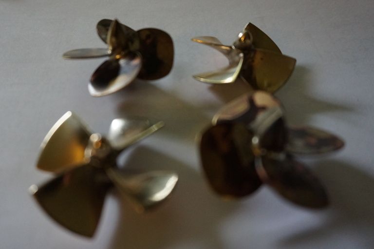

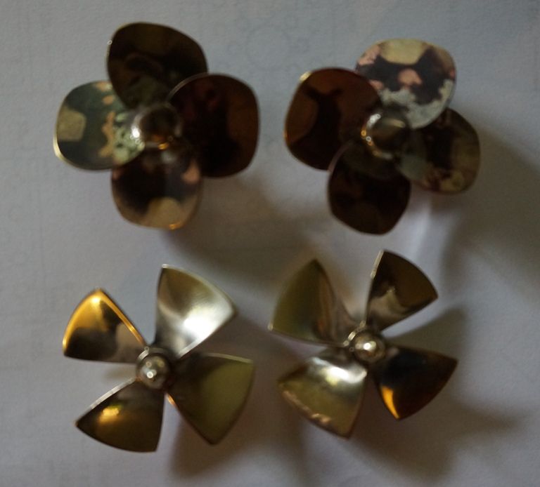

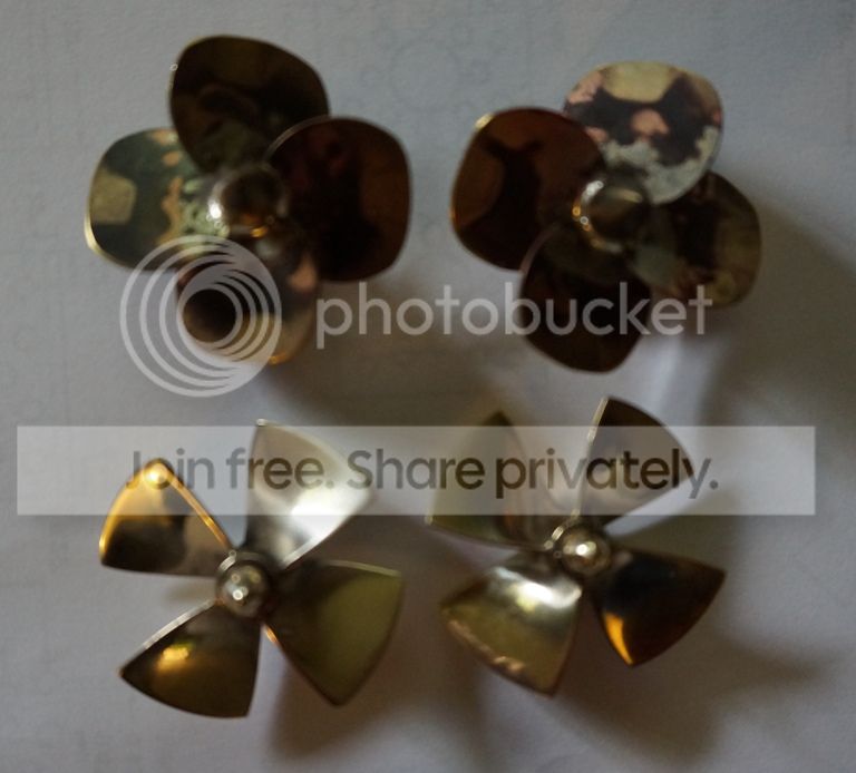

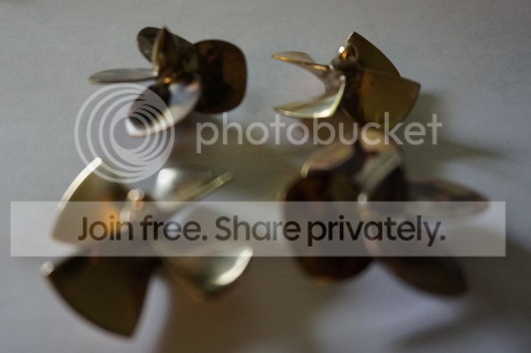

  12. Maxspin
    Maxspin -->> C T D <<--
    Jul 30, 2014
    634
    Yelm, Washington
    My new Kort Props next to a set of the Strike props. I have always use Swampworks props in the past. They work good, but tend to throw blades. I have been told that Stephen does a better job soldering/braising. I wanted to try some cast props for the Barham.
    I have a new set of Strike props for the Washington for comparison.
    I will need to cut the ends of the hubs off both sets.
