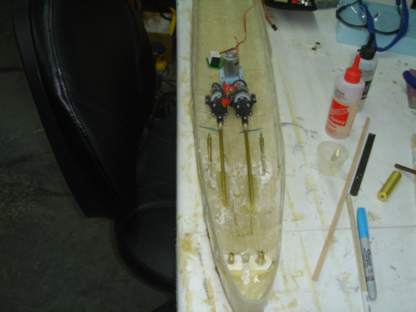

    Internal drive system aligned up. Having your own lathe sure helps, it took me about 2 hour's to make up the 8 stuffing tubes, for the shafts, and the 4 stuffing tubes for the rudders for both ships. Since the gearboxes are 2.3 to 1, I plan on using a speed controller for both these ships.

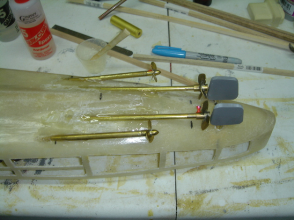

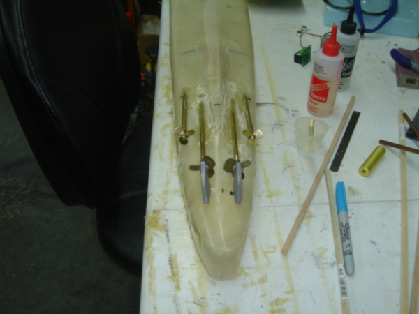

    External drive, props and rudders. I installed the outer shafts a bit out, to ensure that I can get the 1 1/4 drag disks on.
    You can see I installed the rudders as close as I could get them to the props. Both hulls have been done the same way. They are BC Suffern rudders, which work well for both ships.

  3. djranier
    I got some brass bushings from SkyCraft in Orlando for the internal tubes, but the internal holes are too small, so I just drilled them out on the lathe with a #30 drill bit, .1285 inch. Then soldered them on, they work great. The tube is 7/32 in.
    The outer shafts I had some larger bushings, but they don't finish up as nice. They are 1/4 in.
    I use 1/8 shafts in both sets.

  10. djranier
    I finished installing the engine mounts, and all the mounting blocks for all the internal gear, and poured the rear cement sealer around the stuffing tubes, and rudder gear.
    This time I will take the time and do the side to side tilt, during the week, and do each side one at a time. So far the rear took 4 ounces, so I have about 1 pound 6 ounces left I can still pour if needed. I think 1 pound will do it, since it is only 1/4 inch deep, sloped down from the sides.

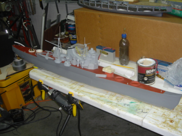

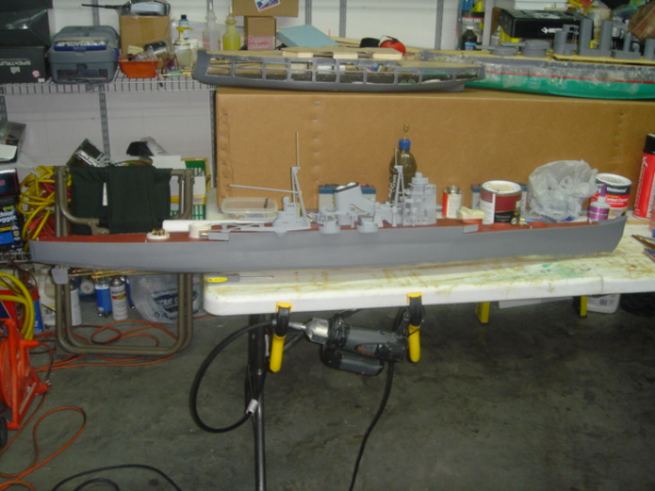

    Sheeted her last night, went to Ricks today, and got the pump mounting, outlet, and hose installed. Still need to install the guns, turrets, and paint.
    She hit the water today, was a little fast at 20 sec, added the speed disks, and dialed the forward speed down to 90%, and she hit 23 with no problems, sweeeet looking boat. Will install guns, turrets tomorrow, and paint some time during the week.
  13. djranier
    She is almost ready, all systems have been tested, and working. Just need to float her to get the waterline, and paint the bottom, and finish the 5 turrets. So hopefully she will be done tomorrow.

  15. djranier
    Nope its made of Balsa covered with fiberglass. Frank made it for me, along with the center deck for $100. My superstructures are very simple looking, and he said that he would do a great job for me, so I told him to go for it, and he did a great job with it.
    Whats also important, is that it is super light weight. Even with the 7 amp battery and my concrete patch water channel, she meets her max weight.
