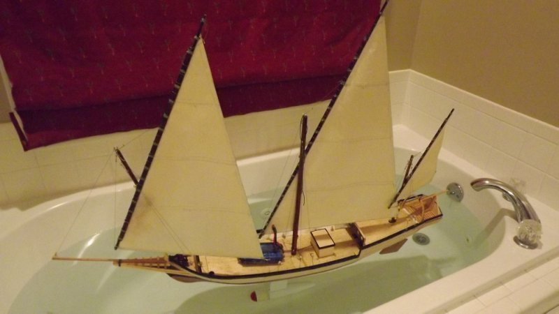

    So I fell back on tried and true balsa sheeting prepeared with a few sheets of silkspan and attached to the ship with standard Weldbond. After getting the sheeting on, keel bulb mocked up and in place, and a few other much needed tasks, the ship was finally floated and weighed.
    Float test! Sometimes it pays to have a deep jacuzi tub. Heh.
    At the moment, the ship weighs 7 pounds, 8 ounces and floats 1/4" light from the target waterline. I'm pretty confident the ship will carry 8 to 8.5 pounds of weight without any problems. My earlier guesses as to the finish weight seem to have been pretty accurate. ;)
    What does concern me though is the ship's load capacity. At 8.5 pounds, the ship will have 2 pounds of load capacity. That might be barely enough to put in the cannons, solenoids, and 3.5oz bottle w/ lightweight regulator. I may have to reduce the number of cannons from 4 to 2.
    I knew going in that this was going to be a tough build to arm. The Requin has a VERY shallow hull compared to brigs and sloops of the same size.

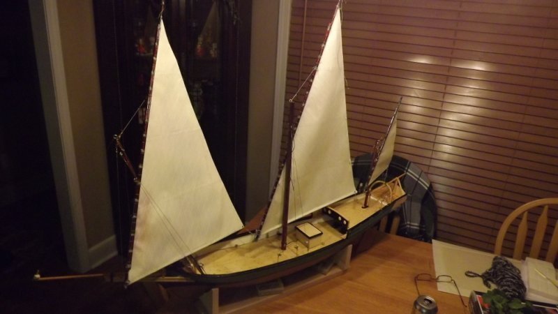

    Painted up and ready to go for maiden
    Tomorrow (Friday) is my regularly scheduled day off. The weather is supposed to be good with a light to medium breeze. Sounds like perfect sailing weather! So tomorrow will see the maiden of the Requin and another sport sailboat I recently picked up for fun.
    There will be pictures. Wish me luck!

    Welp, the Requin's maiden went so so.
    The day was sunny, around 65 degrees, with light 5 - 7 mph winds. The water was calm on my side of the pond from shore out to about 25 feet. I tried to give the Requin a push out, but the ship went out about 10', stopped, and turned into Irons ... and the rudder servo decided that was the best time to stop working. Obviously, I wasn't thrilled with the rudder servo's decision.
    After recovering the Requin and setting it to the side, I brought out and launched a ready-to-sail ship called the Nirvana. It handled the light winds very well and I sailed it all over our end of the pond for the next hour and a half.
    After beaching the Nirvana, I looked over the Requin and noticed the rudder servo was working again. I removed the mizzen sail since it was interfering with the main sail and launched the Requin again with a firmer push. This time ... the rudder servo quit again. Bleah. But without the mizzen sail I actually had some control of the ship by individually setting the main and fore sails. The ship drifted broadside to the wind about 15' from shore while I played with the sails.
    Suddenly, a wind puff came along and off went the Requin! It only took two clicks of sail offset (front sail out and main sail in) and the Requin was carving along perfectly balanced! Since the rudder wasn't working, I tried sheeting out the fore sail to try to get the ship to turn into the wind. Nothing really happened other than the ship barely started turning windward. The ship was quickly running out of pond and heading towards some shoreline moss. I sheeted the foresail in tight which forced the Requin into a leeward turn towards the shore I was on where it quickly grounded on the keel.
    After recovering the Requin, I noticed a couple problems. Apparently, I sheeted in the foresail tight enough to yank the clew grommet completely out of the sail. Other problems that need to be fixed include trimming the main sail so it will clear the mizzen mast and mizzen sail, moving the foresail sheet guide further forward on the deck to clear the bottom of the mainsail yard, and readjust the servo endpoints to prevent sheeting in the lines too tight. Oh, not to mention installing a new rudder servo. Also, the Requin was running a little bow heavy and could use some more weight in the stern.
    Overall, the ship showed promise. It moved pretty good once it got air and seems to be pretty close to balanced. I'd like to see how it works after I fix all the problems from the maiden sail. :)
