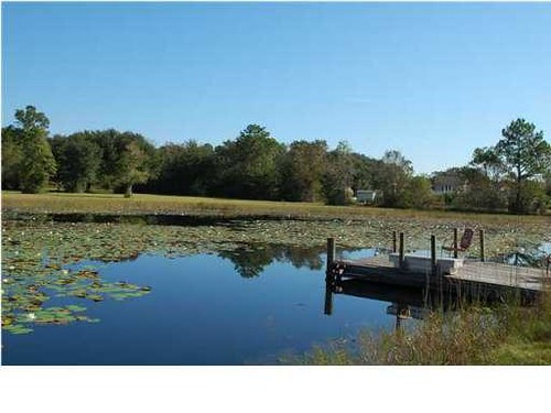

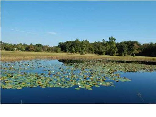

    Hey Ian, how are the winds at the pond? It looks nice and open, with nary a tree nearby to muss things up. Usually that results in relatively constant wind speed and direction, perfect for square-riggers. Most ponds have too many big tall trees, and that makes the wind too inconstant for sail-powered combat. Who knows, in a couple years you may end up hosting the first AOS nats :D
    PS: if you need Big gunners to battle with, Gascan and I are in King's Bay, and we'd love to play with you. There are a few other Big Gunners scattered around the area, plus enough big gun ships between Gascan and I to fight a fleet battle on our own.

    To the right in those pictures is the property line. Its got a MED number of shorter tress that might mess things up for you. From what I remember in flight school ( one of the OLFs I worked is a mile down the road) we get a decent number of days the wind would move from left/right in those pictures.... so you'd have a pretty steady wind.

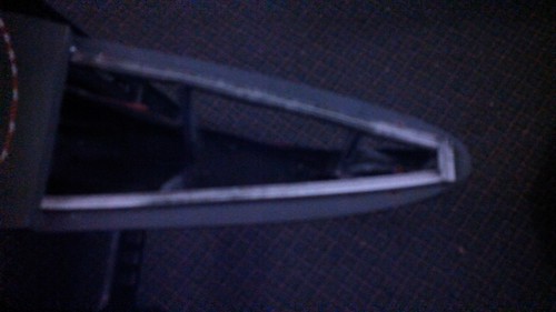

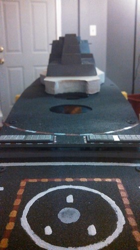

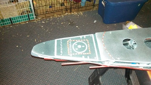

    Working backend forward as far as the topside detail goes.... two shots of the flight deck, one of the storm window gasket I am using to seal the weather decks. I used #6 course screws with washers glued to the main deck to tie in Tee-Nuts that are laid into the cap rail. I'll try to cover them up with some deck clutter at some point.
    The flight deck markings are a mix of a CG like the one I cruised on, and what I think would be required to operate both H-60s and a B model JSF. The Red/Yellow square is an airacraft elevator ala a Kirov vice having hangers at deck level. ( Wouldn't jive with the hull lines) I will be stopping by the local hobby shop after work to see what I can find in the way of railing and somthing I can use for Mk 57 PVLS cells. Up close she looks a little splotchy, but back up 2-3 feet and its kinda scary. You can also see the aft main battery foul arcs.

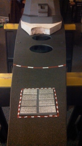

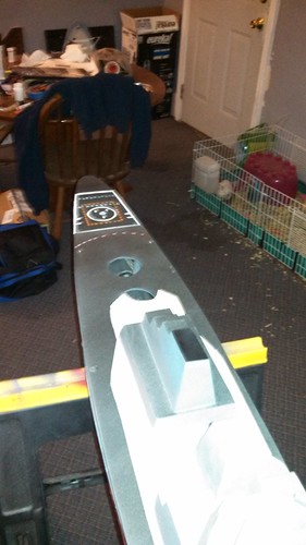

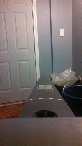

    Forward foul arc and 64 Cell VLS
    Aft foul arc and 32 Cell VLS
    Looking down from the Bridge over the bow
    Slowly but certainly... she's comming together. The lower SS will be replaced, likely this weekend. I just am not happy how it came out.
