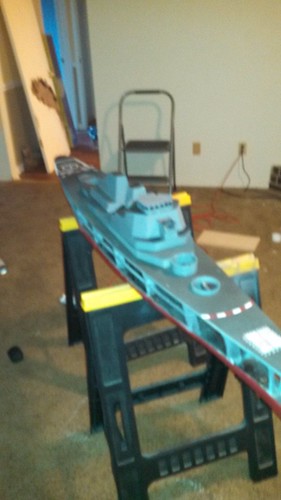

    Turret rings are in, O2 level of the SS was redone and painted. Working now on the little things like CIWS, SLQ-32, NULKA racks and the likes.

    Looking nice. Like the Super and the markings look great. Always could make templates for later on for touch up so you just have to lay it over and not have to have to steady of a hand. Also an airbrush would make that easy also, but I think it looks awesome.
  3. Beaver
    You work fast, much faster than me! :) Lexy looks really nice with the SS.

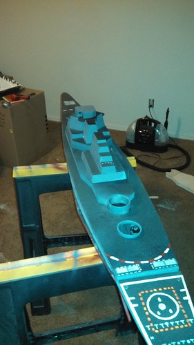

    ^&%$&%$&%^!!!!!! Main Mast
    Slowly coming along. Nothing is glued down yet so I can still get at the Bridge and decking to detail. 2 weeks off from work so I should make decent headway. I am trying to find beads and stuff at the local Hobby Lobby that will stand in for emitter domes and liferafts. SRBOC decks are done. Redid those vents to look less clunky. Mount 20-1 is ready to go to work. (The ultimate Spurt Gun?) And the SLQ-32s are in.

    SS is looking GOOD. :)

    Yes it is. Very impressive.
  14. Beaver
    Looks very real! When are you planning on getting internals?

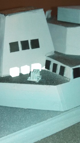

    SPG-62, Devil Horns, bridge wings, Comm/Radar domes, and SPY arrays are in.

    The front SS looks awesome, but I'm not sure about all the steps on the back of the aft SS. Maybe it'll grow on me when detail is added.

    Tug, the upper step is for the aft GTM exhuasts, the next two are platforms for SPG-62s, and the furthest aft is for Mount 20-2. All of those are pretty simple. So hopefully I will be able to finish all that today after I get back from the barn.
