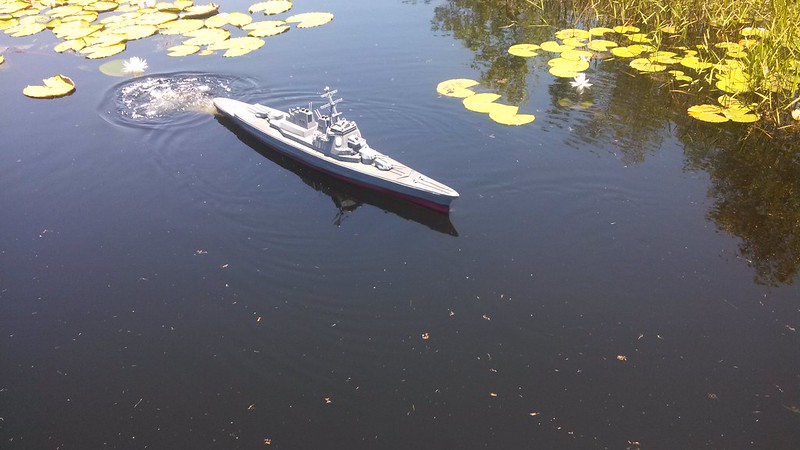

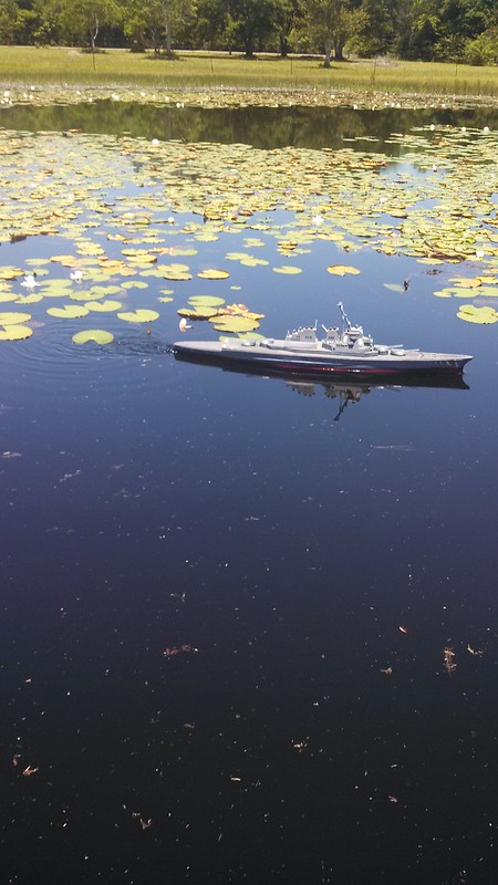

    Well, the day finally came where a boat I built not only got wet, but moved under her own power in a controllable fashion. Only a few shots since I was driving with one hand and taking photos with the other. It was a $200 setup just to get her moving. The two inboards running off a 5000mA battery with a servo running the Strike 3.0 rudder I slapped on her. The custom job just wasn't holding up. Her turn radus is about the same as a real battlecruiser. I will have to get this down, the rod I was using to tie in the servo was weak as all getout and bent left and right so my throws were only 40-50% what they should have been. In any case I have a cold one open and the smoking lamp will shortly be lit!
  5. Anachronus
    Looks great.
    Ahhh first sea trial. Let the Debugging begin. Great job on the model.
