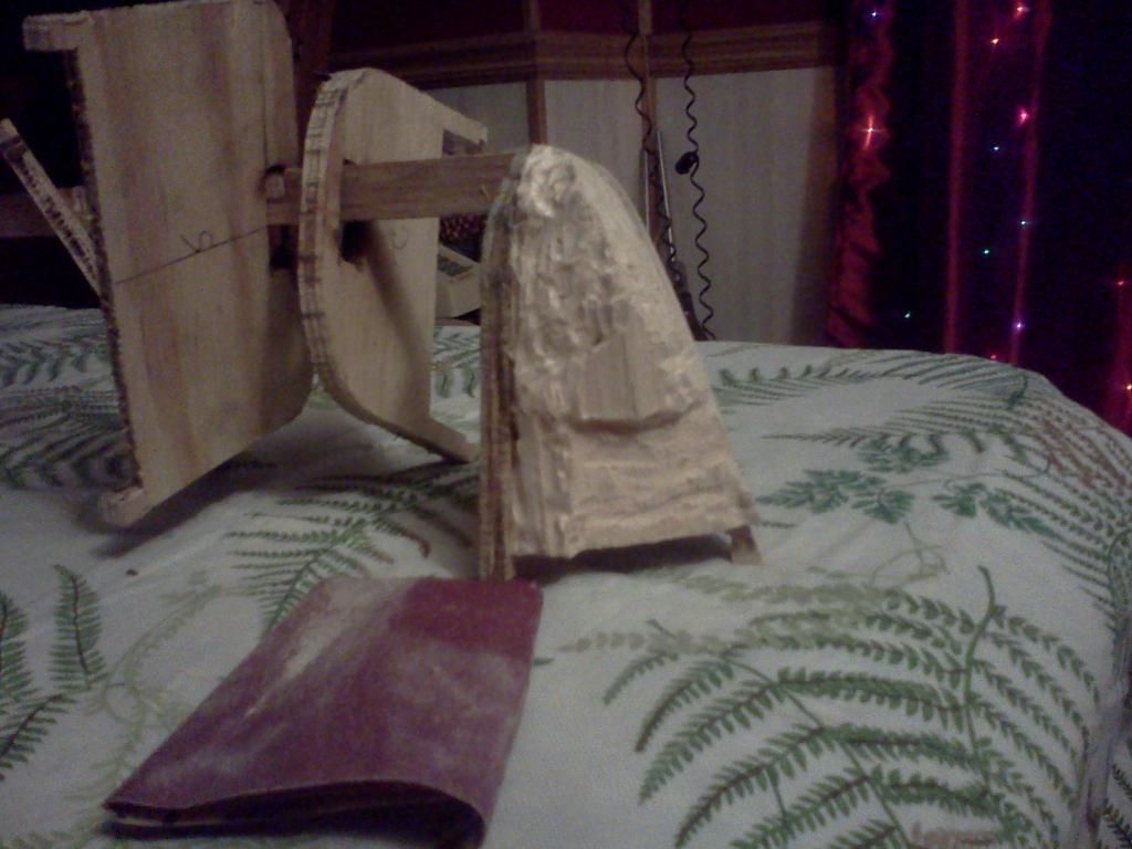

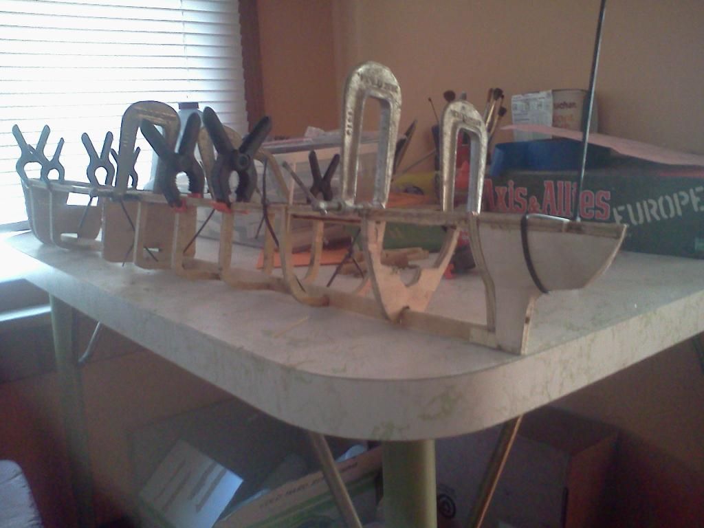

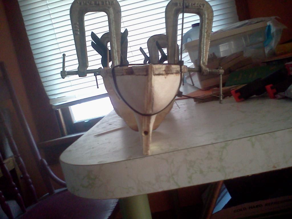

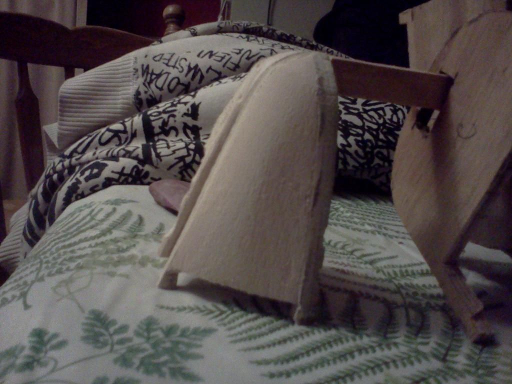

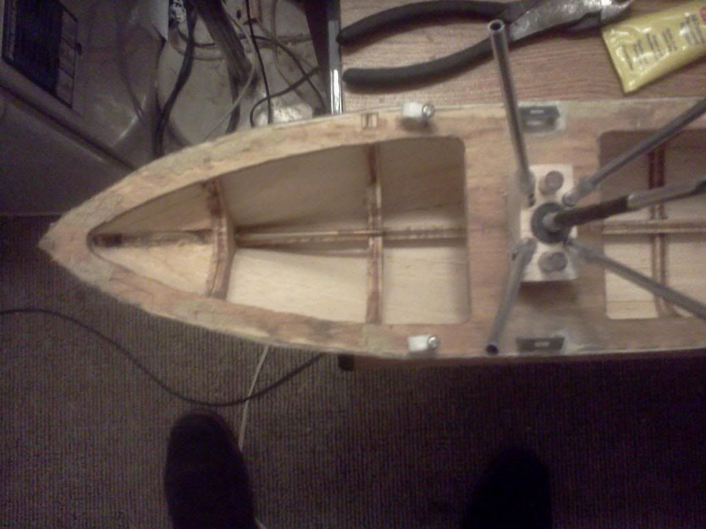

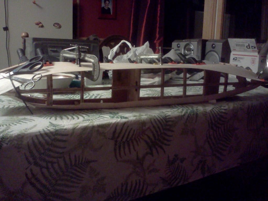

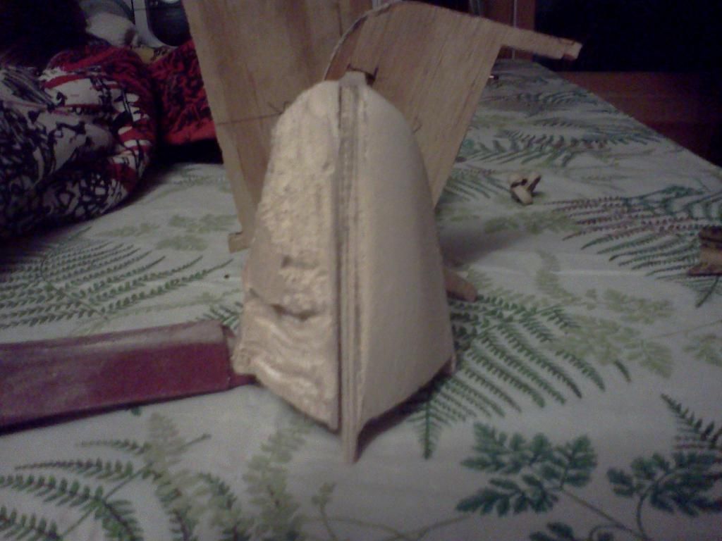

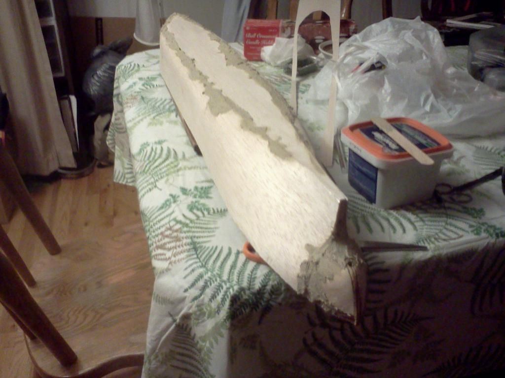

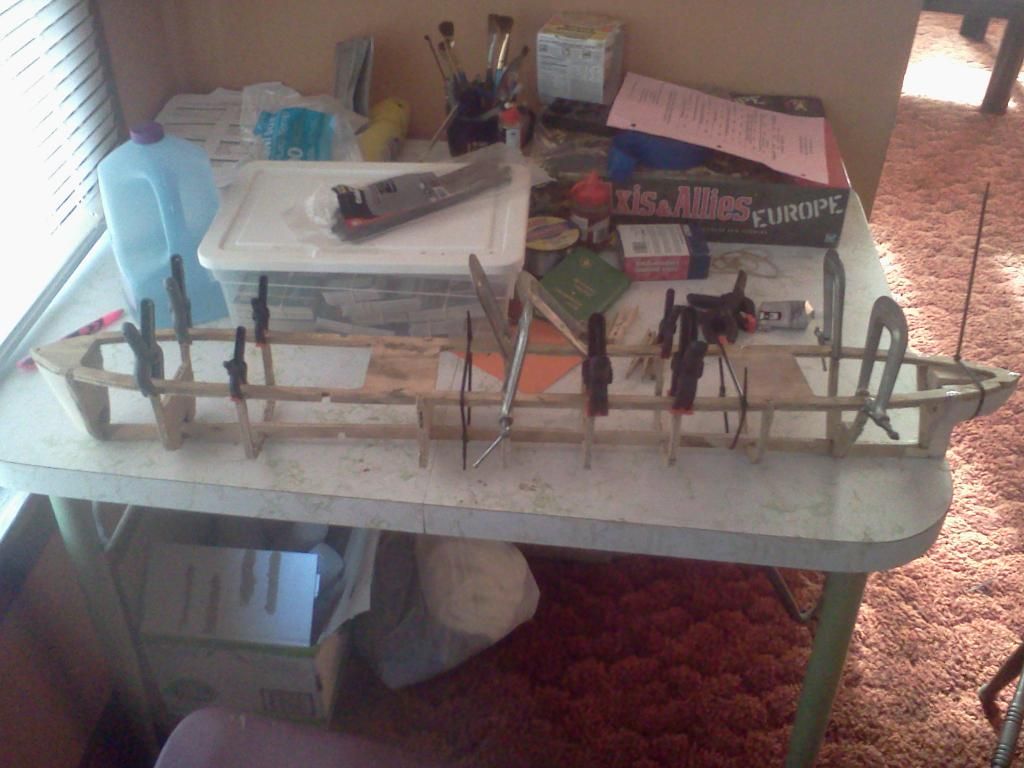

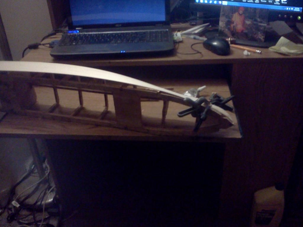

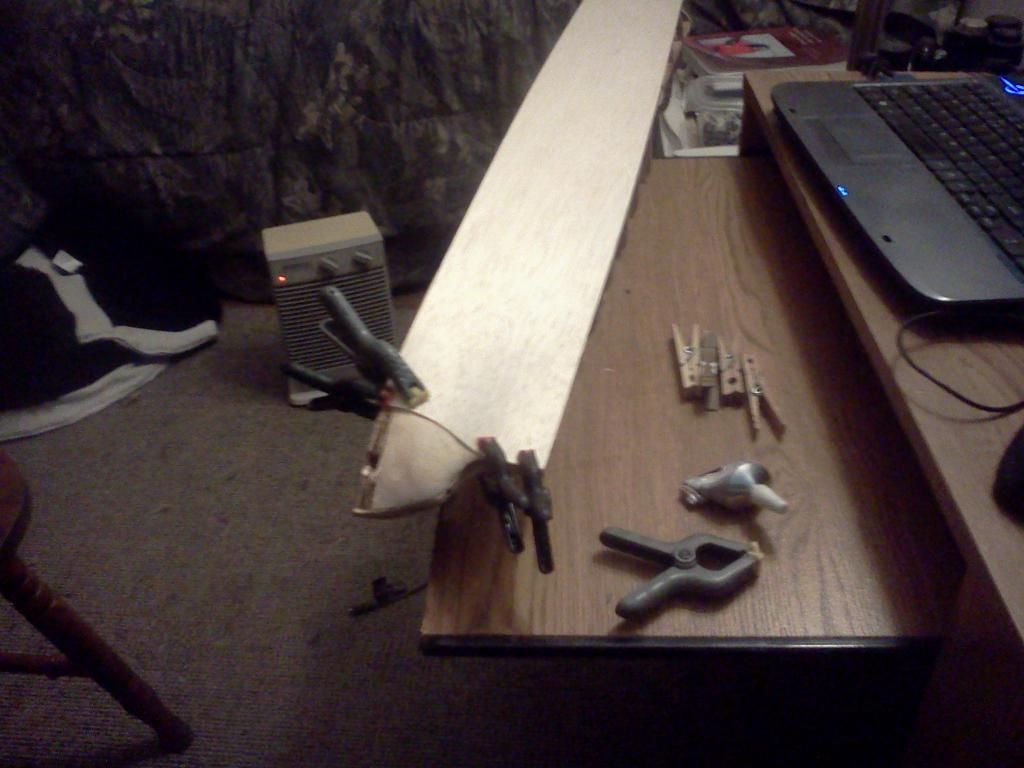

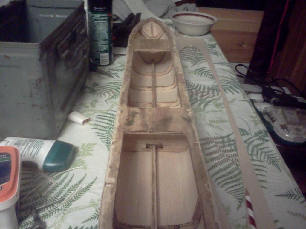

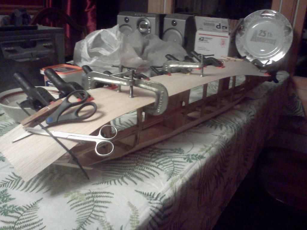

    So i did a little work to the Liberty Ship (keep in mind that this is my first scratch build and i have no clue what im doing im just winging it)
    so heres some pictures
    I know im missing a rib i couldnt find it and i didnt have the tools or wood to make another considering im 4 hours away from home in college

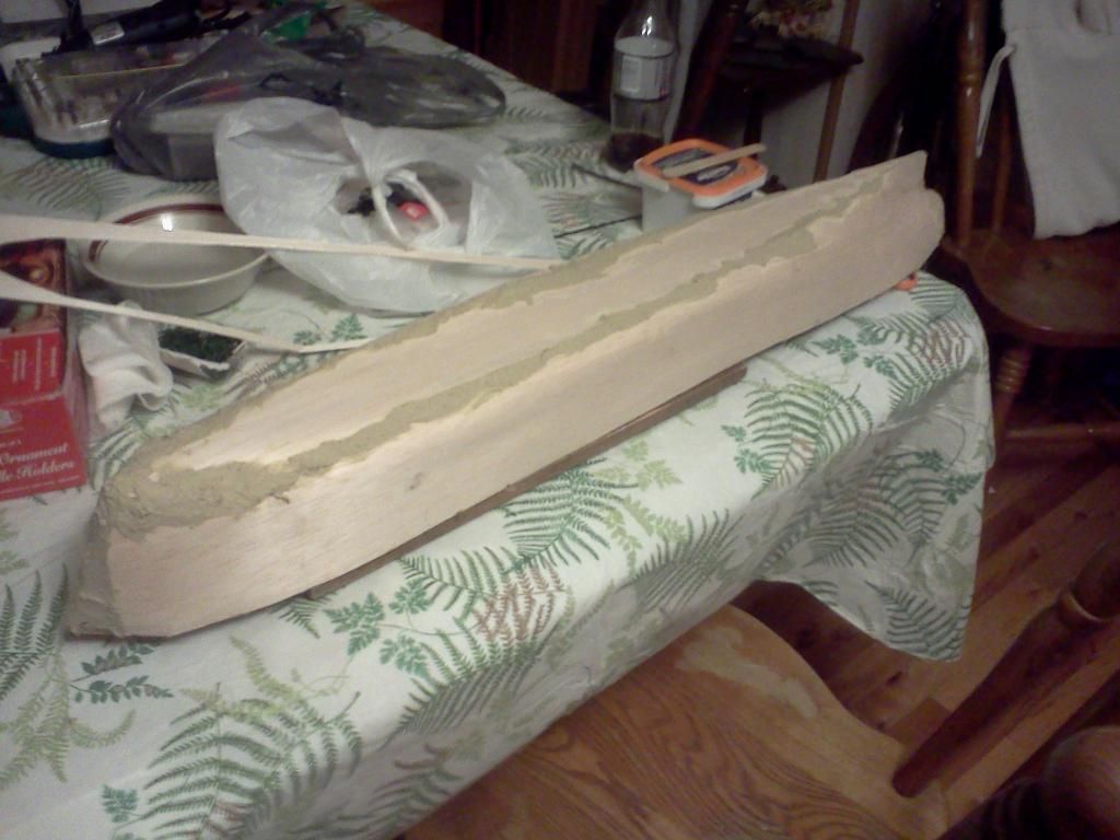

    Now im going to fiberglass the whole thing just to cut out any imperfections and also to make the hull stronger. and if i want to use it in a battle ill cut windows into it and sheet it up.

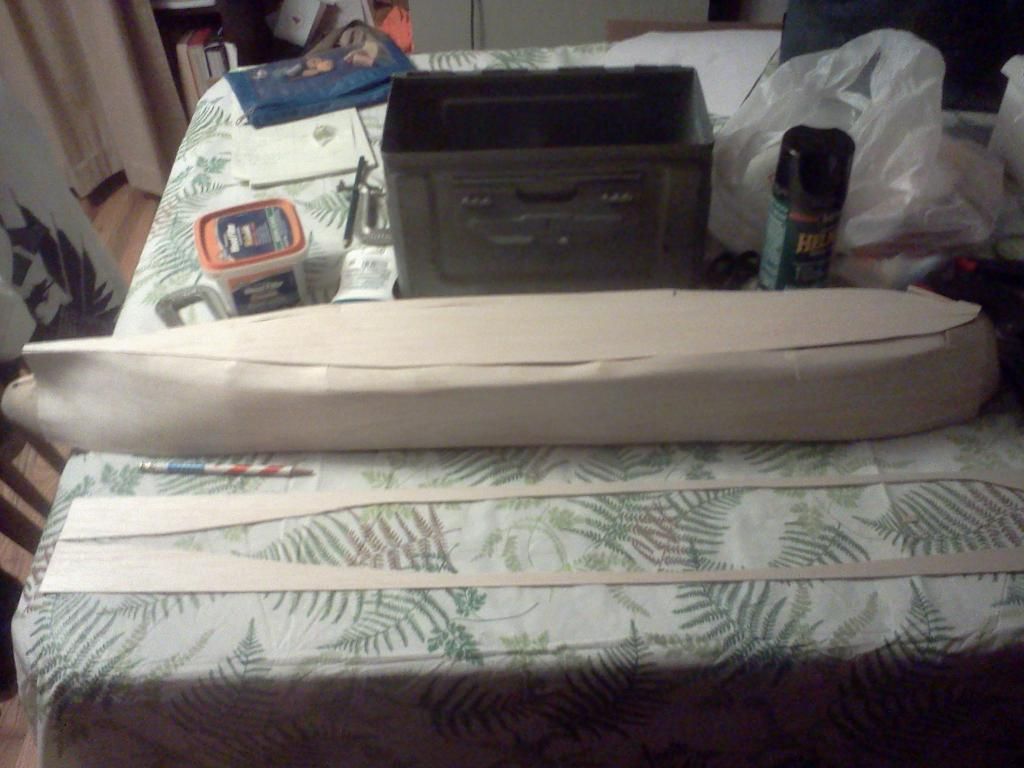

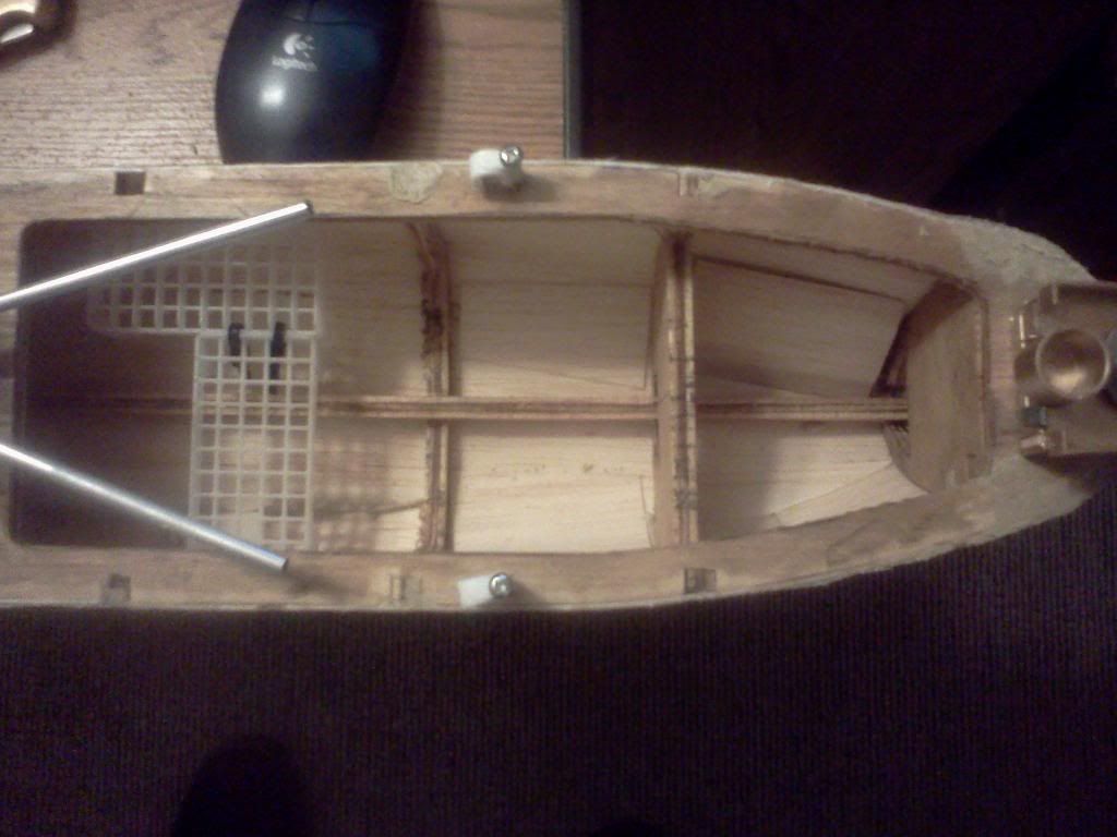

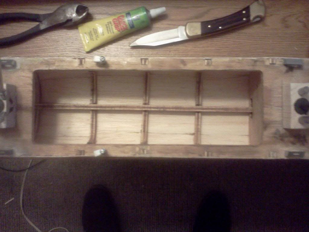

    The ship has now been fiber glassed and the stuffing tube is now in, currently waiting on motor, motor mount, and rudder.
    Looking good :) Good work on shaping the hard areas, too. Very sweet.

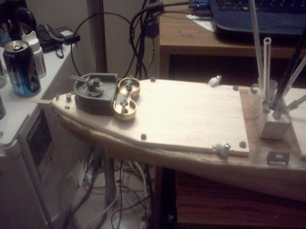

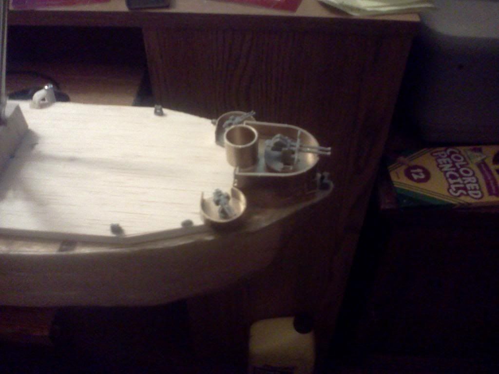

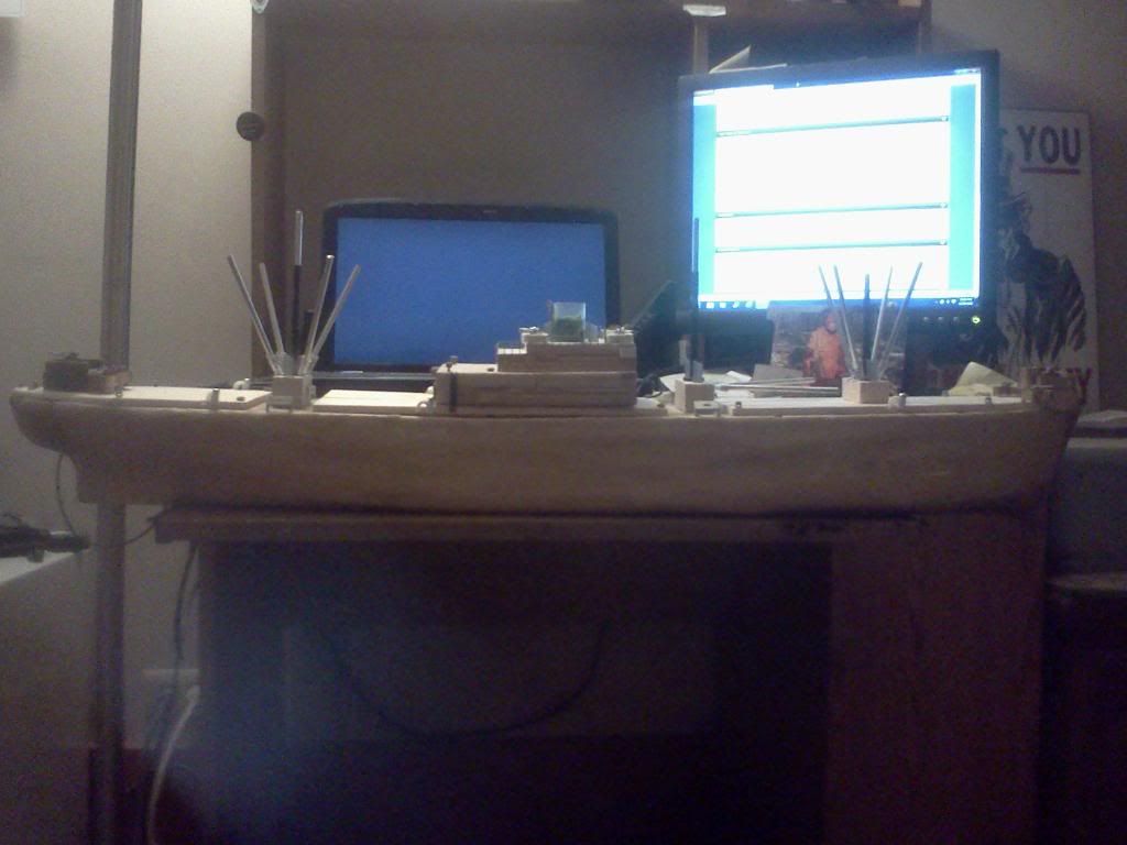

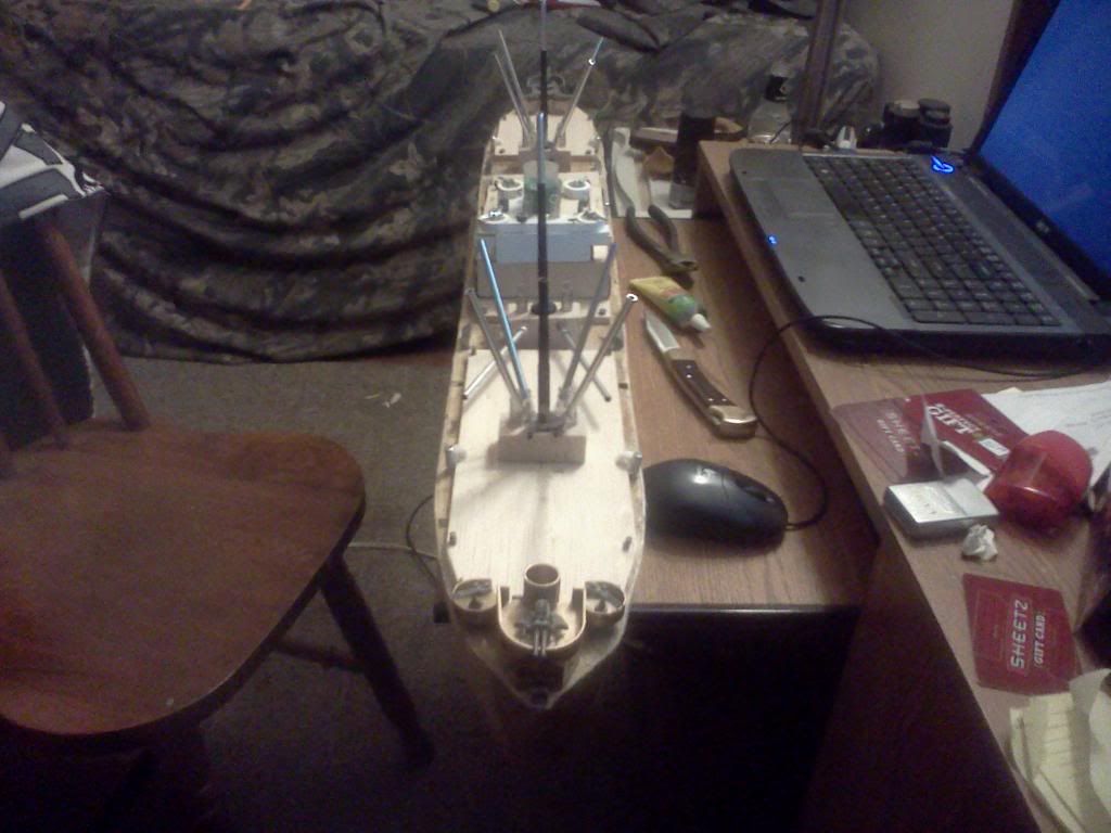

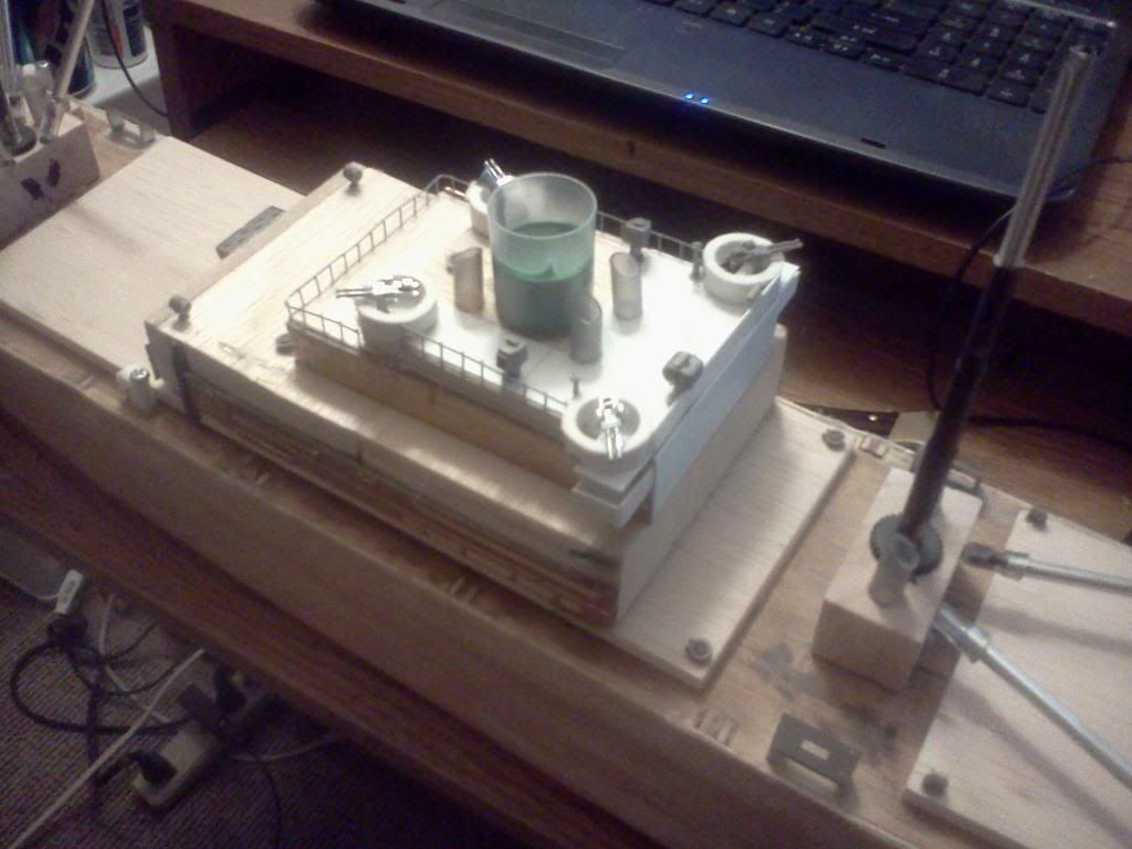

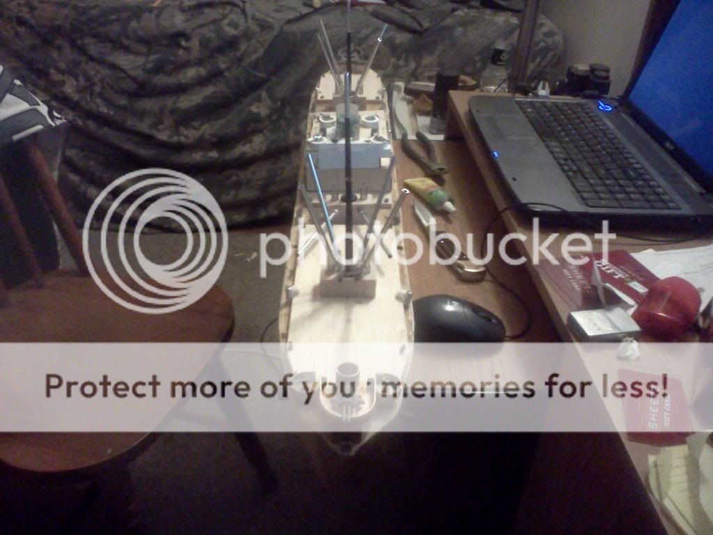

    well i got some more work done on the liberty. i started painting it and jeez everything shows on it haha need to double coat everything maybe tripple coat. heres some pictures
    Looking REALLY nice. Very cool with the armament on it. Makes me want to finish my convoys, too!

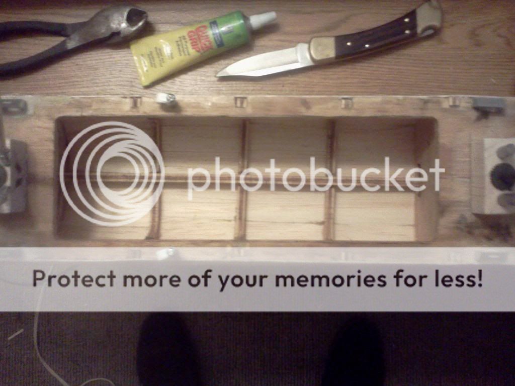

    its not exactly to scale but i got it the best i could without spending 10$ for a chunk of balsa which id only use 1/3 of it.
    now i need some recommendations for a cheap system. i was looking at hobby king products but kinda scared how good they will be due to how cheap it is also it was like $21 for shipping. this would be greatly appreciated for a good cheap system. thank you guys so much
