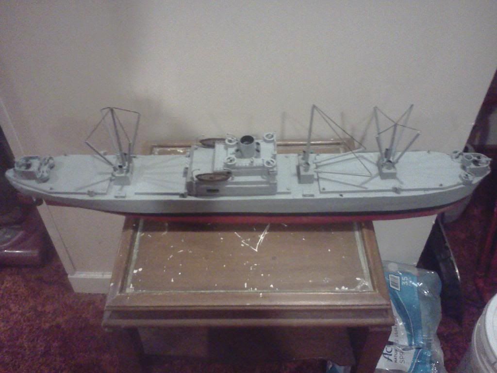

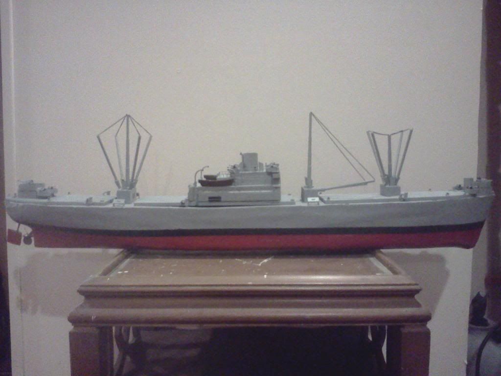

    so here is the finished product pretty much, just need to make a float and put the electronics in.
    tell me what you guys think for my first scratch build.

    41
    As Borat would say "Verrry Nice".
  3. tgdavies
    tgdavies Active Member
    Jan 7, 2012
    130
    Looks nice! I'll be more than happy if I get my Golo looking as good.

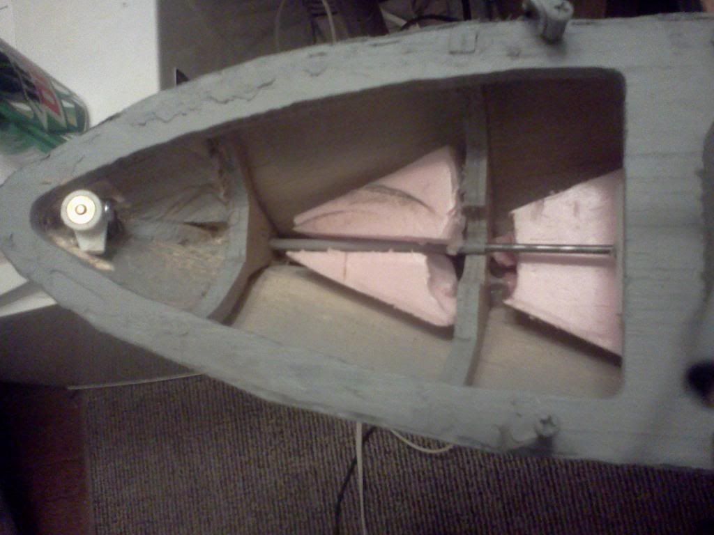

    Ok so i ran into a slight problem. It floats with no battery in it, but then i put one of my Bismarck batteries in it and it just want to topple over. So the problem lies on what batter to get that wont capsize the liberty. If its to small im afraid it wont have a long run time. So what size battery is good? and were do i get it? all help is much appreciated. Thanks

    even witht he superstructure off it was tipping im just thinking its the batter because it can float no problem with no batter and the superstructure on
